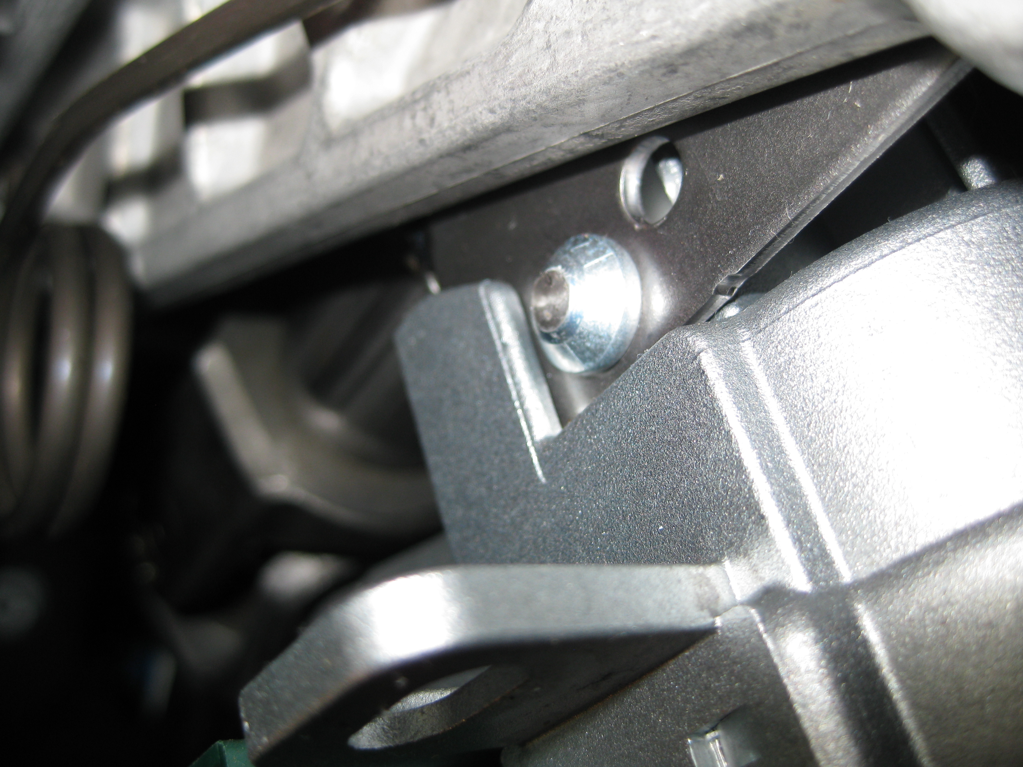

Have a dead steering column module, stuck in the UNLOCKED POSITION. Was going to try to replace it. Removed both upper and lower steering column cowl pieces, but how to remove the two fasteners on each side of the unit? Thanks
How to remove this fastener??

You have to drill them out I believe. You then purchase two new ones from Volvo (easiest route). Some of these column lock modules require a software download to activate them. Pretty sure this is one of them. It is a 63 dollar download.

Thanks Mike. Wow not a lot of room for a drill, let alone a drill bit. Not interested in removing the column if I can help it.

OK I was able to remove the shear screws on each side of the module with a combination of light tapping with a screw set (in a counterclockwise direction) and drilling small holes in order to give the tip of the set 'purchase'. It was a bear but I exercised some patience and tapped lightly and often. Now to order a new module from eeuroparts, along with new shear screws and a a new upper cowl since I mangled it when removing. Then a trip to my local indie to download the software.
