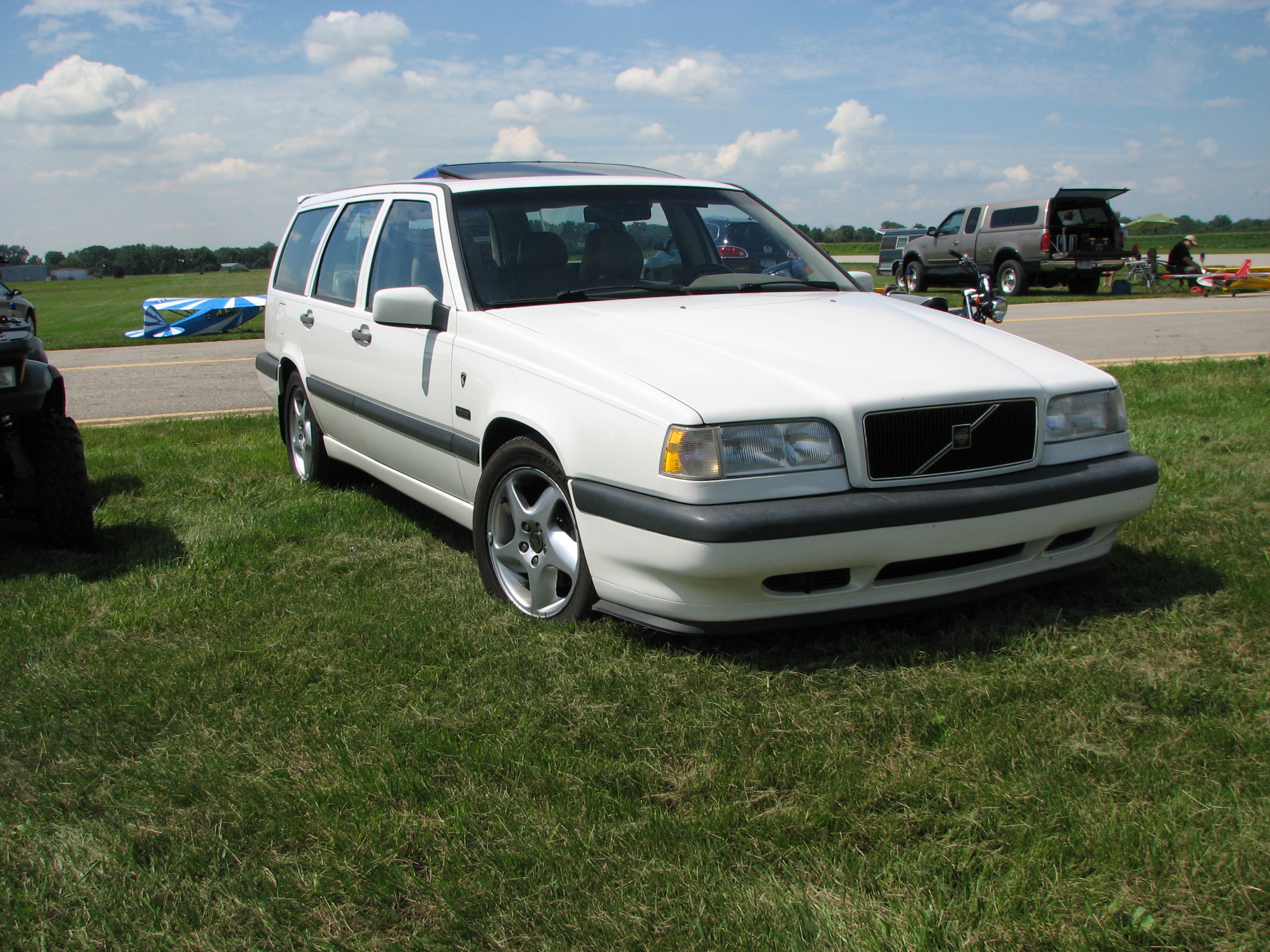

I am a bit biased on this one.
https://www.matthewsvolvosite.com/forums ... 35&t=56550
I cannot wait to get on to the warm weather updates.
A nice day at the airport.
