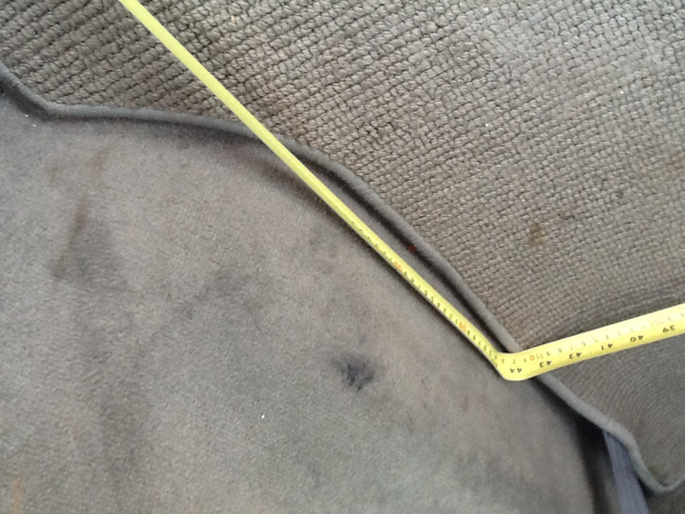

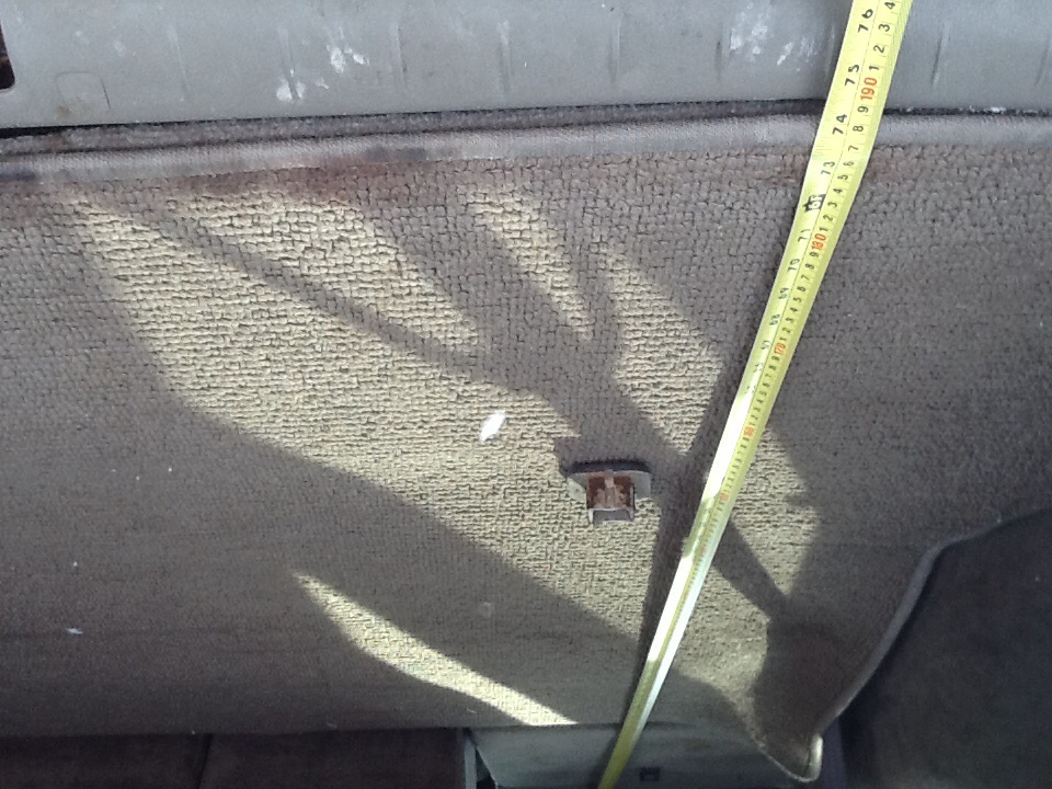

benrk
Posts: 159
Joined: 07 Oct 2012, 15:31
Year and Model: '01 V70 XC
Location: Winnipeg, MB
Post by benrk »
Just measured my '01 XC, short loading length is with seat cushion tilted up, 2nd is with seat cushion removed, I'm 1.87m & drivers seat is almost all the way back.
