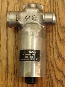

Here is a picture of the IAC valve, with the two hoses that abscate is talking about, the hoses to check for tears are the ones whose ends are circled:
Clean out the IAC, this is something you can do yourself for the price of a can of carburetor cleaner (about $5) and a few hose clamps. The IAC is held in place by a rubber strap and the connections to the hoses. Spray cleaner into the IAC, shake it around until you hear the internal mechanism rotating freely, dump out the cleaner onto a rag or paper towels. Repeat until the cleaner runs out clean. Use eye protection.
If the IAC has hose clamps that look like this then you will want to replace them with screw type, these clamps are one use only:
Here is an IAC that is fully removed and ready to be cleaned:

Turns out what I needed was a new air mass meter and my idle motor serviced. The air mass meter wasn't throwing a code, so the guys went back to what they know about 850s -- but not before eliminating other possible culprits. Sure enough, the air mass meter was toast (or toasty on the way to being toast). My idle motor was filthy and needed a good clean and servicing.
