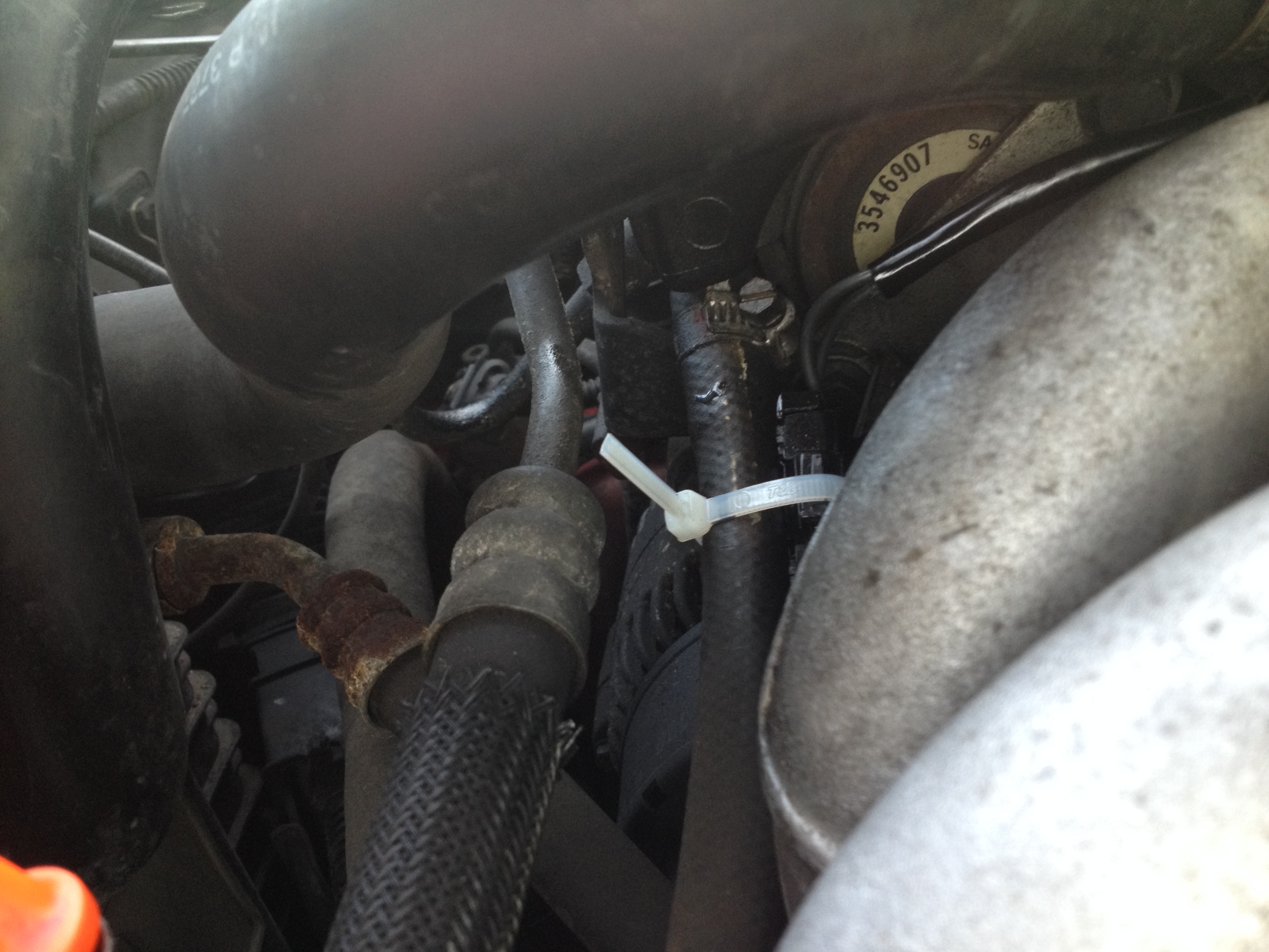

I could not see any vacuum hoses under the PS pump. Here is a pic. The zip tie is for the ECT, the previous owner broke the tab on the wiring harness.

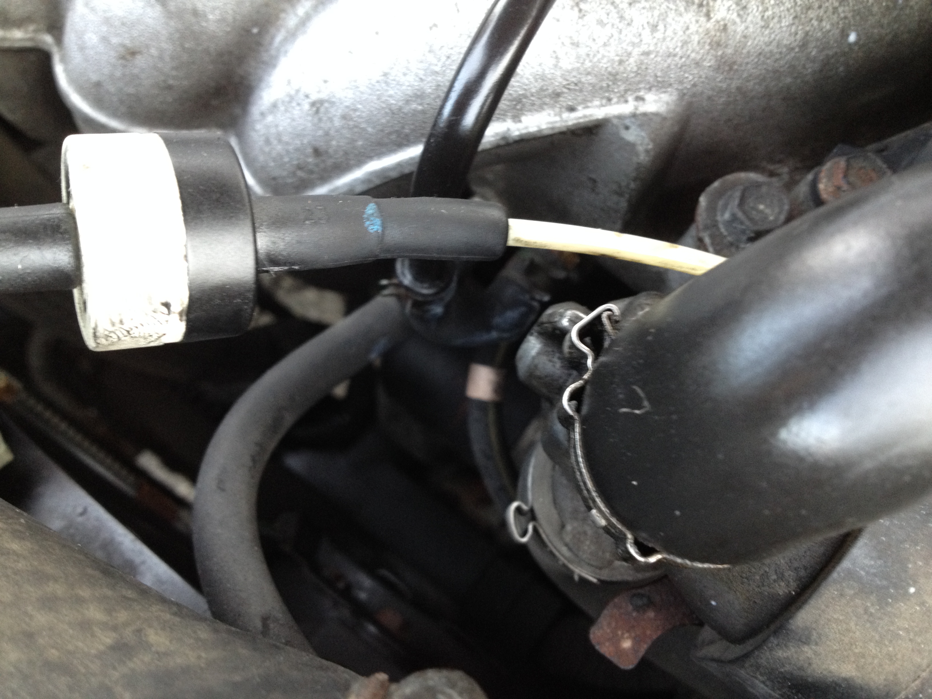

I took a picture of two hoses that go into the intake that are rotted, they are adjacent to the throttle body which I cleaned.

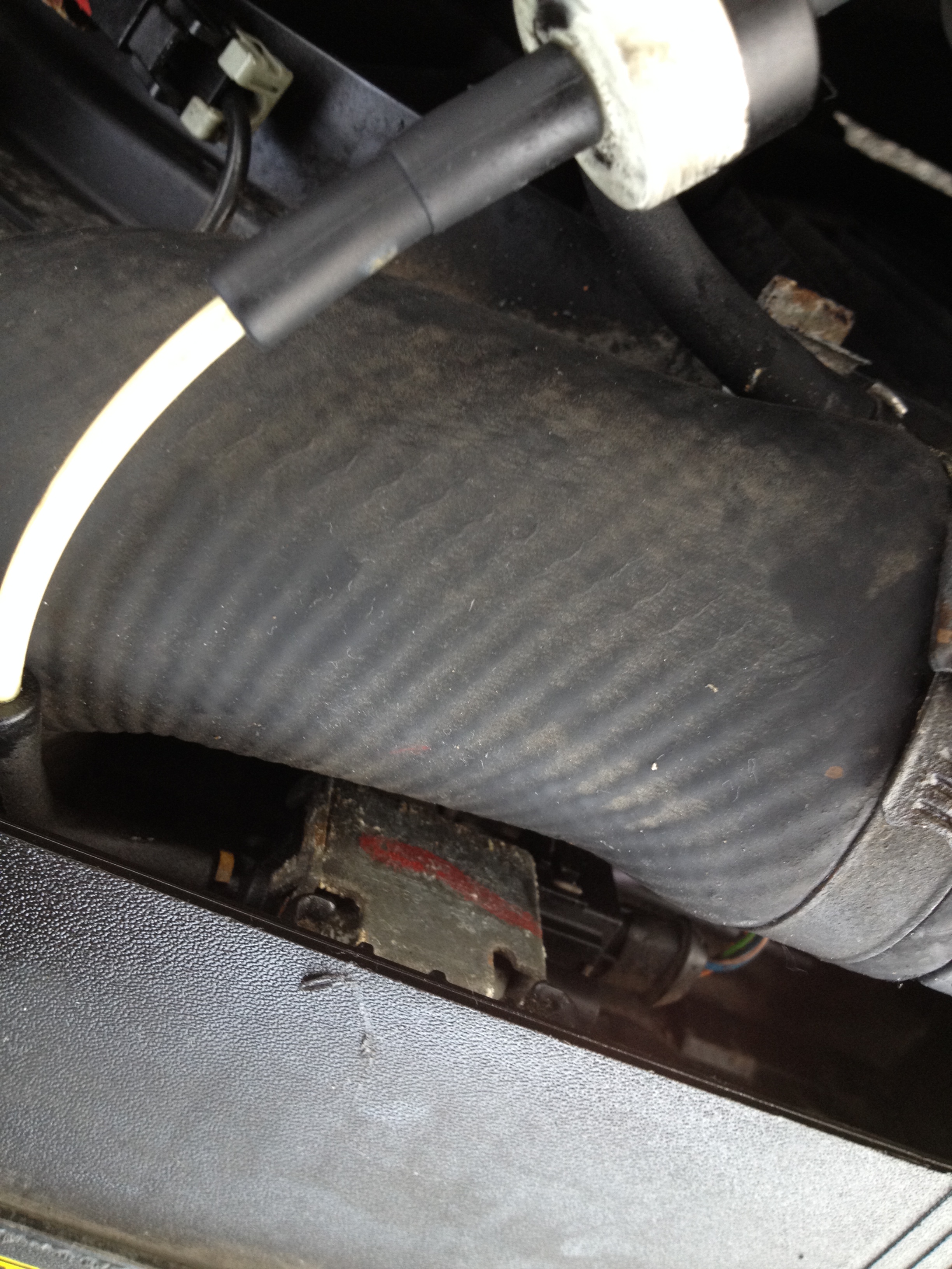

What is this vacuum hose and the thing it connects to under the radiator shroud?

The line behind the PS pump is more like between the thermostat housing and the intake manifold. It hooks onto a nipple on the end of the manifold. This picture shows it well, with the manifold tilted up out of the car:
The black and white thing is a check valve. I don't know where that hard plastic line goes to offhand, you may have to trace it. It is fine to replace that hard line with a rubber or silicone line. The rotting line should be replaced too.
