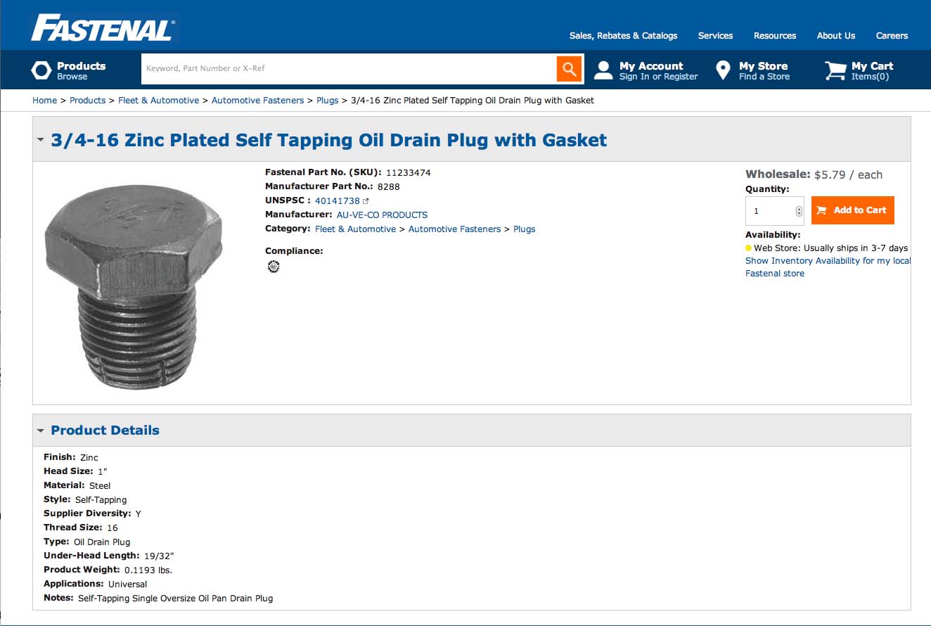

I have a 1989 245 that may have a problem with the treads on the pan drain. While removing and replacing the oil drain plug during the last oil change the plug felt a bit strange. Having owned the car for 22 years (and personally changing the oil very regularly with only 6 or so trips to the jiffy lube) I suspect that the treads in the oil pan drain hole might be stripped ( I hesitate to blame it on the oil change guys…) There is no sign of leakage but I don't feel comfortable with how it feels when tightening.
Has anyone used a 3/4-16 Zinc Plated Self Tapping Oil Drain Plug with Gasket available on line? See attached image. Apparently this plug is slightly larger and will tap new treads into the pan and should be used as the drain plug afterwards.

I found a replacement self tapping 3/4"- 16 drain plug on-line from Fastenal. I tried to install it but could not align it properly. I installed a temporary Dorman rubber expandable 3/4" plug and took it to a trusted mechanic who installed the new self tapping plug plug with no leaks and no problems. Other mechanics said that I needed a replacement pan and re-tapping the treads was not possible.
