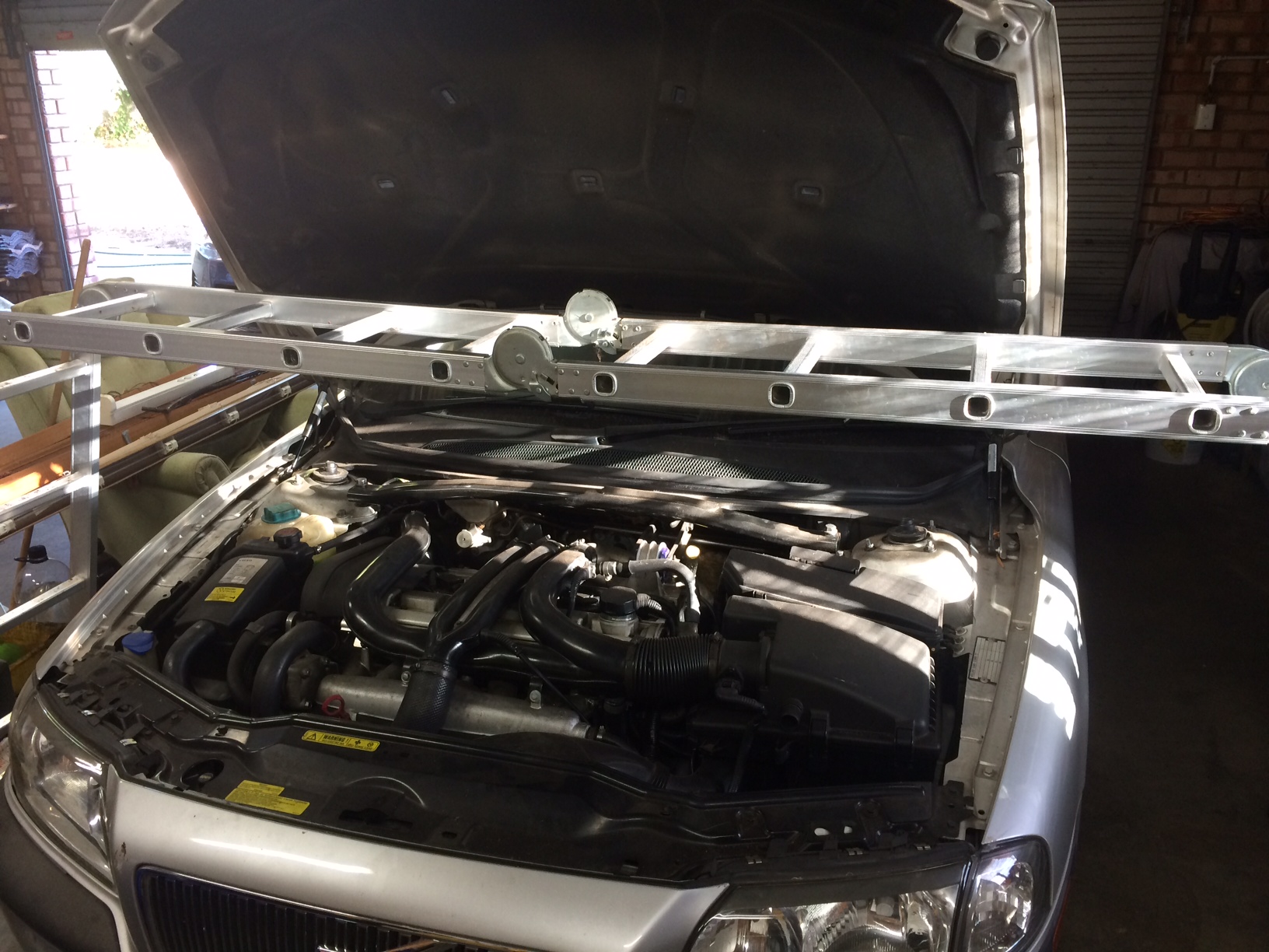

Are there any gotchas to getting the subframe out? I'm looking at supporting the engine gearbox from above, pretty much as shown in VADIS. I may use a ladder that converts to a work platform that will fit across the car to support the engine/gearbox - any comments? Think I'm insane? See the pic;-) :

I wouldn't use that ladder to support the engine and transmission. With hinges in the middle like that, it is bound to fail when you put a lot of wieght on it.

Yes, reconsidering the ladder idea!
