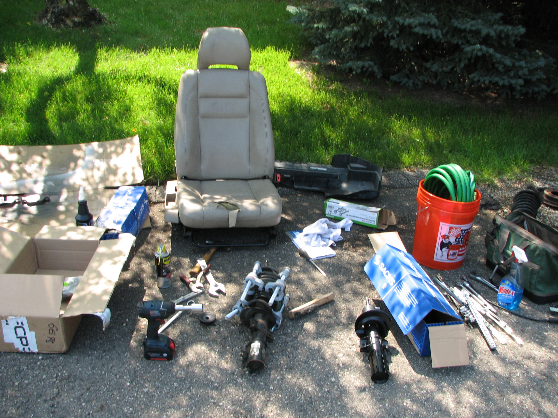

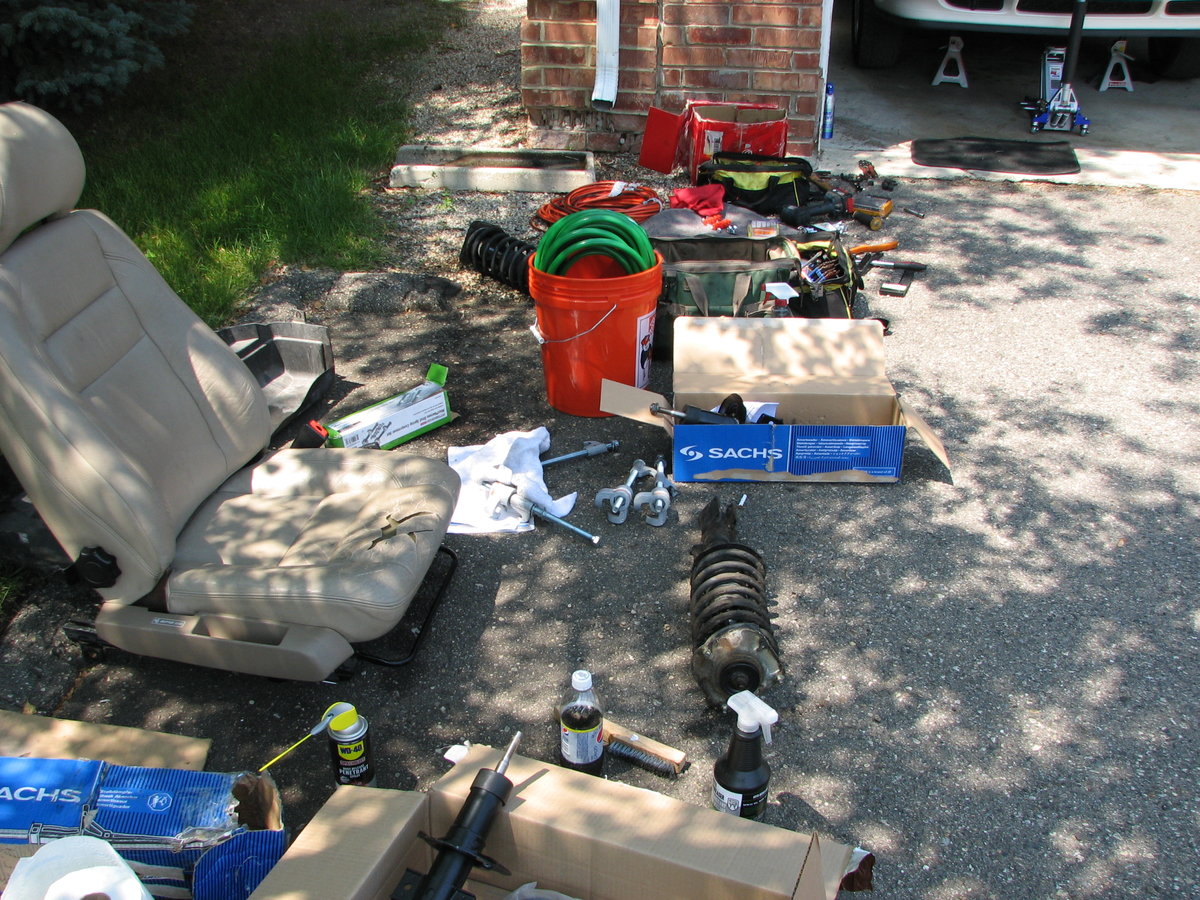

Those are the Ready mount assemblies, so the seats, mounts, bumpers, boots are all included.
It is cost effective and easy.
No special tools should be needed for those.
I had a little fun rebuilding Sachs-Boge OEM for both of mine. I dealt with spring compressors, strange nut wrenches and hammers.
It is not fun for everyone.
