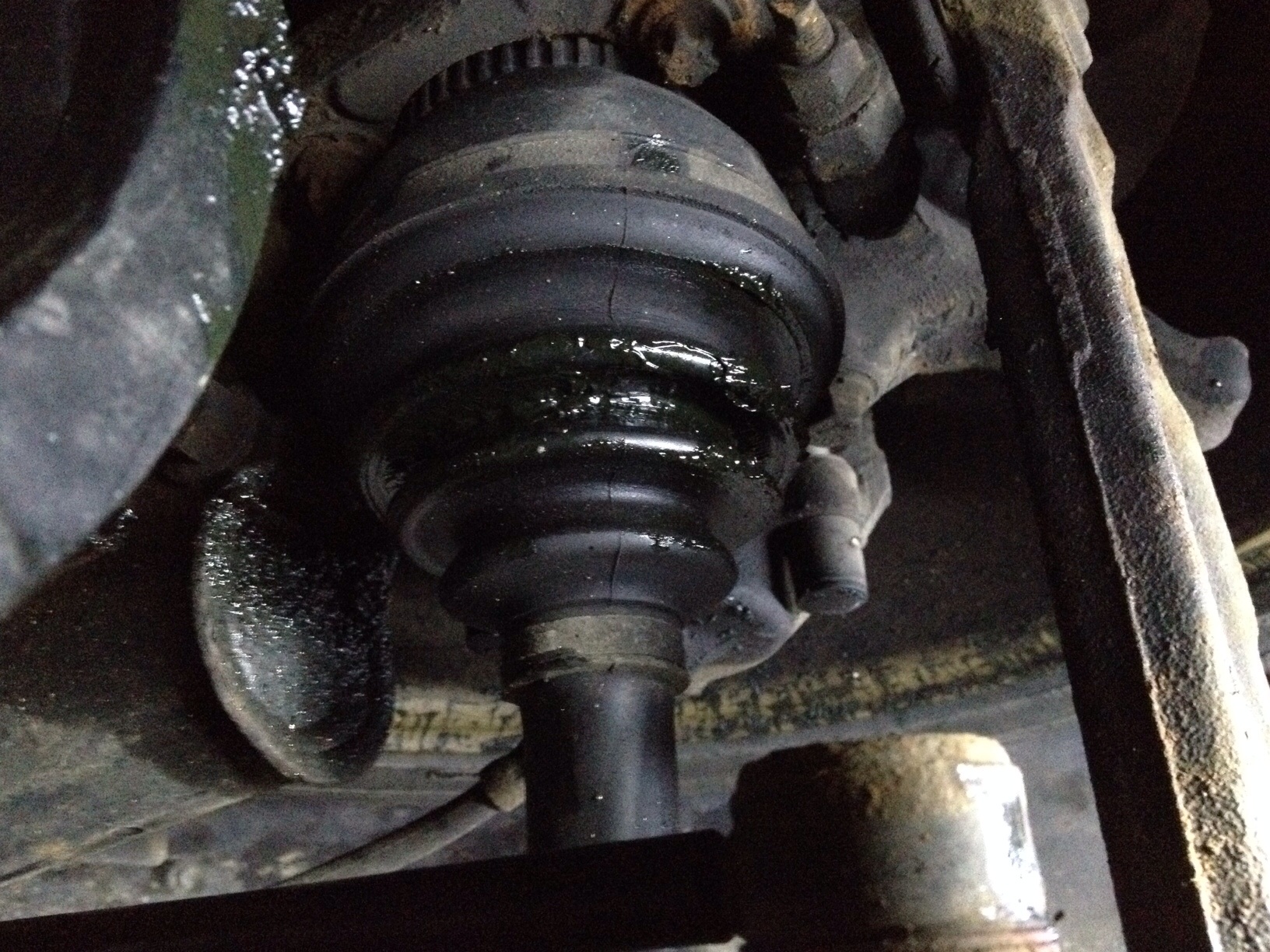

Yesterday I was backing out down an incline, wheels turned, and heard a clunk from the front passenger side, after a little research I wondered if it was the end links. Today I put the car up on ramps, and noticed grease on the inside of the front right wheel... Looks like a have a torn boot.
My question is, what do I exactly have to replace? Does the clunk I heard (haven't heard it since) mean my CV joint is shot? Does the boot just need to be replaced and greasedd up? I've handled all the repairs on this car in my year+ of ownership, but I'm not sure if this is something I want to tackle on my own. I live in the city, so I'd be doing repairs on the street. Any thoughts? Thanks!

A CV joint clack is a repetitive noise that changes with speed. Normally when you are fully turned to one lock or the other at first. A single clunk is more like an end link, a ball joint, or even a strut bearing. You just need to pry on stuff until you see what moves.
The tear on your boot doesn't look that bad and they are fairly easy to change, particularly the outer boot. The boot kit comes with a bag of grease so be sure to add it when the replacement boot goes on.

I see a crack in the outer tie rod grease seal as well. It also looks dry, so check that for play while you are in that area.
My sedan will make a nasty clunking noise if I need to reverse in a full turn lock. There is a nylon thrust stop that may be missing on your lower control arm that buffers the steering knuckle.
It is an alarming noise, but nothing is really being harmed.(too much)

Matic00 wrote:... Looks like a have a torn boot.
Yes,
Looks like a torn boot. Since you caught it early, the CV joint may be OK.
Fix this ASAP.
Rebuilt axle is a hit-and-miss business (search forum).
You best bet is to replace the rubber boot, it is cheap and effective way to fix this problem.
