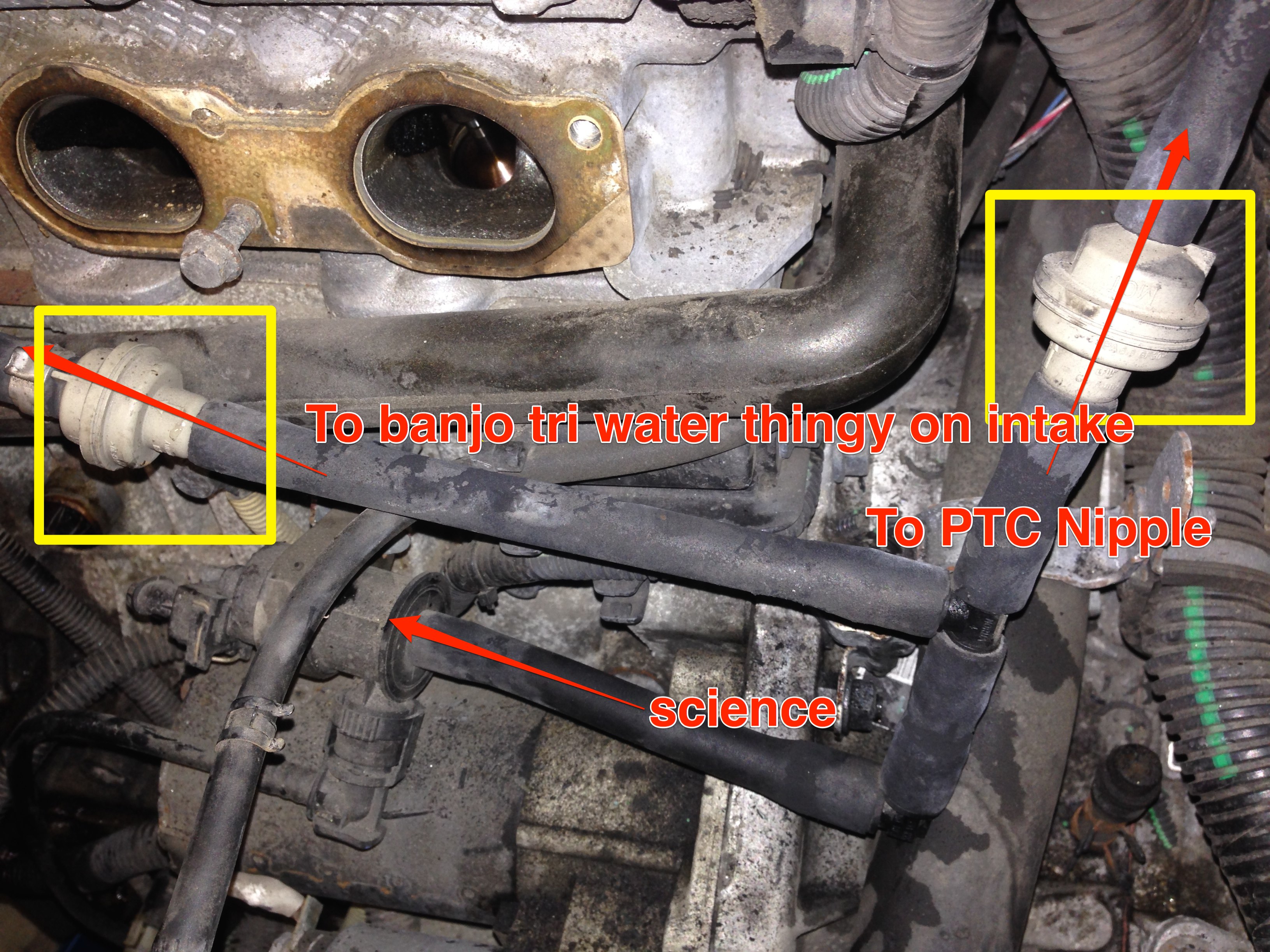

I've attached a photos of some vac line stuff I have no clue what it's for...but the hoses look like crap and the best I can tell the check valves are most likely shot. Will any check valve that fits the size from the local "auto house" work or are these magic volvo check valves? Anything else I should know about these? (valves in yellow).

What is wrong with the check valves?
I have no idea if the check valves you can buy anywhere else will have the same specs. Many check valves have a significant pressure to open them. The check valves here are to let gasoline vapors pass to intake manifold when it has vacuum and to seal when under boost and then the vapors go to inlet of turbo drawn by the pressure drop behind air cleaner which is not very much.

We tried blowing on these values and nothing passed...sees that moderate air from blowing had no input either way...so was hoping they were generic enough to just replace and be sure.
