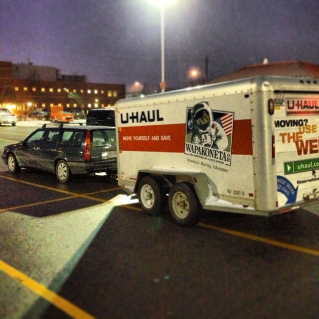

I'll just leave this here. No idea where I found this. That trailer packed with stuff likely weights more than a Miata, right?
- Posts: 14468
- Joined: 14 September 2002
- Has thanked: 2652 times
- Been thanked: 1242 times
I'm guessing that trailer weighs 1500 lbs, empty. And I thought I towed too much!
I'm surprised the U-Haul shop rented a two-axle trailer to this person.
