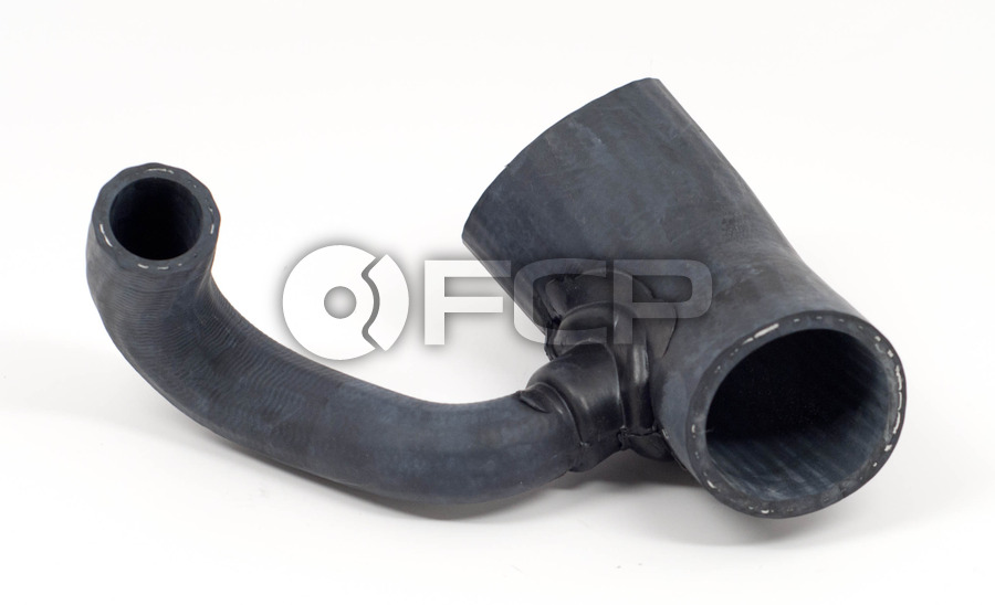

There are cracks on the hose
- this hose is broken is it problem?There are cracks on the hose
- 9161093.jpg (60.97 KiB) Viewed 644 times

Any hose or rubber connector that is cracked or broken and allowing a significant vacuum leak is a problem. With the age of your car it would be wise to inspect and replace all hoses that have failed or look suspicious.
