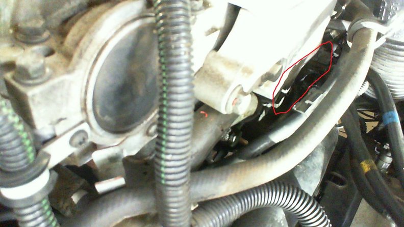

There was oil on top of the engine but I think that was from the oil filler cap since I replaced the cap rubber seal there is no more oil there. I also notice I may have the leak on the rear cam seal going by this video
so I will replace that as well.
Oil around and under this area

If two cam seals are leaking then a likely cause is a clogged PCV system. In which case fixing the PCV would be more important than fixing the cam seals. Or do them all at the same time, it may be hard to diagnose crankcase pressure with blown cam seals. Do you know when the PCV was last serviced? How many miles on the car?

There is no record of when the PCV was last serviced so I will do it since the car is 180K kms now.
