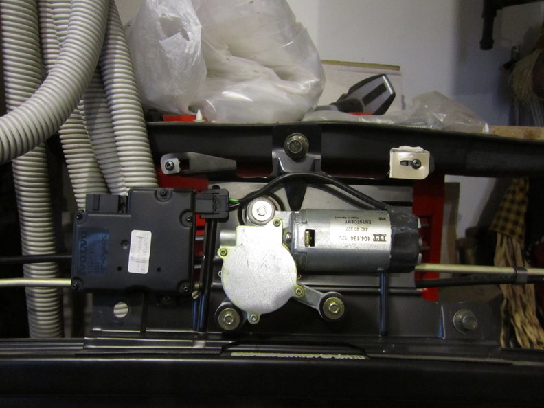

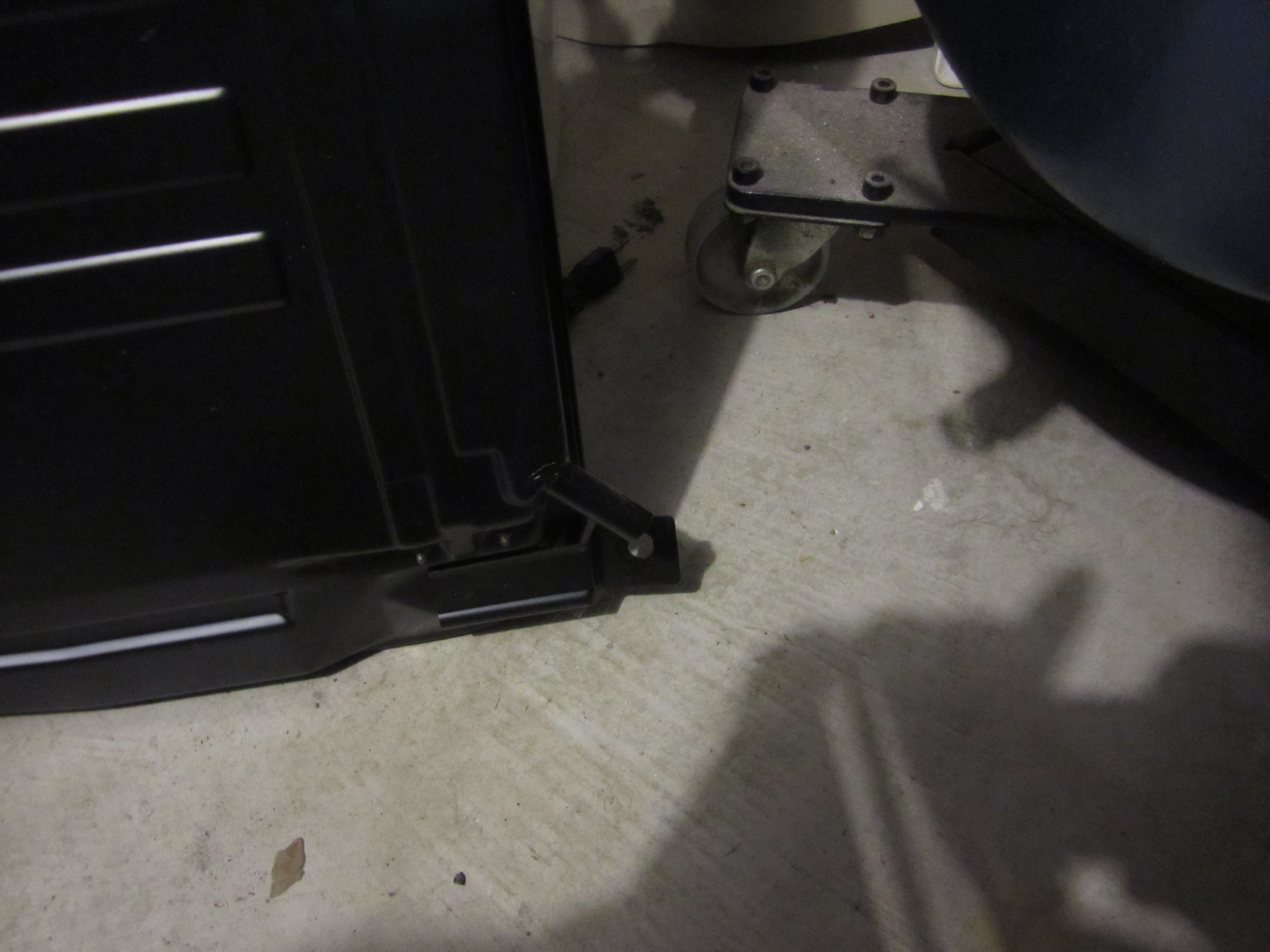

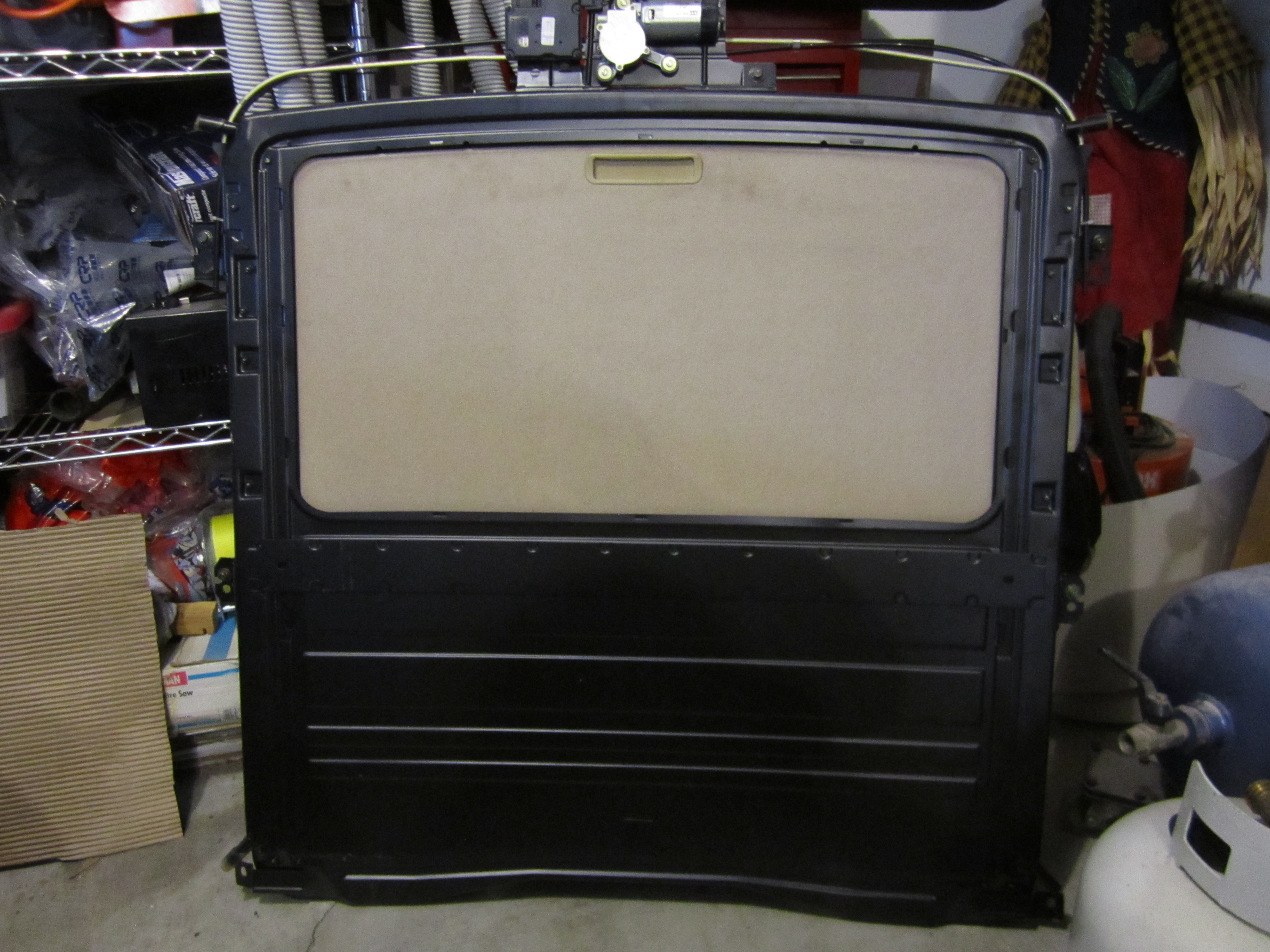

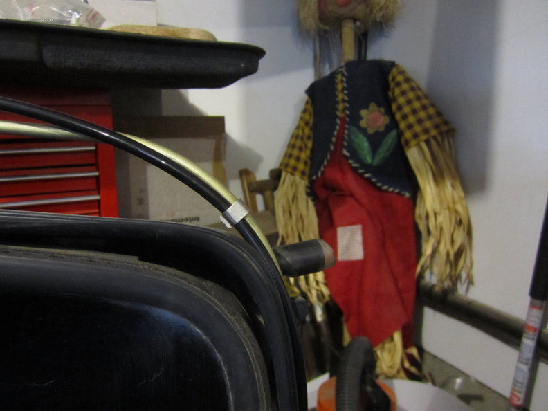

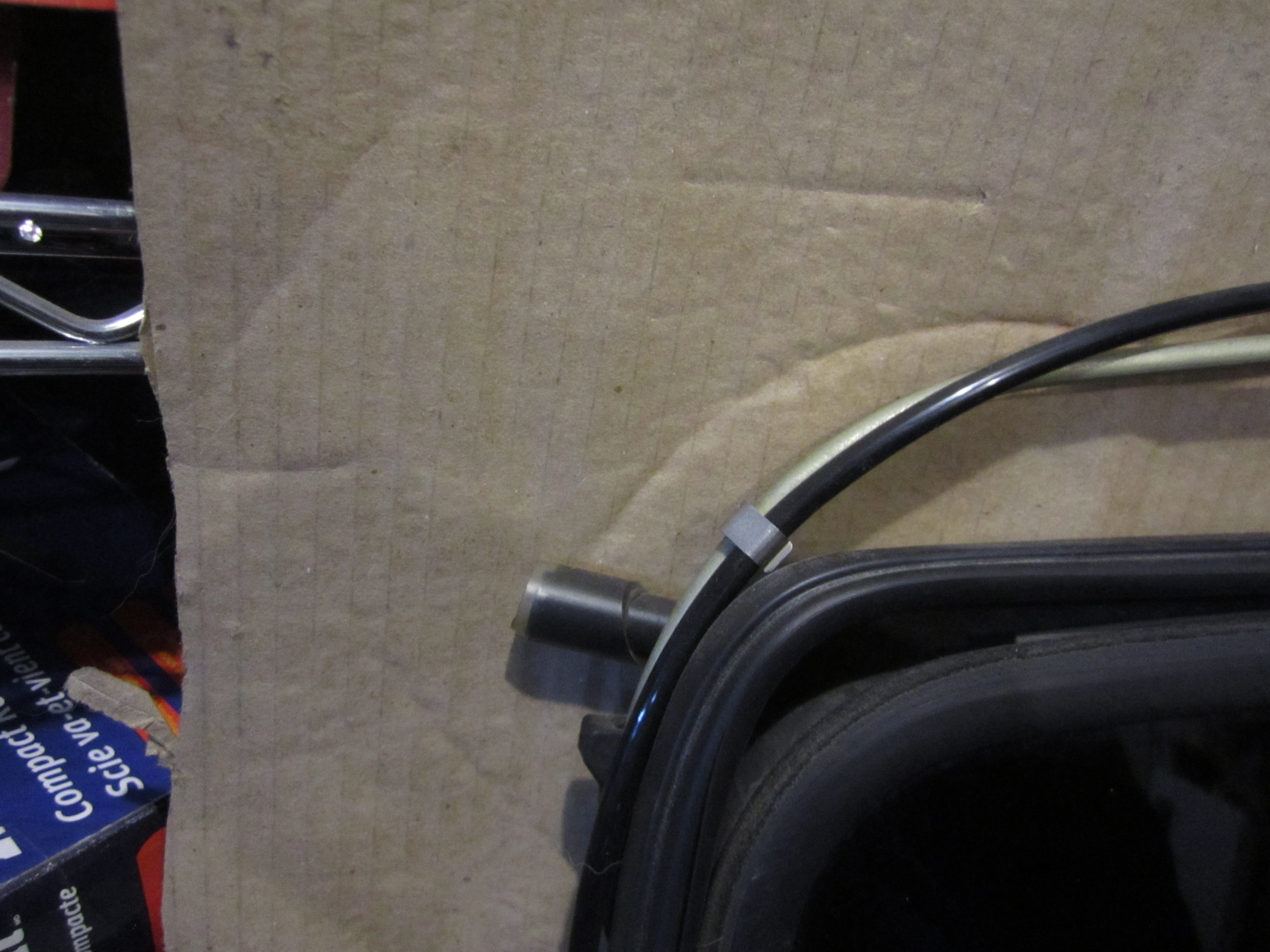

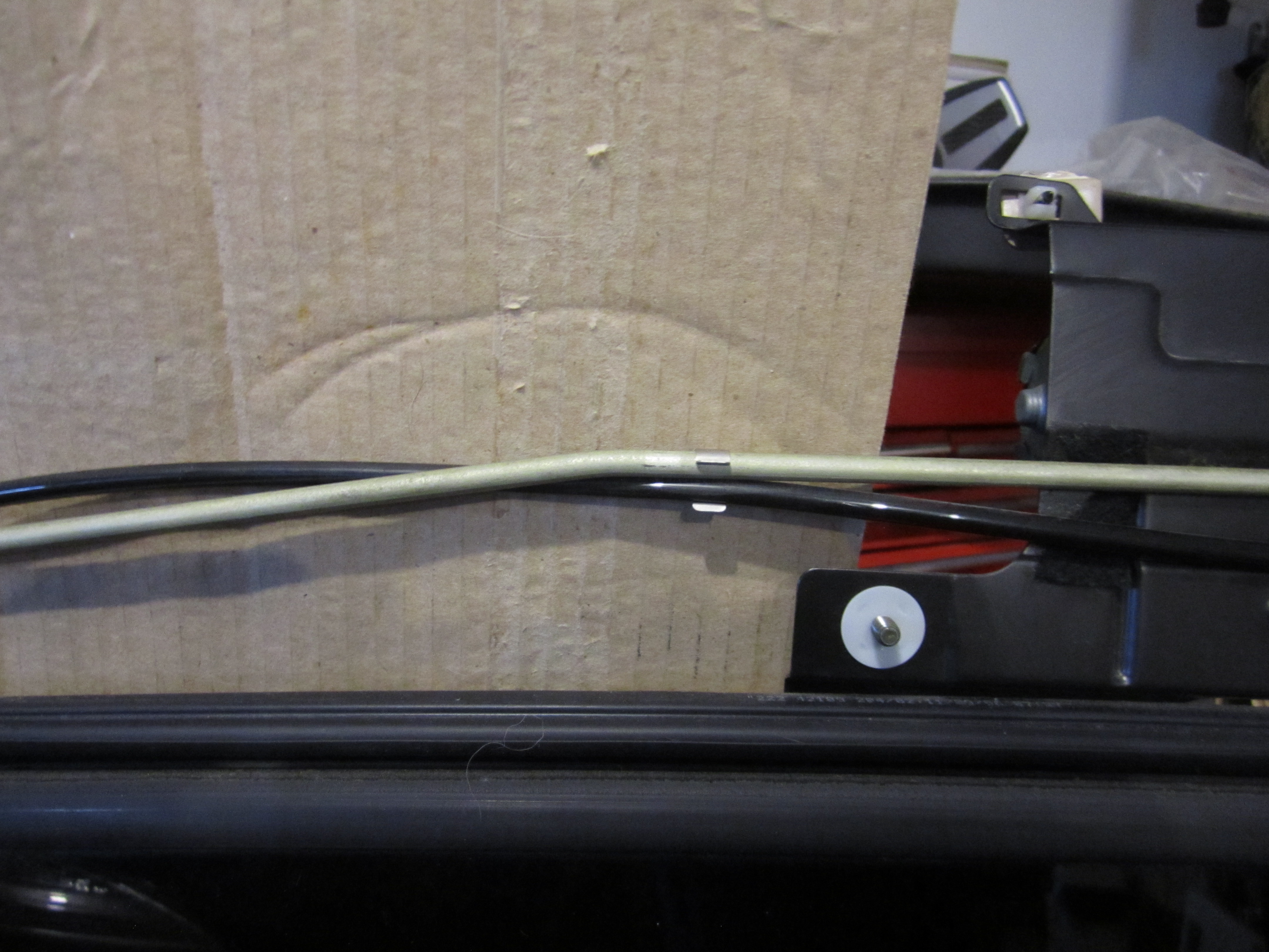

I'll post some photos, and then let me know if there is anything in particular you want more details on.
- Posts: 14864
- Joined: 5 April 2010
- Has thanked: 1836 times
- Been thanked: 1709 times
As promised abscate, I have added below a whole bunch of pictures for everyone's reference.
If you or anyone else wants more detailed pictures of anything, let me know.
A couple of notes. Up here in the north I have heard of leaks being attributed to the seal around the glass edge. This is not a 100% seal. The leaks can be caused by the 4 drains being blocked with dirt, and also the outlet drain pipes can crack/split near the outlets from the roof tray.
