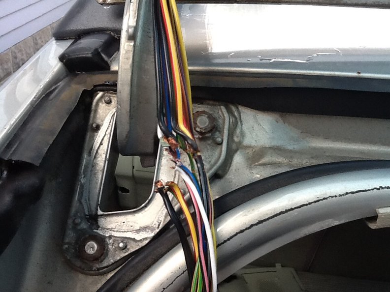

the front left marker light and the license plate light share the same fuse. You need to inspect the wires in the tailgate left hinge area. I think you will find broken wires.

Post by Ozark Lee »
That is a great picture of a common problem. It comes from slamming the trunk on a hard object that is under the hinge and it is often hidden inside of the mesh wire loom where it isn't obvious.

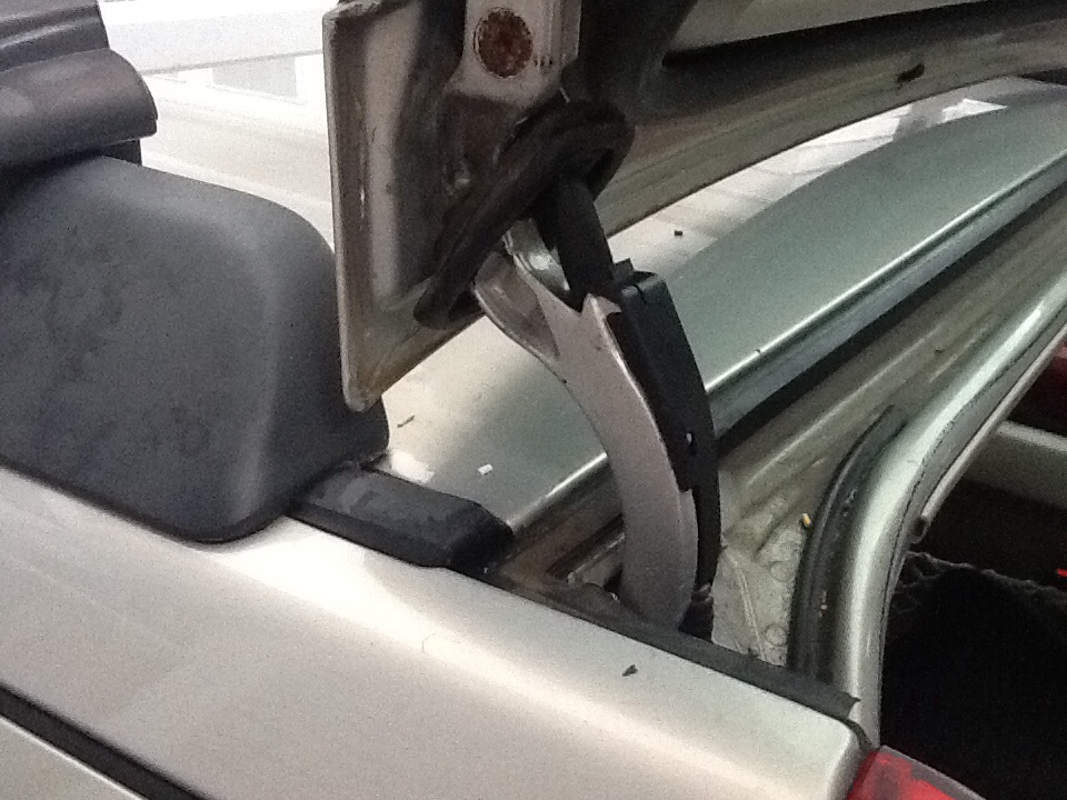

I took off the plastic protector and a small section of the wrap. the wires look perfect. is there a way to unwrap the whole thing, or look more closely? Or find the wire that is the culprit? At first look the wires don't appear to be the problem, but it seems like it might be. I'll search the site. thank you.

keep going up the wrap into the car.
Posts: 35267
Has thanked: 1497 times
Been thanked: 3810 times
You have to cut the snake skin a bit at a time and probably remove the rear trim pieces (easy) to find the break. Mine broke where the cable was zip tied to the frame as that point became the flex point. Bad design.
