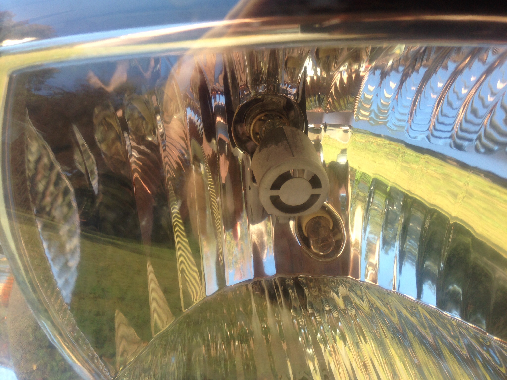

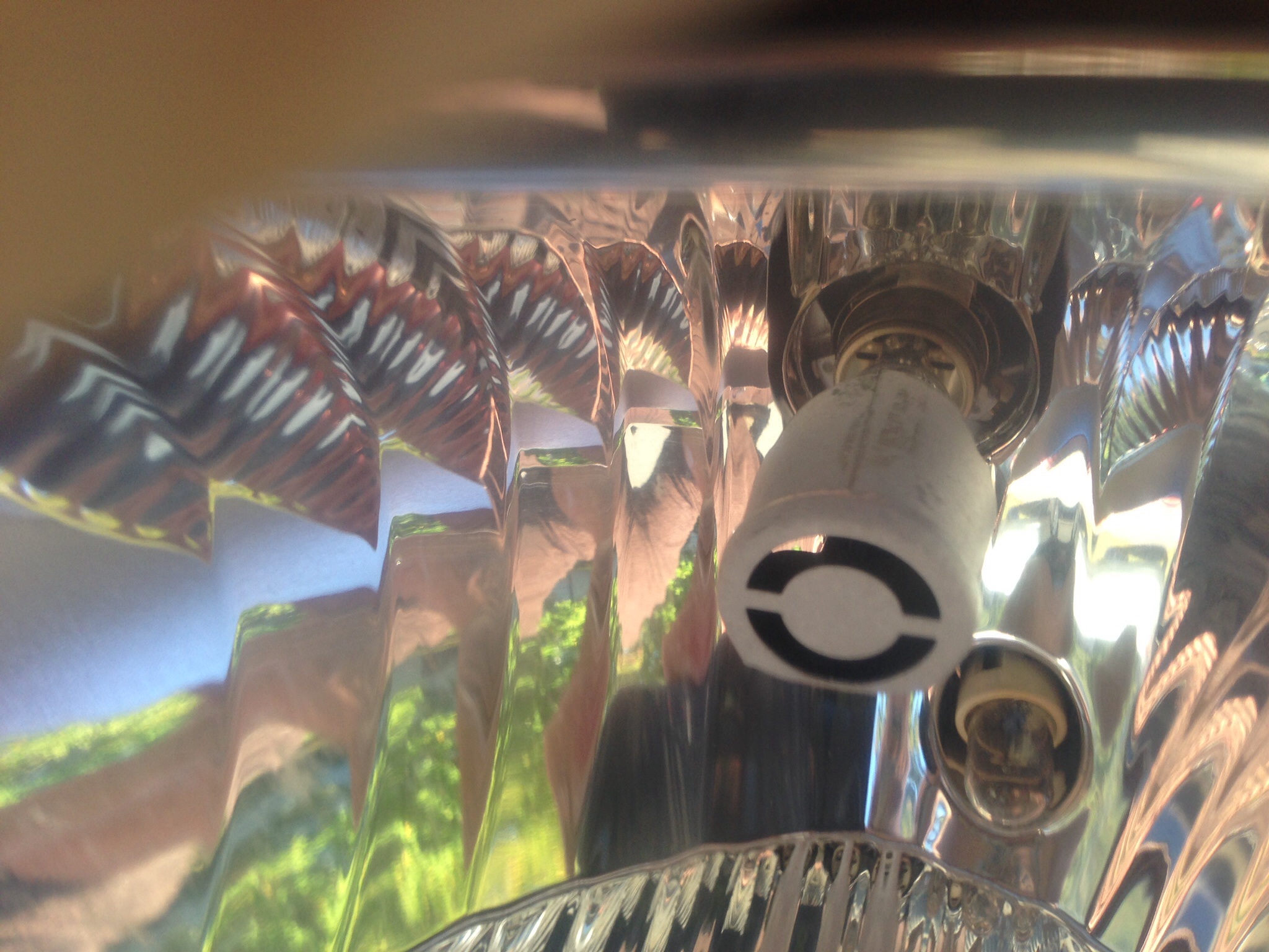

Left headlight, note slot at approx 1330 is open
Here is the problem in pictures
Right headlight socket, slot blocked

Well, I got the old bulb out, finally.
Sure enough, there was an extra strip of metal on the socket that precluded the new bulb going in. Once I removed it (three bends back and forth and it snapped off) the new bulb went in and snapped in as designed.
