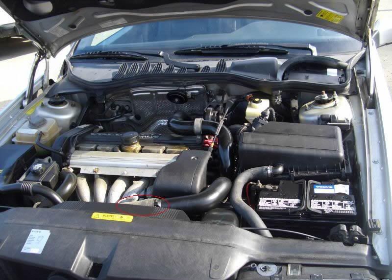

Maybe I just assumed it was radiator
here i circled it in red in the picture (which is not my car just a googled image)

Emmette
Posts: 36
Joined: 4 January 2006
Year and Model:
Location: ATLANTA
Post by Emmette »
Thats one of your intercooler hoses and when flat your not getting air flow which will cause the engine to die.

Post by MadeInJapan »
It will go flat if clogged...ie: frozen will do that too.

Post by cn2000 »
I've seen a few times where that hose just gets so soft from the oil accumulating inside it that it will collapse in the absence of a restriction, but at least we're on the right track here. Sounds like your battery is ready to be replaced too...time for a load test and alternator check.
