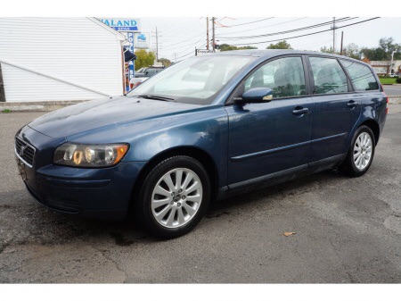

Preliminary shots from dealer
- image.jpg (53.48 KiB) Viewed 1810 times
- Odometer showing mind blowing miles
- image.jpg (30.8 KiB) Viewed 1810 times
