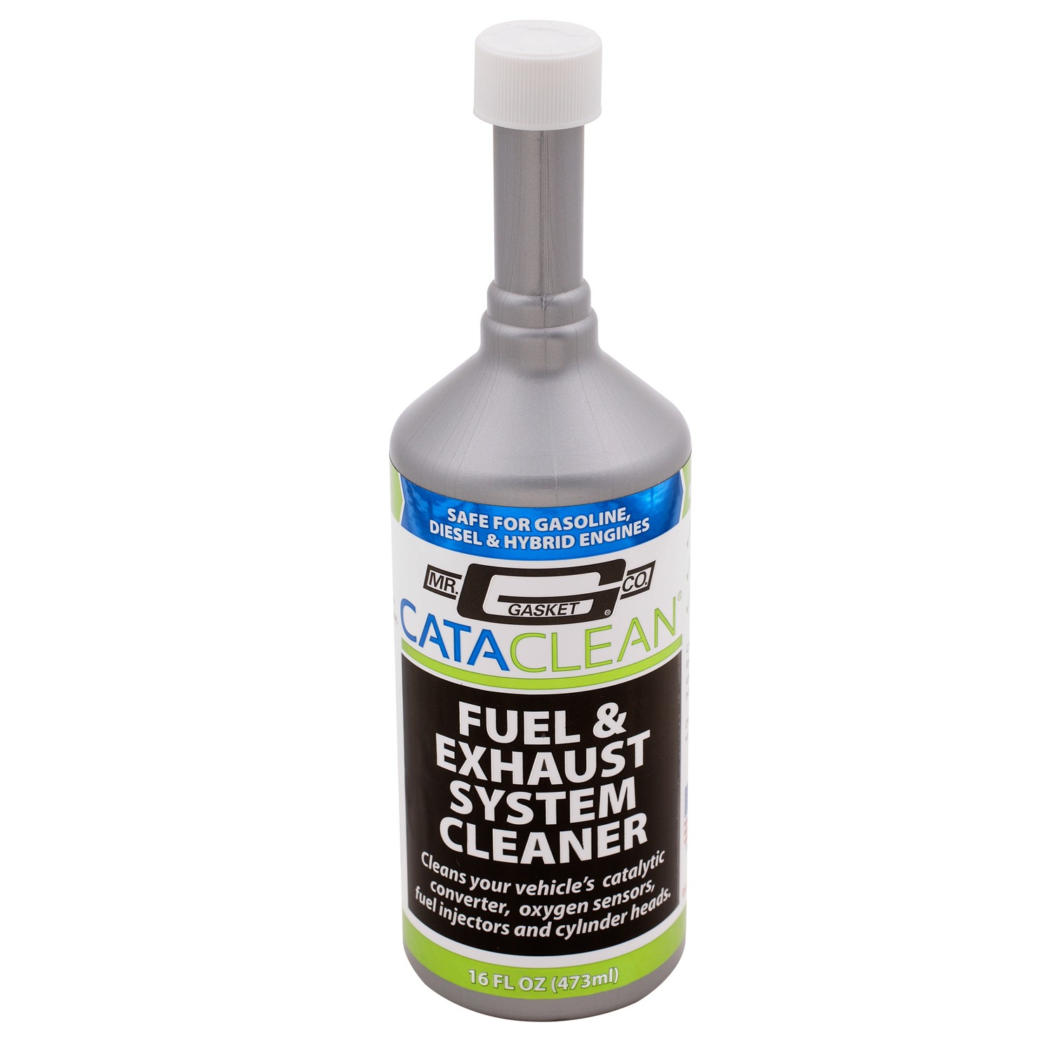

Visited the exhaust shop today and the tech and eye used the hose method to identify the possible leak. Nothing was found, entire exhaust still solid after all these years WOW. I put a bottle of cataclean to help clean the catalytic converter, hopefully the odor will go away. Still shocked how solid my oem muffler all the way from the down pipe is
