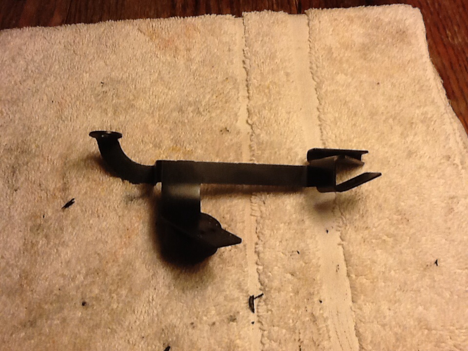

hi Guys, Could someone send me a picture how this bracket is installed? It goes on the drivers side of the radiator at the top. thank you!!
- image.jpg (227.04 KiB) Viewed 364 times
- image.jpg (224.93 KiB) Viewed 364 times

Using the 2nd picture - The bolt that holds the shroud to the radiator goes through the hole from the side facing you and the left side of the bracket slides into a slot on the shroud. I can post picture tomorrow if this does not help.

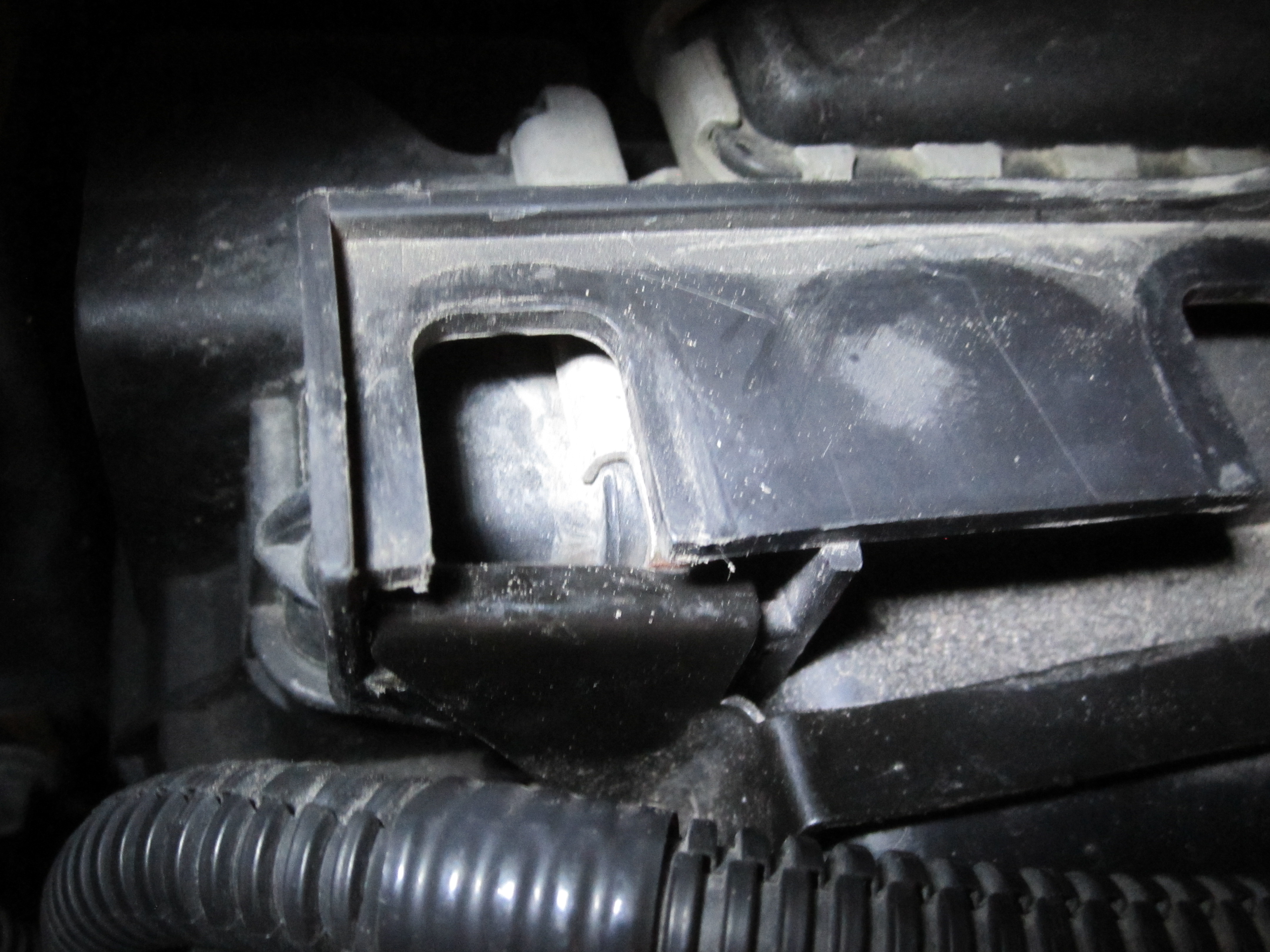

Hi kahl,
Tried to add these last night but computer decided to be a pain and crash explorer.
Picture 1) is taken to show position under cold air intake pipe
Hope this helps and sorry for the delay!
