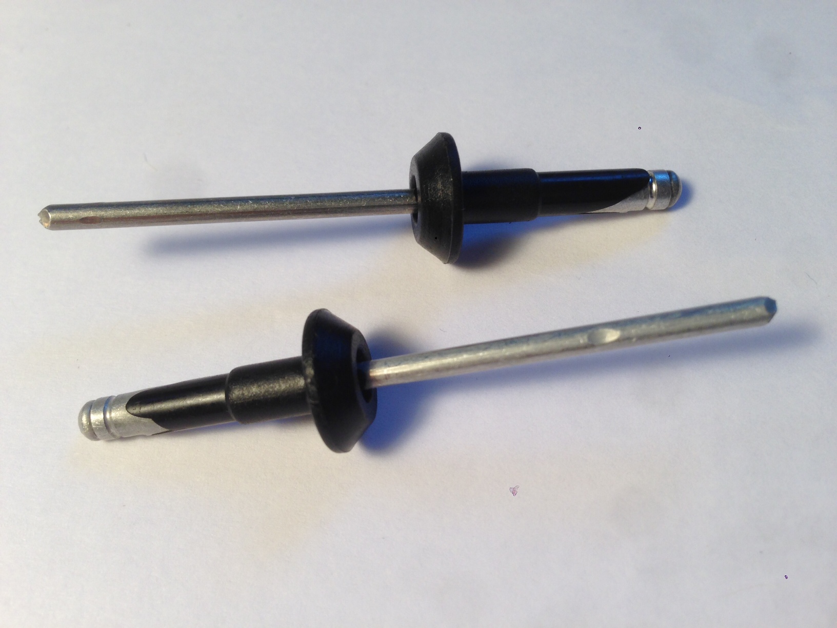

Post by MMT51 »
Use aluminum pop rivets with washers, or Volvo makes aluminum pop rivets with black plastic heads for the wheel liners.

Post by MMT51 »
Good point, but they are aluminum. I've drilled out and replaced them several times in the last few years without problems. Half of the rivets go into the front and rear bumper covers.

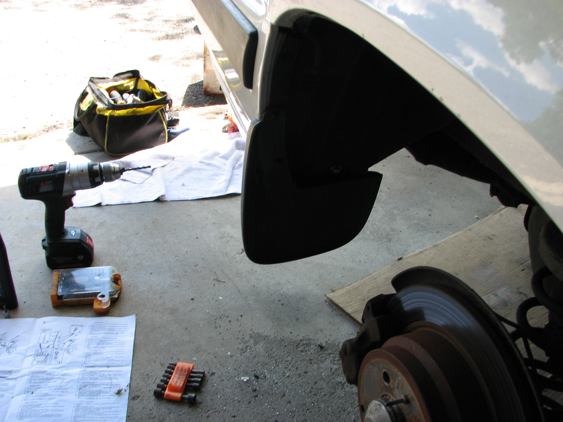

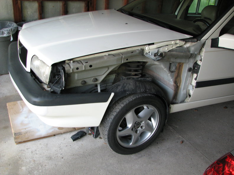

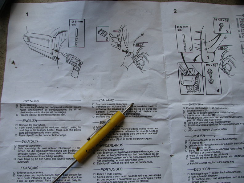

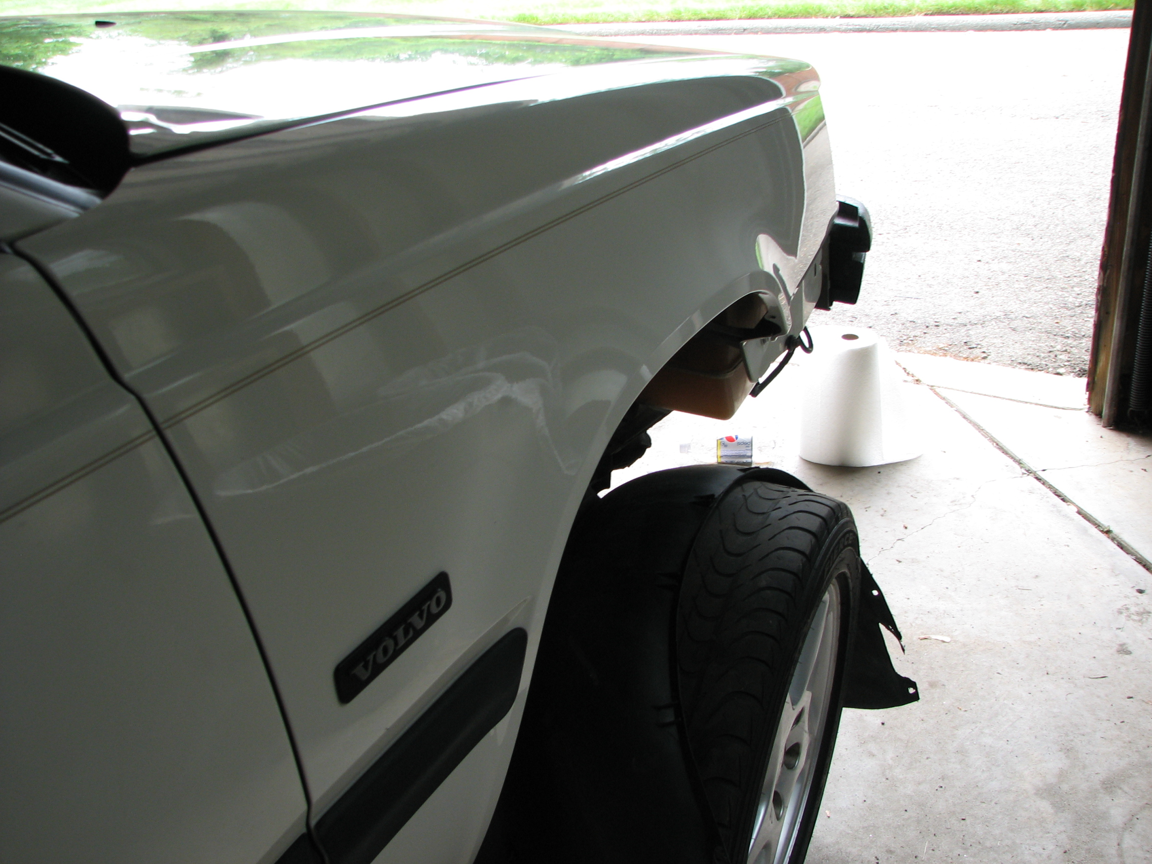

Ben850
Posts: 1613
Joined: 8 September 2011
Location: Michigan
Been thanked: 7 times
Post by Ben850 »
joe_pinehill wrote:I would have thought the OEM rivets would be stainless. Aluminum rivets into steel can cause galvanic corrosion. A wheel well is a hard environment, wet, salty.
Yes, that is one of the few areas I have seen, and repaired rust on 850 fenders for my cars.
I still use those rivets though to attach the front mud flaps.
Bumper cover is not metal, so sometimes those nylon push pins work better.
Rear mud flaps suggest bolts.
Rear liner with a combination of bolts and rivets. The way I had done it anyway.
Fun.
Fun.
1996 850 Turbo Wagon White.
1994 850 N/A Wagon Black.
1997 850 Sedan Black.
1996 850R Wagon White.
