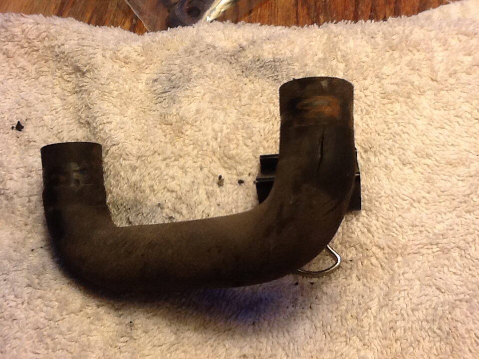

Following this guide I found a cracked "U" tube on my 2000 V 70 XC above the fuel tank directly behind the fuel filter. Replacing this pipe made P0455 go away.
- image.jpg (244.99 KiB) Viewed 2137 times
