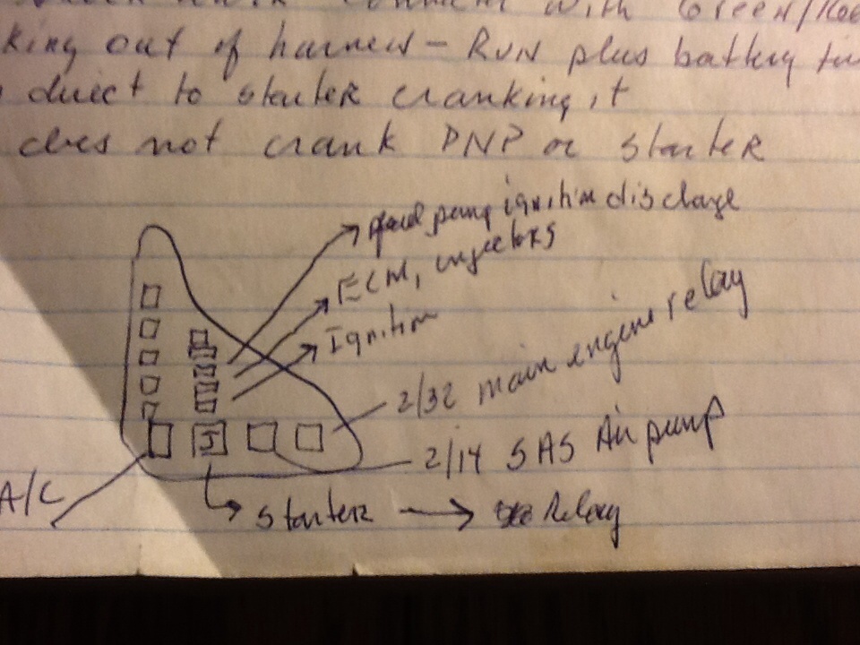

Hi, I have the same situation with my nephews 94 850 that is kicking my ass. The security relay is 210/211. It is in the cabin below the fuse box. To bypass jump 50E to 50F. The other item is the "J" breaker in the triangle box on the strut tower. Could you point me out where the starter relay is located?
I have read somewhere that there are two wires on or near the driver side strut tower that can be used for a remote start button. Can anyone shed light if these two wires go direct to starter solenoid bypassing relays etc?
Poor crapy diagram
Poor crapy diagram
