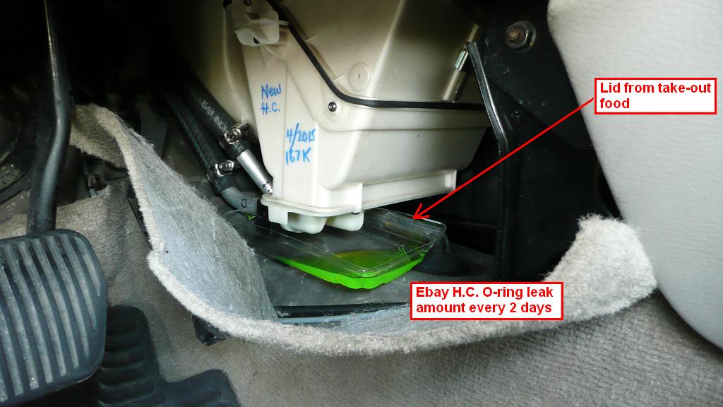

UPDATE re leaking Ebay O-rings...
1. Every 2 days, this is what I get. I used the lid from take-out food to collect coolant lol...
2. I used a piece of plastic as "gutter" to drain coolant...
3. The Volvo O-ring seems to have the same thickness as the ebay O-ring.
I didn't measure the I.D. and compare.
4. My theory is the ebay heater core female section might be a tad too deep, so when you tighten the T25 bolt, the pipe flange barely squeezes the O-rings. So I went to local OReilly parts store and bought some M14 copper gaskets because the O.D. closely match the Volvo plastic ring (from the firewall coupler).
- In theory you can use the plastic ring from the firewall coupler but I didn't two (2) of these. Also after 18 years, the ring I have is somewhat brittle (the other one broke during removal last week).
- Copper is better.
- But the copper gasket O.D. is a tad too big and the I.D. is a tad too small.
- I used dremel tool and sand paper and make it close to the Volvo plastic ring.
- When all done the copper gasket must be able to seat INSIDE the heater core female section.
5. After the copper gasket is installed, zero leak. So my theory is:
a. Either the ebay O-ring I.D. is a bit too big (I doubt it), allowing coolant to leak past where the aluminum pipe meets the O-rings.
b. Or the female recess in the ebay heater core may be a tad too deep (something like 1/10 mm or so). This is enough to cause leak because the O-ring is not squeezed properly.
Whatever the cause, the copper gasket + Volvo O-ring fixed the leak!!!
