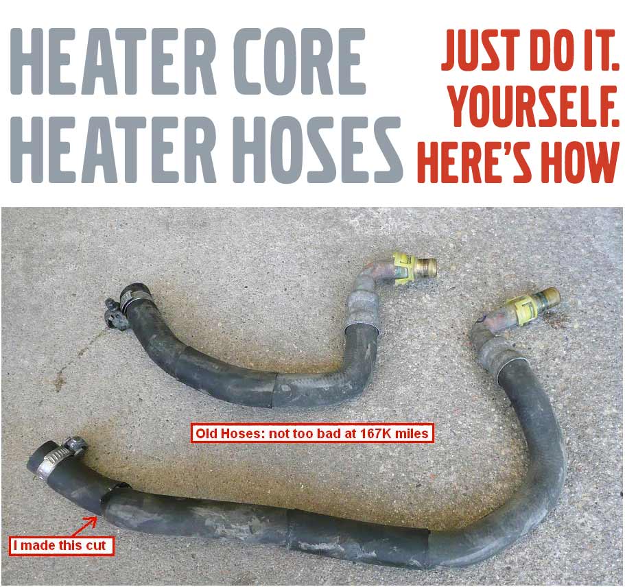

  • Anyway, this is my experience with ebay Heater Core ($40 incl. shipping), and used standard heater hoses to simplify this whole convoluted Volvo setup.
  • This is strictly preventive maintenance at 167K. The cabin once in while has this very faint sweet smell. The car consumes two (2) cups of coolant every 5K or so (going from Max to Min). Since others have reported the heater hoses can burst, dumping coolant in a matter of seconds and since the heater hoses are 18 years/167K old, it is time to replace them on a preventive basis. This is one job you do NOT want to do in the middle of nowhere, trust me.
