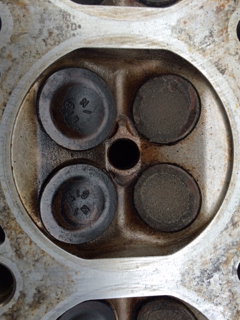

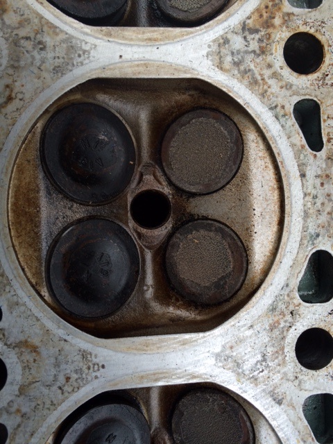

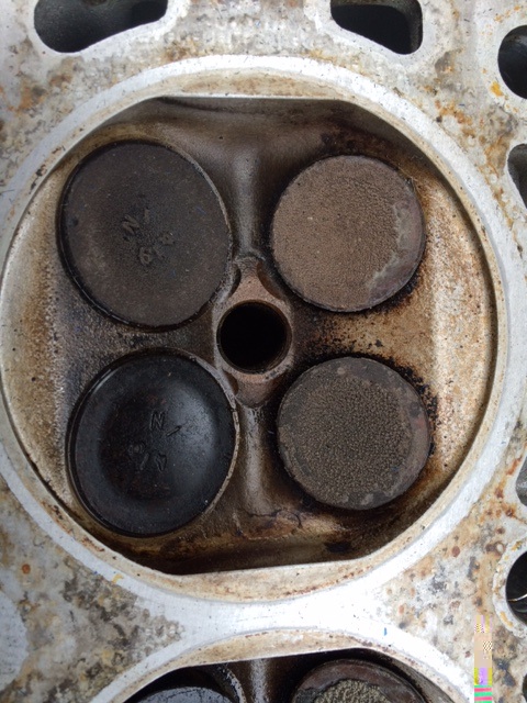

Here are some new pics of the valve seats after cleaning up each section. I think the black gunk that Lee saw thinking it was maybe a burnt section of the head between the valve seats. What I found is a lot of burnt oil deposits that came off with some cleaning. Nonetheless, let me know what you think - appreciate any suggestions or thoughts! Thanks!
One more note:
On cylinder 5 there is what looks like a section of the head that appears raised - it is very slightly, seems to be a small section of the head that may have been formed when the motor was cast.
Cleaned around the valve seats with some GOOP/GOJO and a nylon brush rinsing the brush with hot water in between each cylinder.
Cylinder 1
Cylinder 1
Cylinder 2
Cylinder 2
Cylinder 3
Cylinder 3
Cylinder 4
Cylinder 4
Cylinder 5
Cylinder 5

It looks OK after the oil got cleaned up.
Are you going to swap the valves out yourself or have a machine shop do it? If you do it yourself be sure to lap the new ones in with compound. I use the dye when I lap them in so that I know the seal will be good. I would also replace all of the stem seals and the guides, even if that valve isn't bent.

Thanks Lee!
I thought I would attempt the valve replacement and lapping myself, and order a gasket kit that contains the stem seals and guides. I will be back to report how I have done with all that in a few days. What kind of dye have you used or recommend?

I'm trying to remember, I think it was a Permetex product. I got the dye at the same time I bought the lapping compound and I'm pretty sure I got them both at NAPA.
