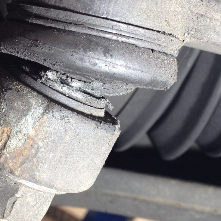

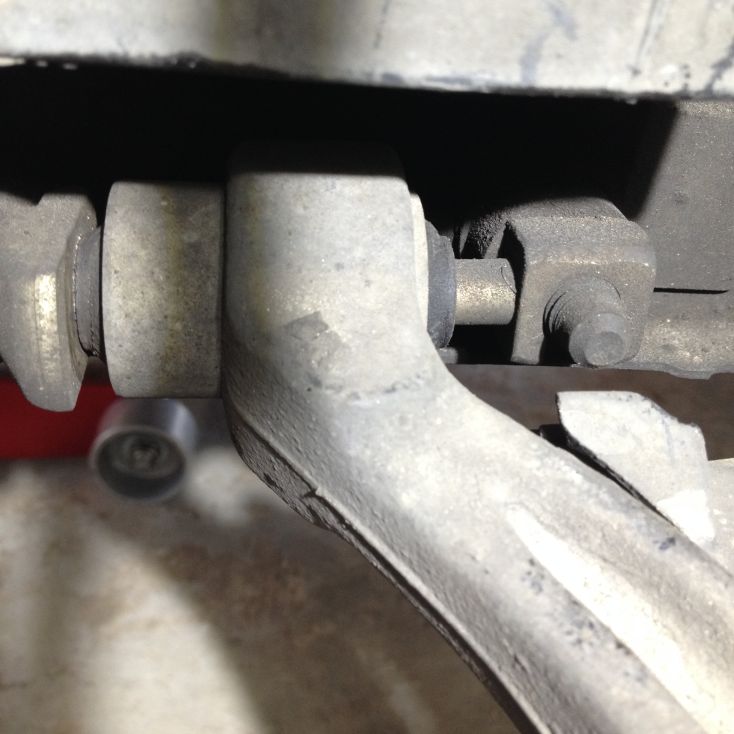

On another note, could you take a look at the lower control arm and tie rod end bushes and let me know if I need to replace them? I plan to replace them when I do the axle.
Thanks,
Thanks,
- Left tie rod end
- Left Tie Rod End.jpg (93.5 KiB) Viewed 636 times
- Lower control arm 1
- Lower Control Arm bushes 1.jpg (58.75 KiB) Viewed 636 times
- Lower control arm 2
- Lower Control Arm bushes 3.jpg (123.18 KiB) Viewed 636 times

I suppose it is possible for the grease to dry out but it is certainly unusual. The typical failure is for the boots to split and then the grease gets spun out. I did have a pair of them go bad after I managed to bury the car to the frame on a mud road during a thunderstorm. It took them about 12 hours to get it towed out with a farm tractor. I guess the water seeped in and they were clacking pretty bad about 2 weeks later.
I can't tell the condition of the boot on the control arm but if the boot is split it isn't going to last much longer even if it is tight. Just looking at them the bushings look fine. The tie rode end needs to be changed since the boot is destroyed.
