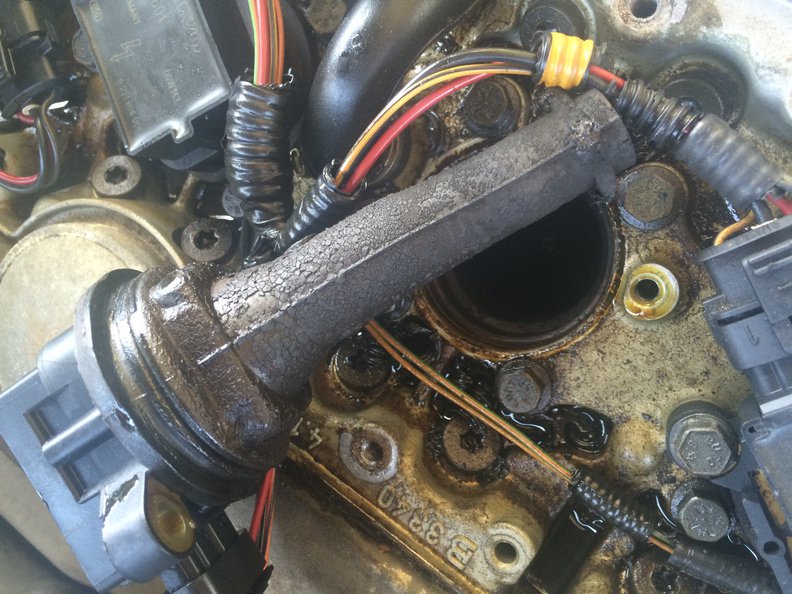

I think that you just found the reason for misfire.Rzzi wrote:The first one I pulled out was nice and clean then the next one was the photo in side is all black as well
Check other coil packs for damage.

If that is the coil for Cyl #2 (closest to the oil filler) it looks like it is covered with old oil from either a leaking filler cap seal, or a pressurising PCV system. Do the rubber glove test (pull the engine oil dipstick and run the engine with a glove over the dipstick tube). If the glove inflates the PCV needs to be replaced ASAP.
Otherwise, clean all the oil up (including the area in the tube down to the spark plug). Pull the plug and check it for burn marks on the ceramic near the base. Swap the plug and coil for a good one (coil can be from another cylinder) and see if the problem goes away or moves to another cylinder from which you took a good coil as others have suggested.
If you have any good Pick and Pull yards in your area, you may be able to get a good used coil from another engine. Take any other than the coil from cylinder #2. I have a theory that leaking oil runs into the area around the spark plug for cylinder # 2 and causes the coil to short out, eventually burning the valve out.

Oil is not conductor.It can't "short" things.
