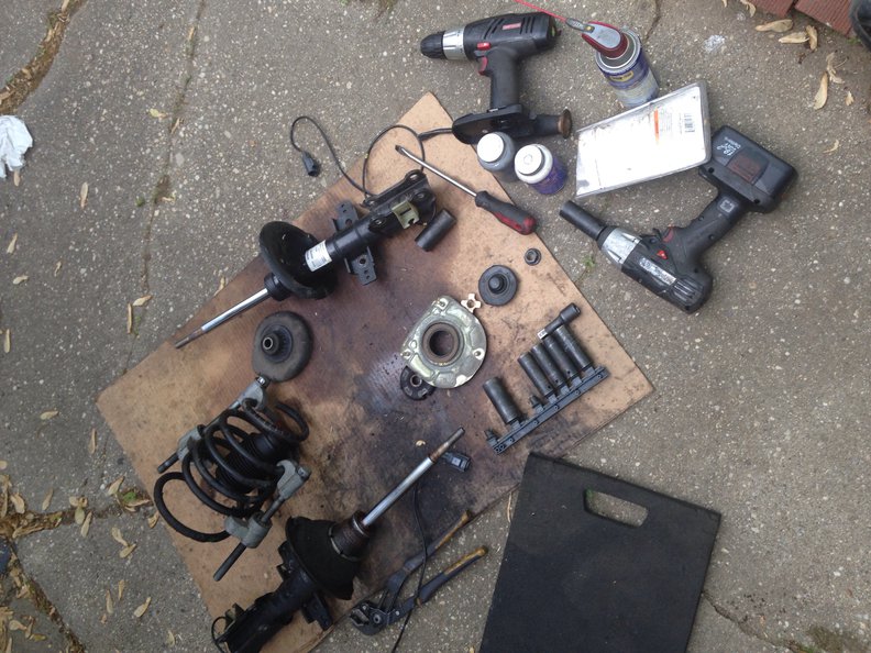

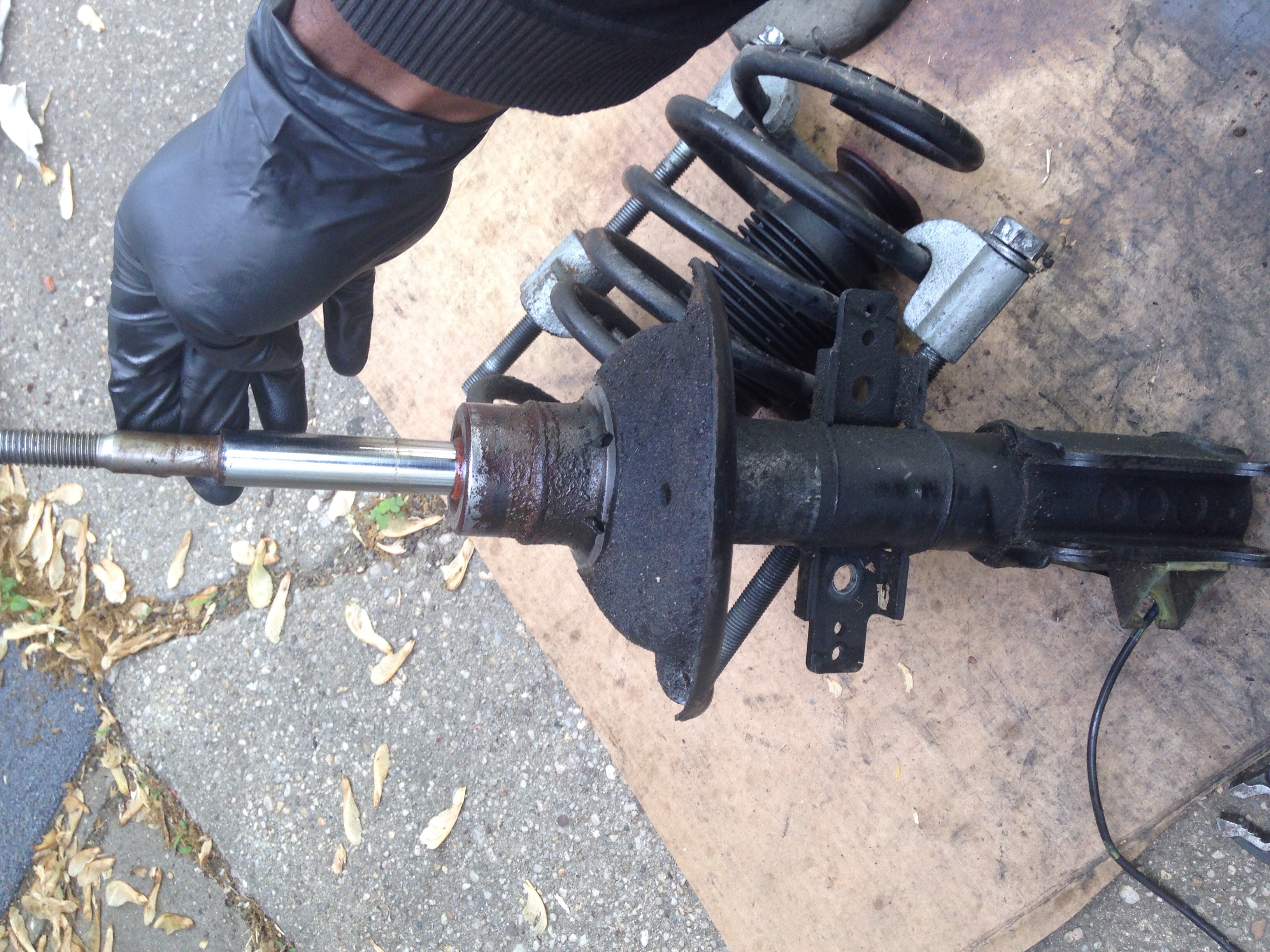

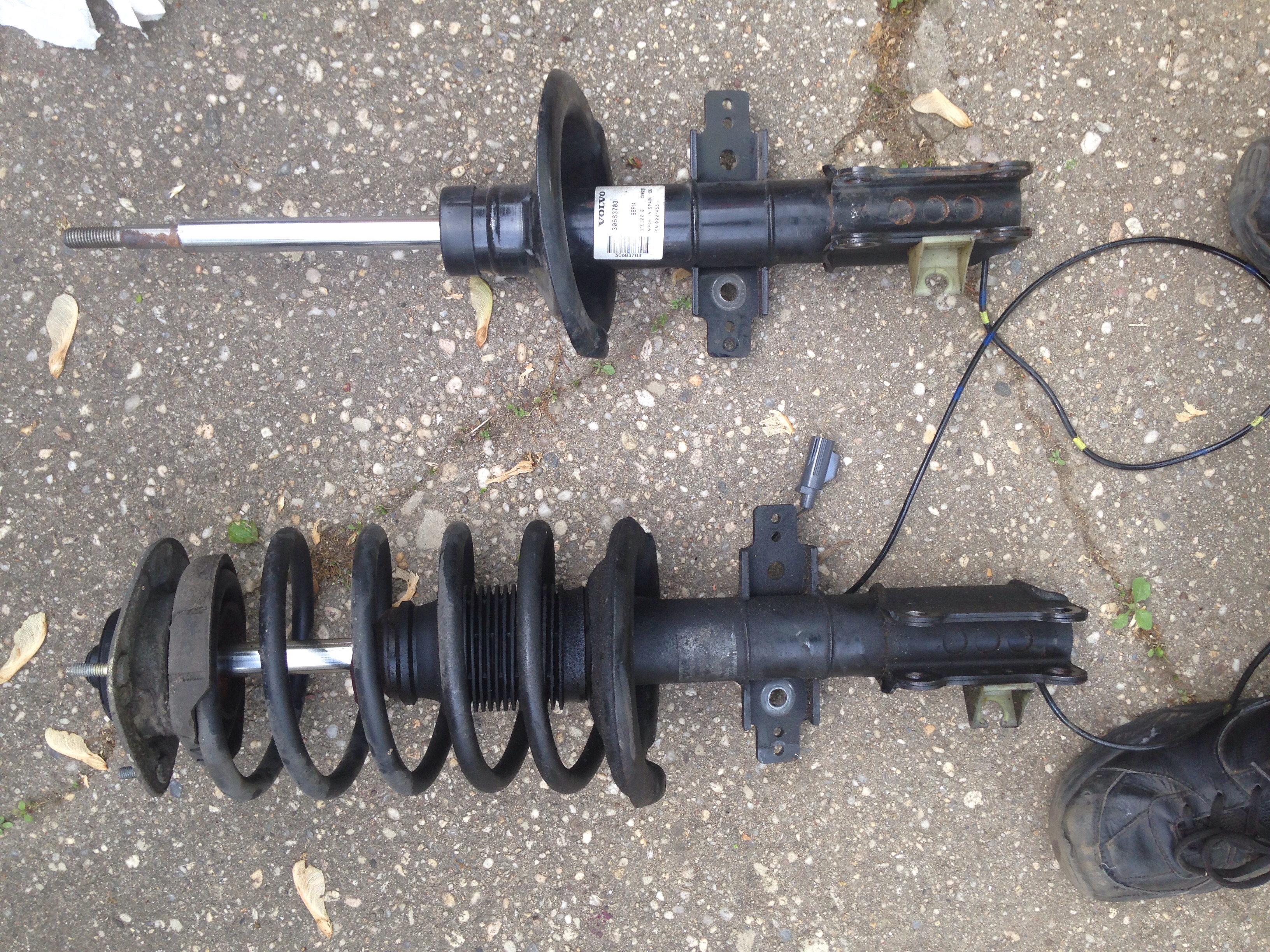

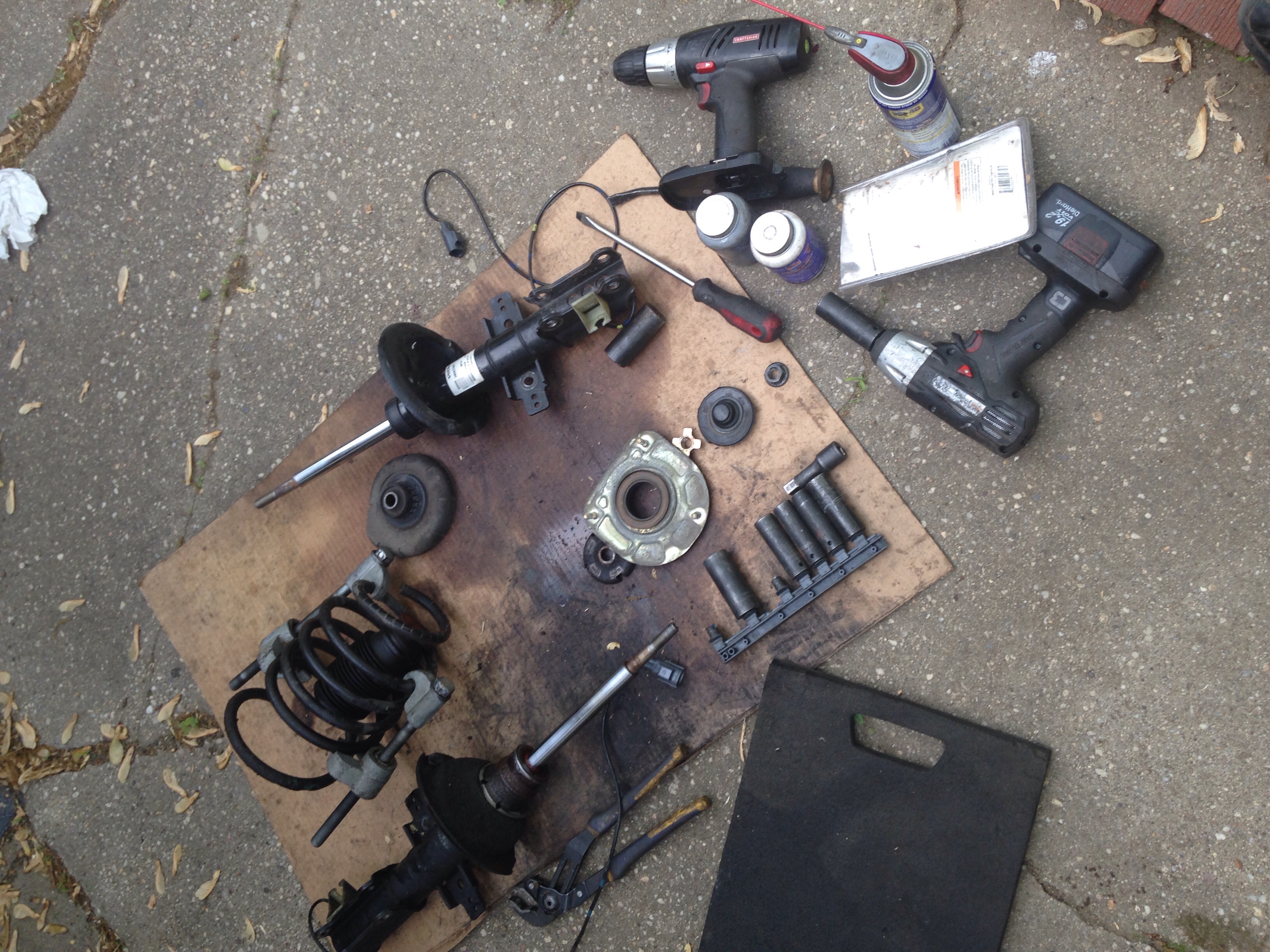

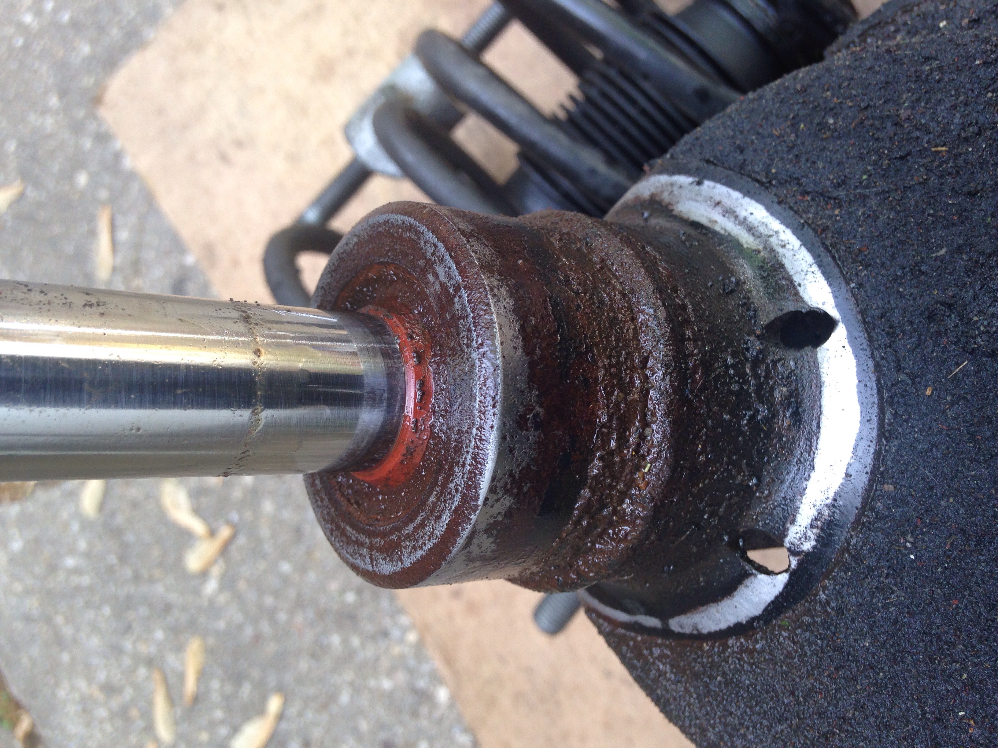

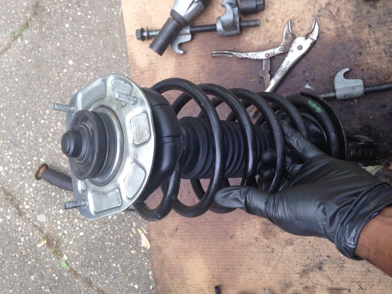

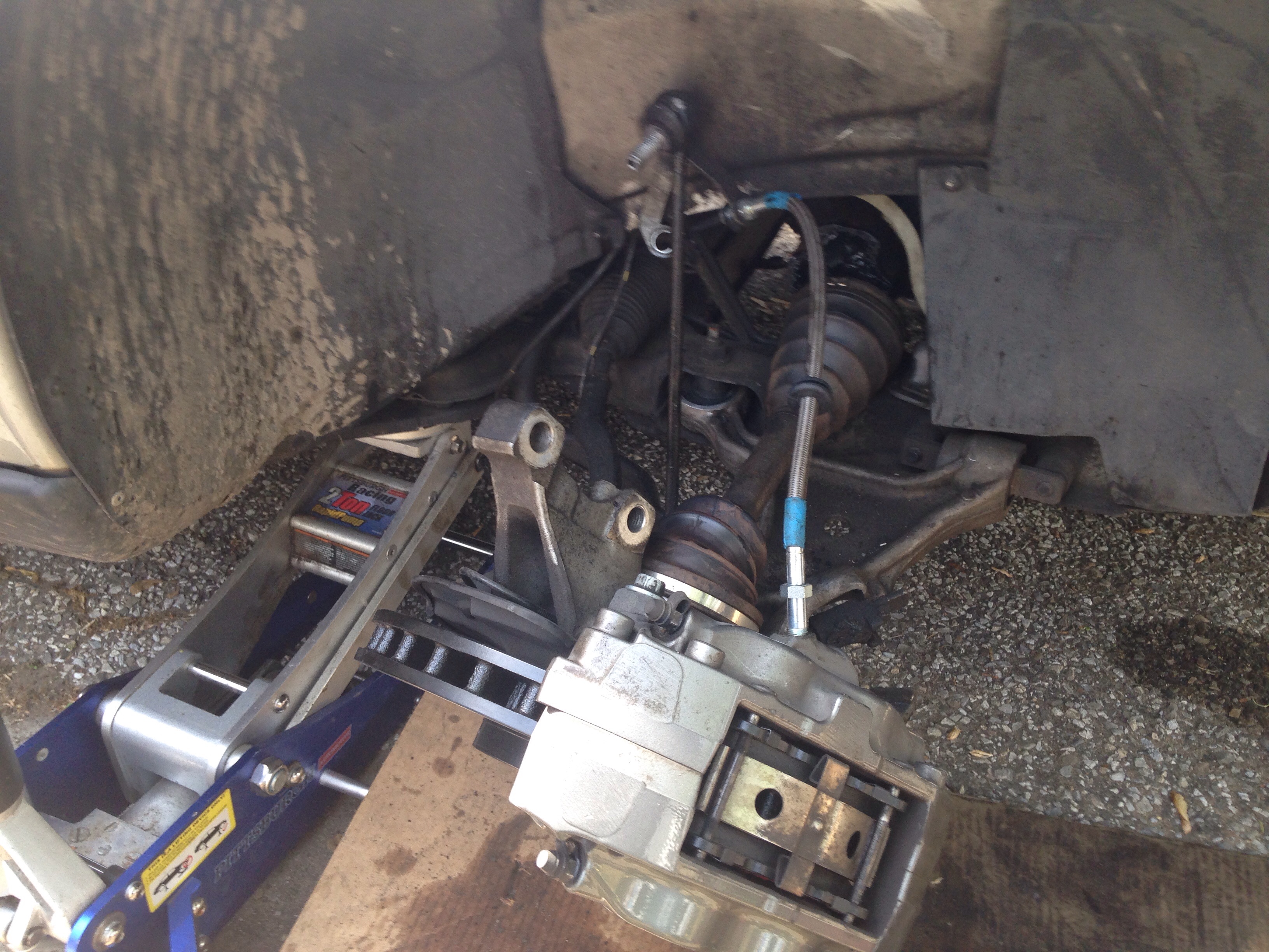

My front right strut was destroyed from NYC streets
" go figure " so I replaced it yesterday. Now I have to get the system calibrated @ Volvo which isn't gonna happen anytime soon. They can suck it @ $169.95/hour
04 V70R F/R Leaking Strut Replacement
