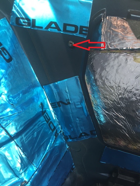

1: Remove trim/interior panel on passenger side of trunk area. What you need to access is the area behind the wheel well, where there's a covered opening in the panel above the vent. Take off the soundproofing cover, if it's still there.
2: Remove this screw:
and the clip holding the emergency opening wire. Don't worry, nothing's falling down anywhere.

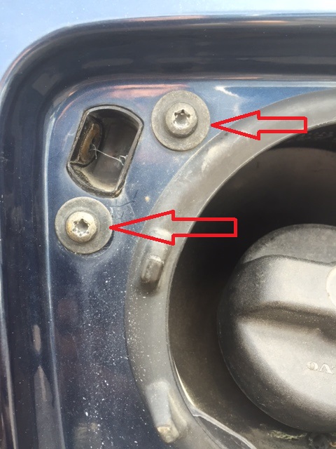

3: Remove these 2 screws - they're all T15 or T20, iirc:
Once all 3 screws and the clip are removed, pull out the entire locking mechanism. Remove the electrical connection.

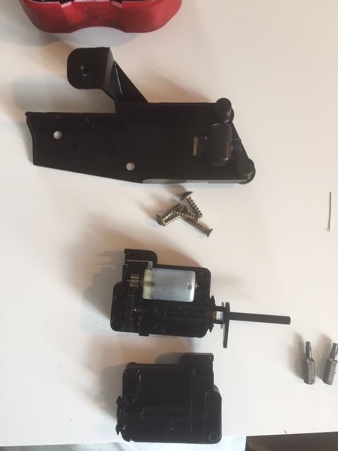

There are 5 screws on the assembly. Take off the 2 on the "cover" first, and then open the mechanism by removing the 3 remaining screws, which are T10s. Open the mechanism up. You'll see this:
Pretty basic stuff. Grease everything if all is working, replace motor if you must, etc.
Putting everything back together is a simple reversal of the steps.
When you're putting this back in the car, connect power and check functionality before anything else. Then, fix the interior screw first, leaving some slack for movement. Then, find the two exterior screws, and line the locking mechanism up by putting the screws back in. You can aim the screws at the holes, and stuff's tight enough in there for the screws to reach in w/o the assembly disappearing.

Yup - also, if you're not into fiddling around inside the tiny motor, a replacement is about $2 for this kind of thing. Mine is stamped "Made in China", so I'm thinking it's not exactly a specialty item. :D
I saw that post of yours, and opened the motor up, but mine didn't have the black stuff on the brushes, so I closed it all up, greased everything and it seems to be working like a charm now. :)
