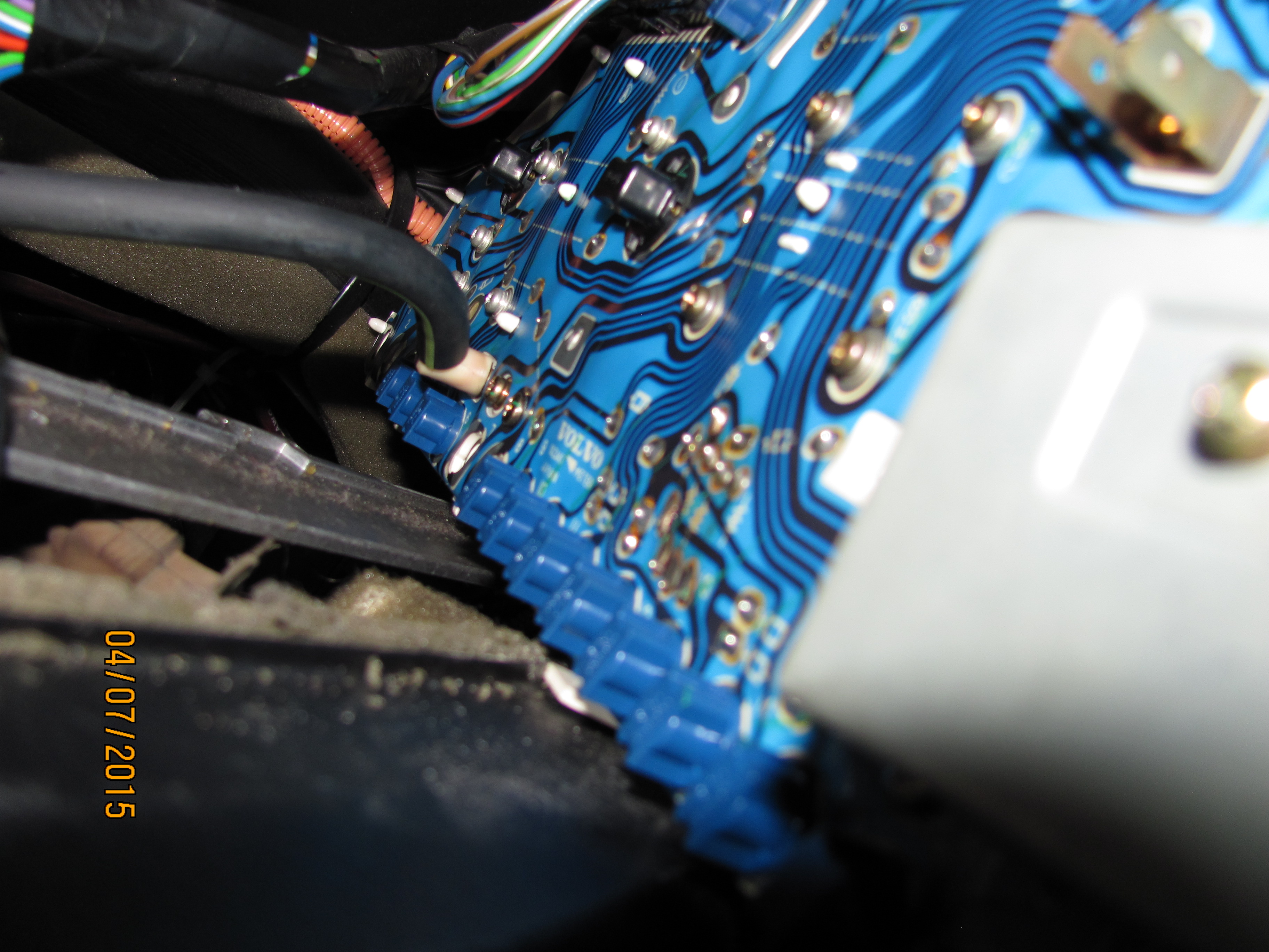

OK guys,
this morning it happened again while on my way to work, however, I noticed that hitting the dashboard just above the whole cluster it makes the odo/speed meters work again, then stop then start again and so on.
It might be a soldering issue or perhaps, a connection, so I will follow the link previously posted by 93Regina: http://www.turbobricks.com/maint.php?content=art0031
Let's see what I will find out.
Alex
Alex

Working to remove the cluster... anybody knows the correct way to disconnect the hose that goes to the turbo gauge?
Do I simply need to pull out the plastic connector (beige color) from the gauge?
If yes, is there a specific direction I have to turn it to remove or simply pull it out?
Otherwise, should I just remove the black hose from the plastic connector?
Thank you!
Alex
Thank you!
Alex
