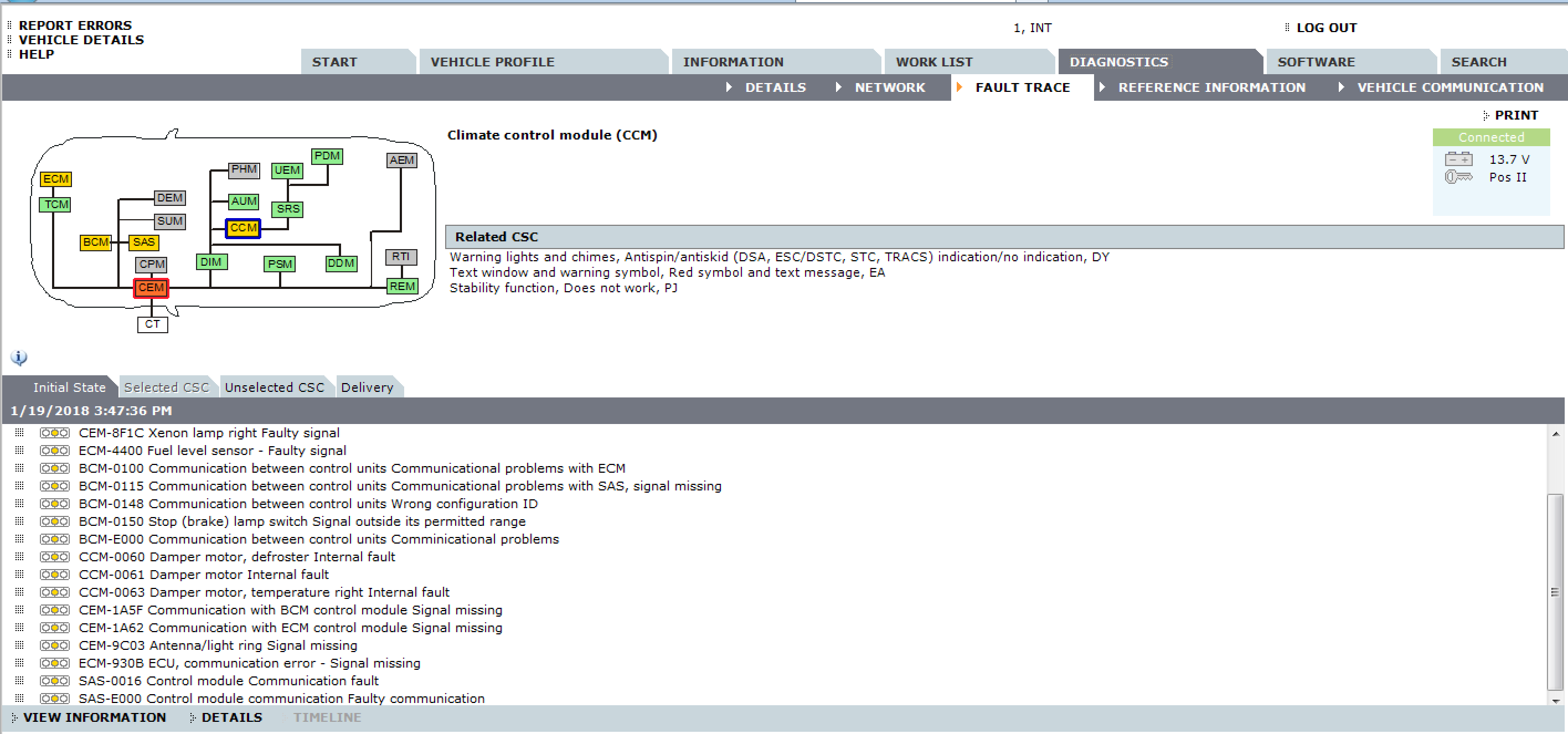

My 05 Volvo S60 T5 has displayed "Anti-Skid Temporary Disabled" messages 3 different times in the last 2 months. The message will disappear then appear again some future date. Today it happened again and by the time I got home to plug in VIDA the message was gone.
I assume the BCM and SAS modules are the one's I'm interested in.
I know VIDA shows fault history but the timeline tag is grayed out so maybe I'm not doing something correctly. I've taken a screenshot of the diagnostic tab and hope someone can point me in the right direction to figure out this out.
Should I clear all history and wait for the message and check again?
Any input would be appreciated.
The red CEM is because I have halogen light assemblies when the car expects Xenon.

I would clear it all out and see if you get anything again. God only knows how old some of those codes may be.
