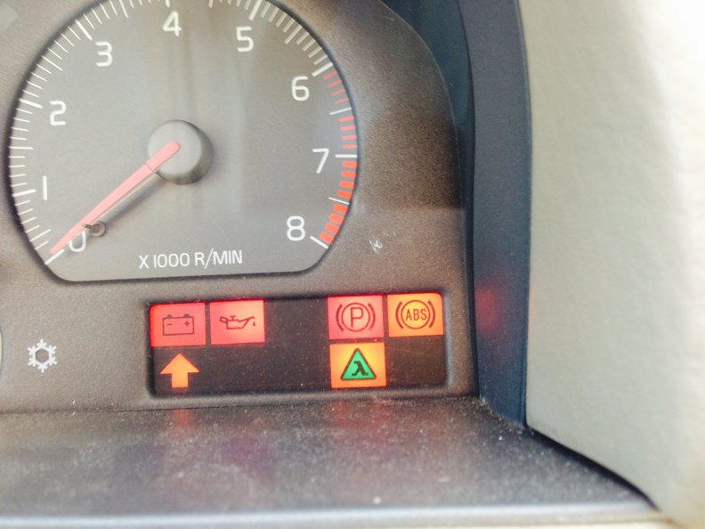

The car now starts for about 2-3 seconds, but then stall and wont turn over again. The dashboard is displaying the mysterious green lambda sign and I can't seem to find it in the manual.
Does anyone know what the issue might be? Attached is a pic of the dash lights, thanks.

The 850/ C70 forum on this site says the lamba light is the non-US version of the check engine light.
https://www.matthewsvolvosite.com/forums ... =1&t=25459
Try checking for diagnostic codes?
Tim in Dallas TX
Chances are you need a fuel pump relay,...also, can you hear your fuel pump clicking on when you turn on the ignition (but not start the engine?) Other common culprits are crank sensor, and coolant temp sensor. You can invest in an OBD reader to read your lamba/check engine light or have a mechanic read it
