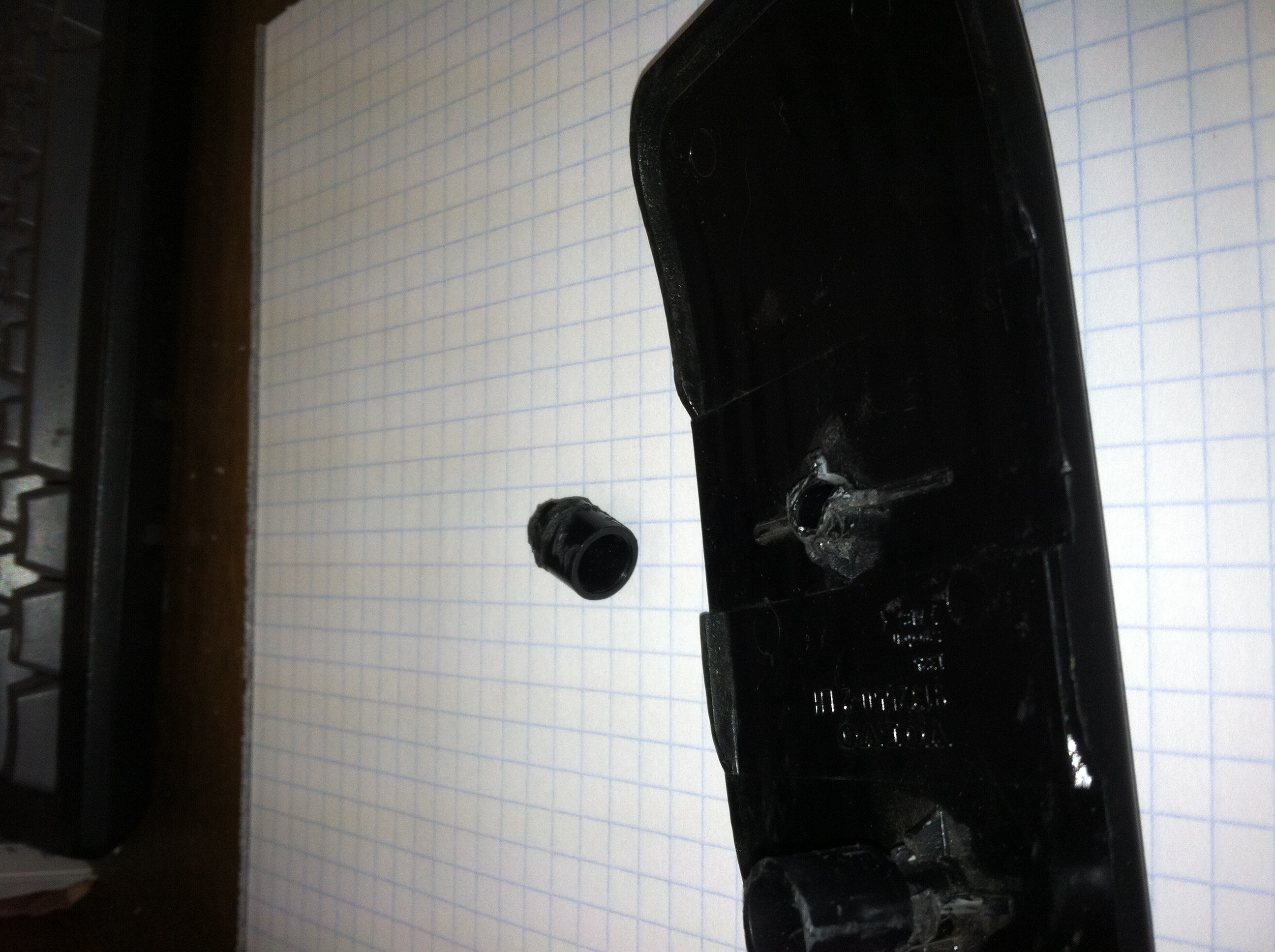

Thanks for trying. The bottom pin has a plastic part sticking out at 90 degrees and that keeps it from coming out clean. My floor mat covers the foot rest, so until I order something, it will remain as is.

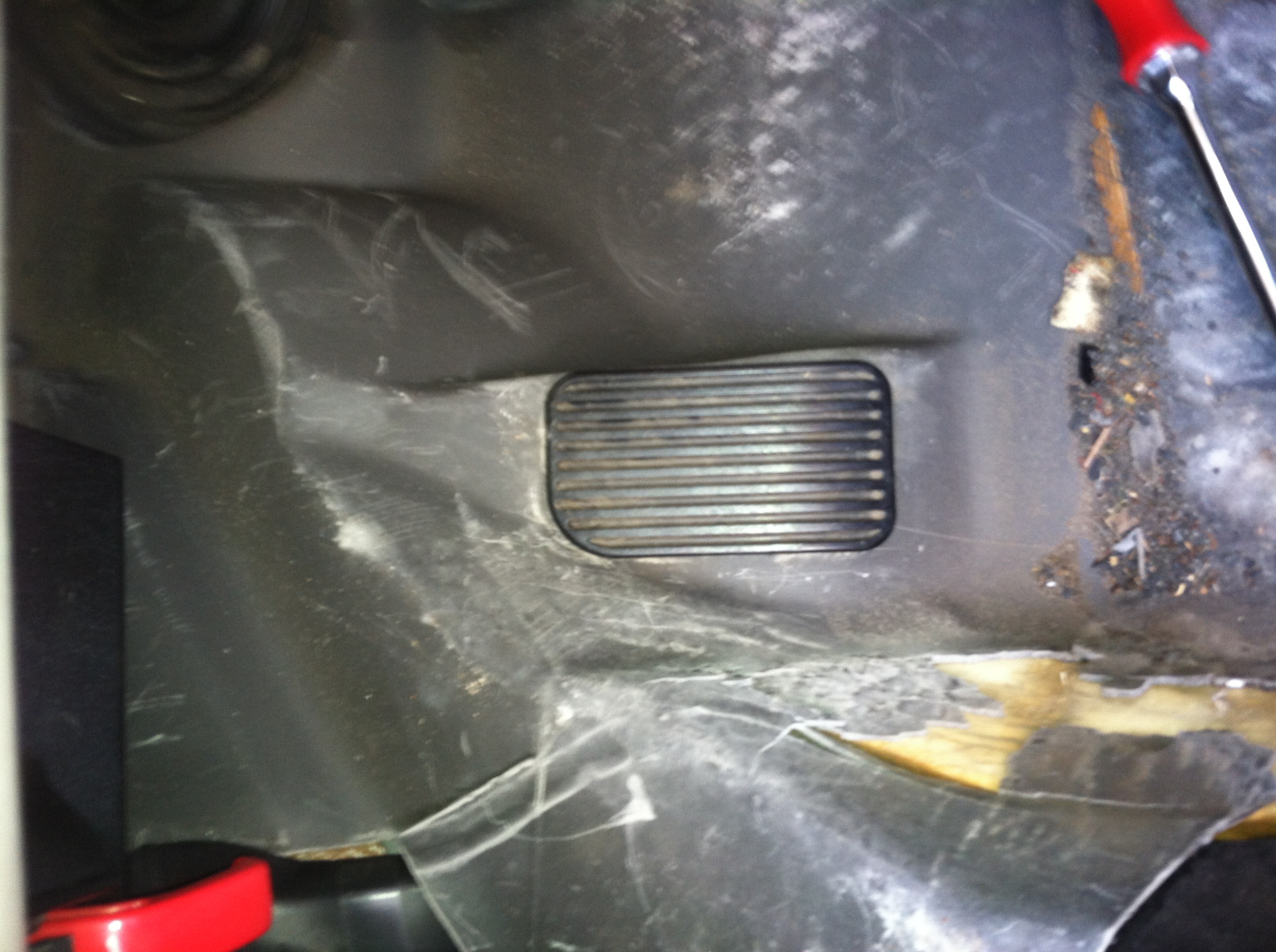

Did you noticed how bad the area to the left of the rest was? It was all messed up. Well I used what I had to add a little patch. Thought about replacing the entire area, but that rubber bottom goes under the steering wheel.

It comes down,then back,then breaks.abscate wrote:It looks like it comes DOWN then back. I would have sworn I pushed my 1999 up and then back.
The new standard procedure for removal.
I would like to know if anyone has removed one without breaking.
Shane

And the broken piece falls into the bowels of the car so it can't be JB welded back.

I thought that, too. It has that little curve at one end. Probably a good way to remember it is that you push it the opposite direction of the curve.abscate wrote:It looks like it comes DOWN then back. I would have sworn I pushed my 1999 up and then back.

Looks like me and JB are going to put things back together. It's something simple to play with. I need simple.abscate wrote:And the broken piece falls into the bowels of the car so it can't be JB welded back.

If you can find a piece of wood dowel to JB weld inside that it will be a lot stronger

Already thinking, Threaded rod, with maybe a washer and nut on the end.
Major weekend project.
