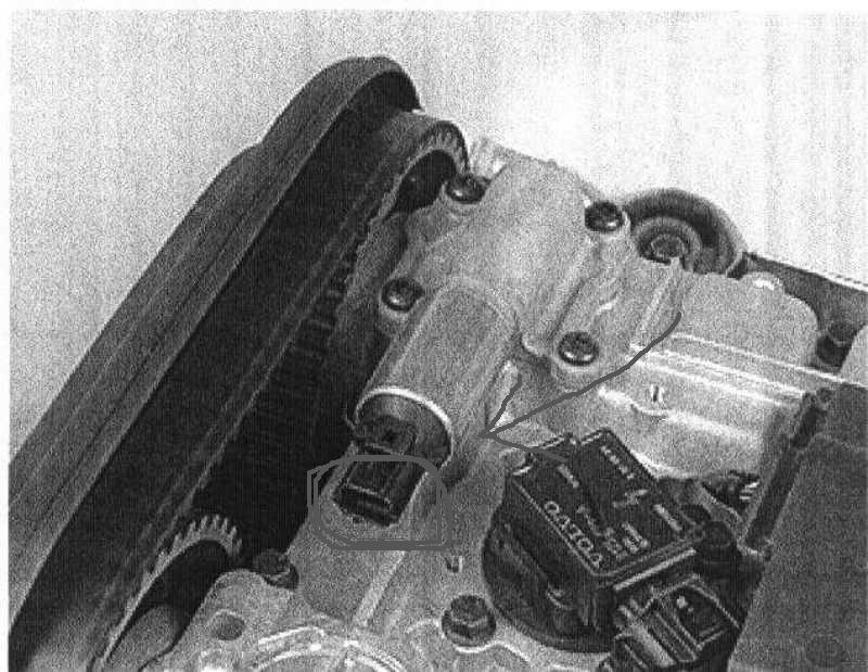

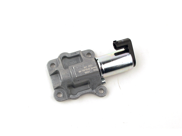

I replaced my intake solenoid because it was clogged - much the same way the transmission solenoids were affected. The actuator was still working but the sleeve inside wouldn't fully open. There is a new redesigned solenoid part. This solved the following issues
- poor engine timing caused by the solenoid not fully opening
- engine pinging (pre-ignition) under acceleration even with higher gas octane and the cylinders being clean with new spark plugs
- top of the engine getting overly hot as a consequence of the pre-ignition (the temperature gauge will stay at 12h)
The pictures in order
1. Location of the solenoid (exhaust one pictured)
2. Newer design of solenoid. It has a stainless screw that won't rust like in the older design
3. Old design of solenoid with a rusted screw head
A word on clogged Camshaft Solenoid
