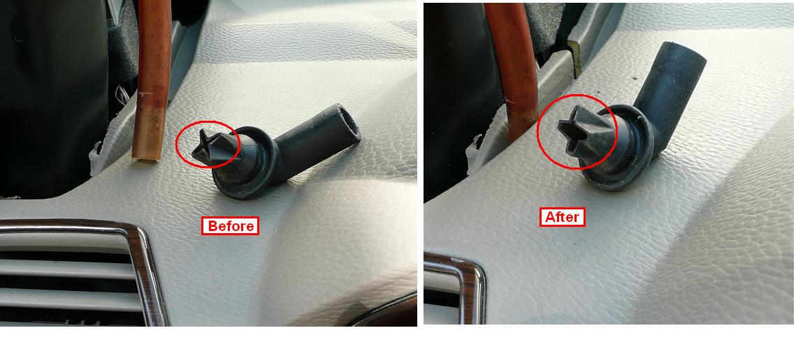

2. Drain Tube drains into Rubber Elbow:
3. Not sure why the Rubber Elbow has flaps to restrict flow (my BMW X5 has the same design!!!). I cut diagonally to increase flow. Whatever you do, during installation, make sure the Rubber Elbow fits properly (pay attention to the flange that sits inside the car round hole).

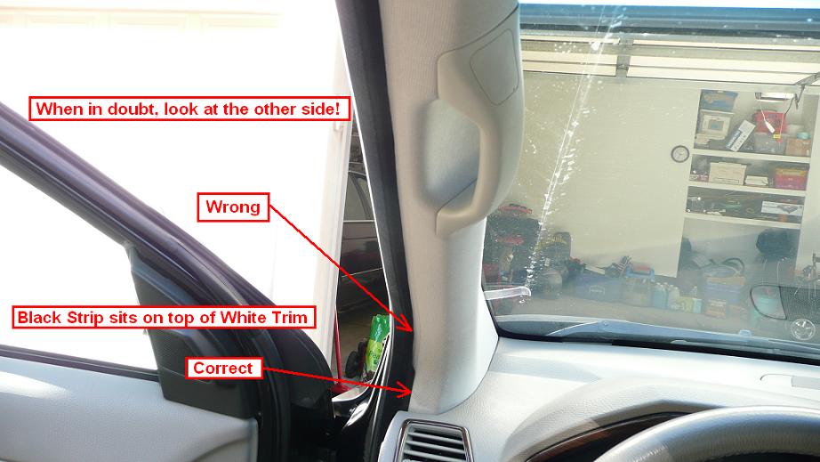

5. During re-installation, make sure the Black weather strip sits on top of the White Trim.
When in doubt, look at the other side for advice!

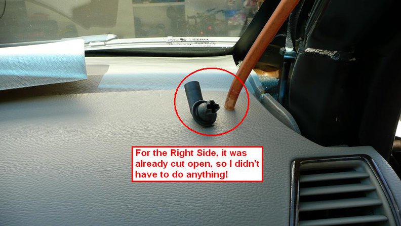

6. The other side (R side), well the P.O. already did it, so I just reinstalled it back.

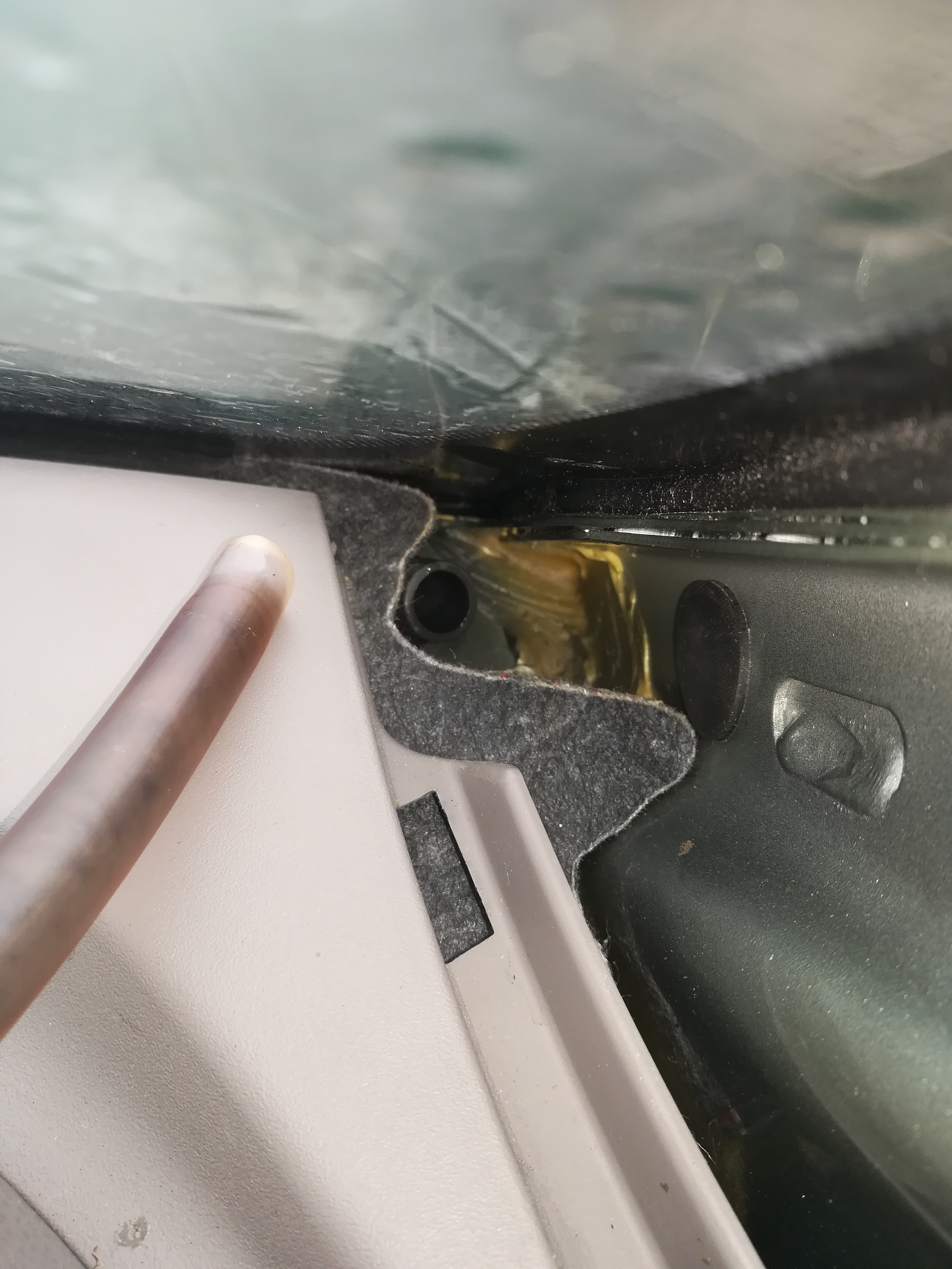

Hi there, I unfortunately went through the painstaking process of having to gut my s40 due to water. We figured out that the issue was because of a clog in the elbow drain and that it disconnected from the hose that runs along the A pillar. I bought a new elbow drain, but am having quite a bit of trouble getting it to seat right in the firewall. I’m trying to avoid ripping out the dash or taking out the windshield. Do you have any suggestions of how to get this back in and seated properly? Thanks!!

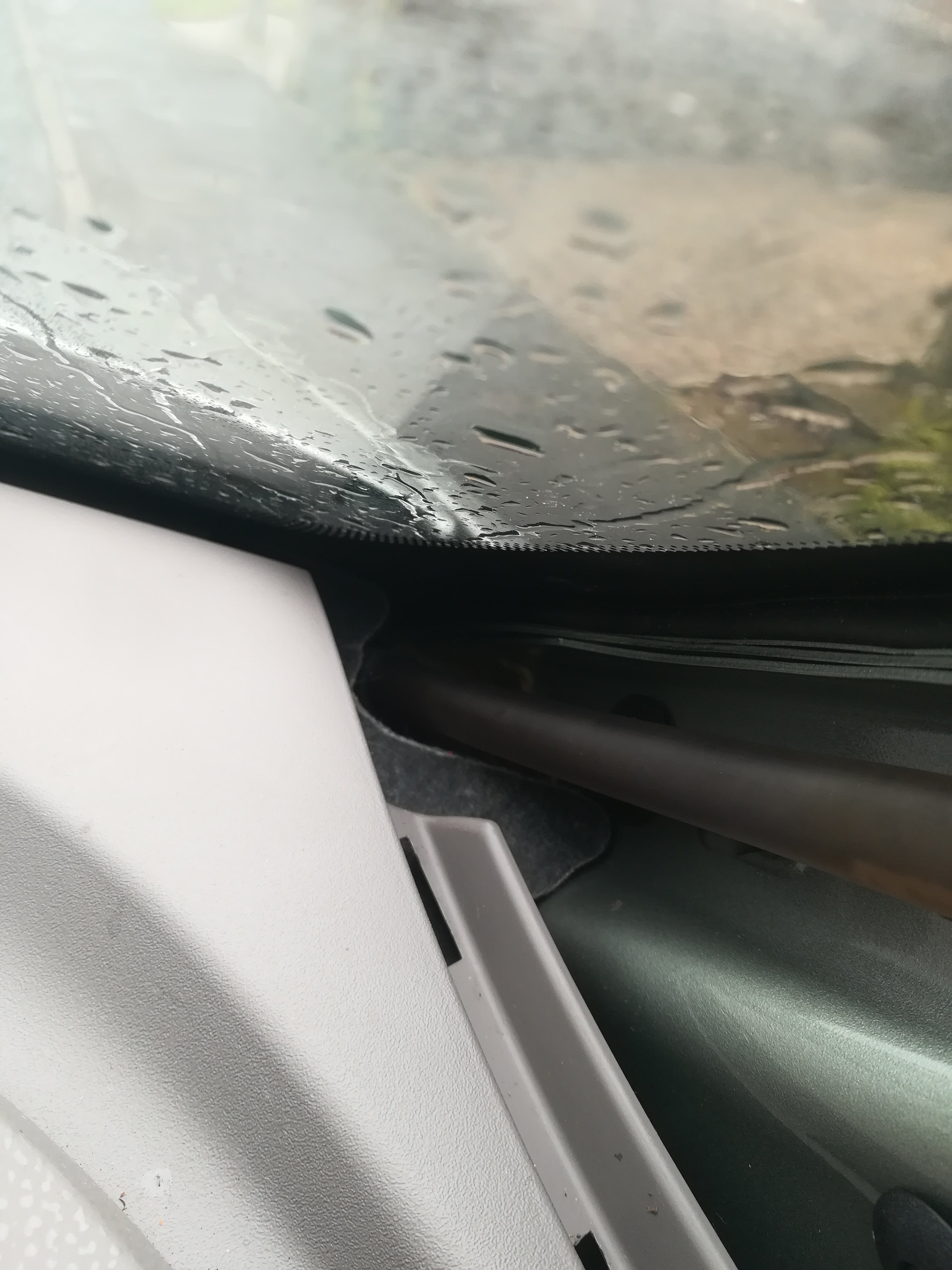

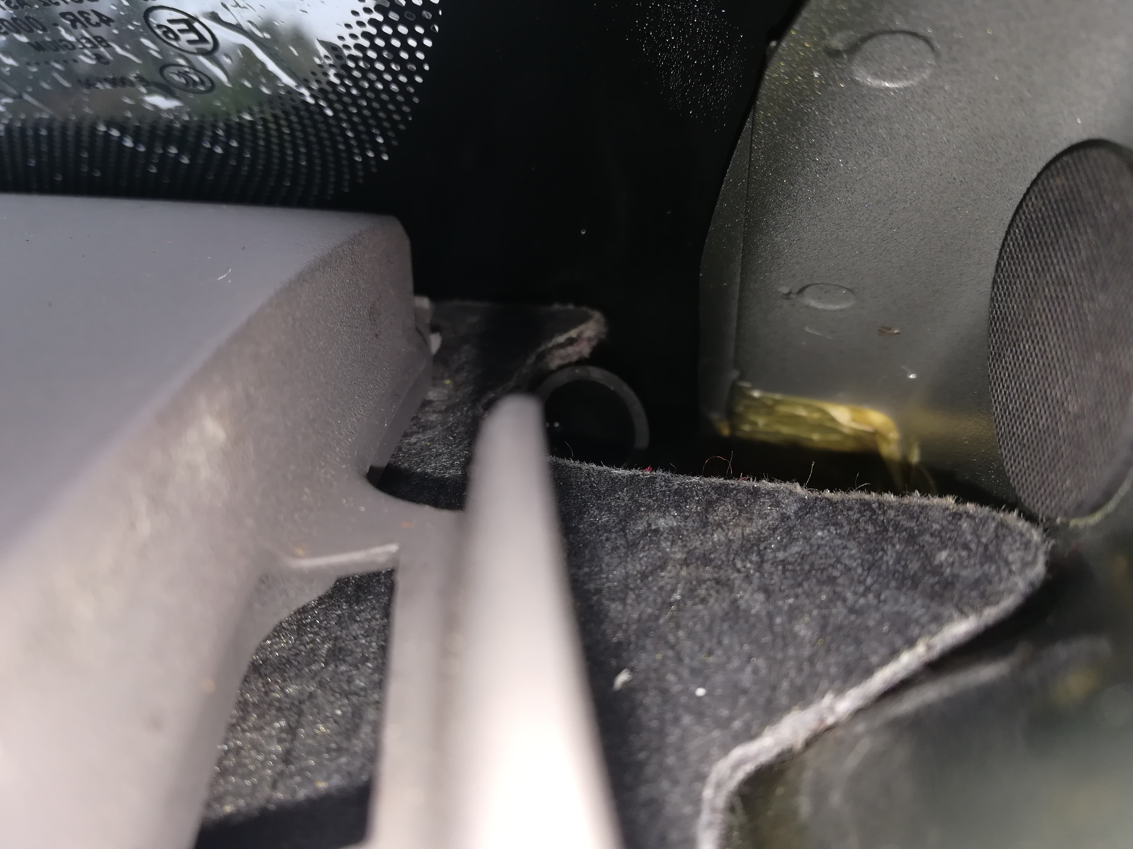

I drive a 2006 S40 and I'm experiencing the same problems. I have already removed the trims of the A-pillars (a slightly different process to that mentioned in the above post, but no more difficult) and I can see (what used to be) a clear plastic drainpipe running from the headliner to the base of the windscreen. I can remove the drainpipe from the elbow (see attached pictures) but I am wary of removing the black rubber elbow for fear of losing the rest of the drainpipe down behind the firewall, never to be seen again! Can anyone help/advise?
Many thanks!
