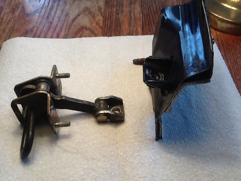

have 1997 850 wagon with front door check strap weld stuffed at A frame, making huge clunk on opening and closing.
Wondering if there is a fix for this.

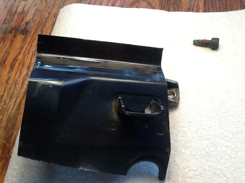

On the 98 V70 AWD the attach point on the door frame was FUBR. I had to go to a bone yard and cut out what I needed for the A pillar. Hope these pics help. Welded in what I needed. On YouTube tere are several vids on this problem.
- image.jpg (194.67 KiB) Viewed 442 times
- image.jpg (166.67 KiB) Viewed 442 times
