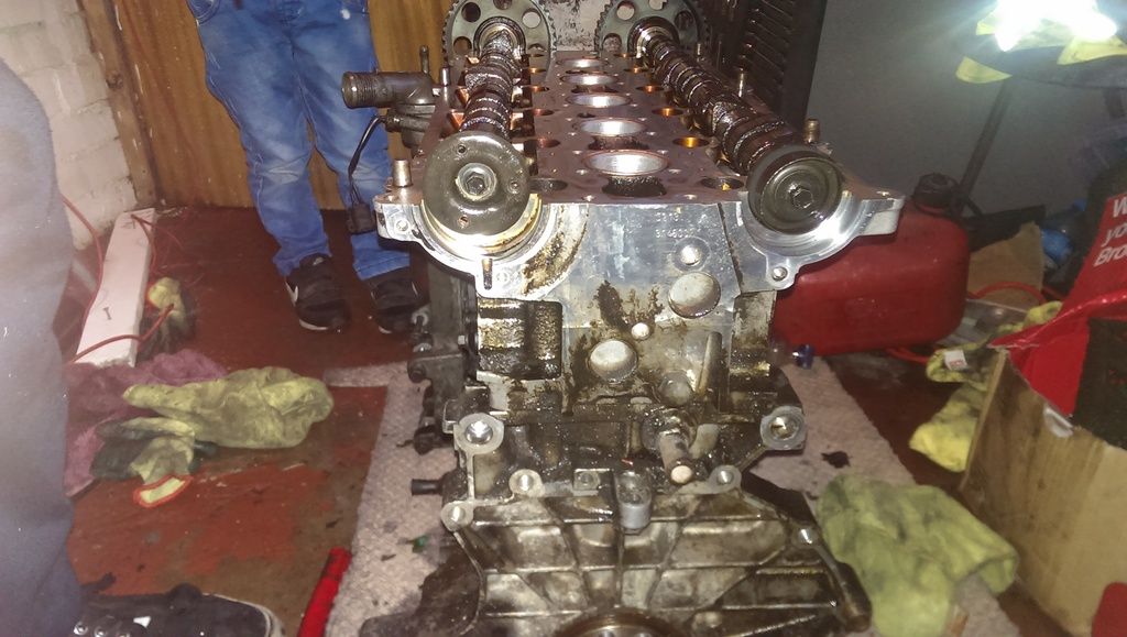

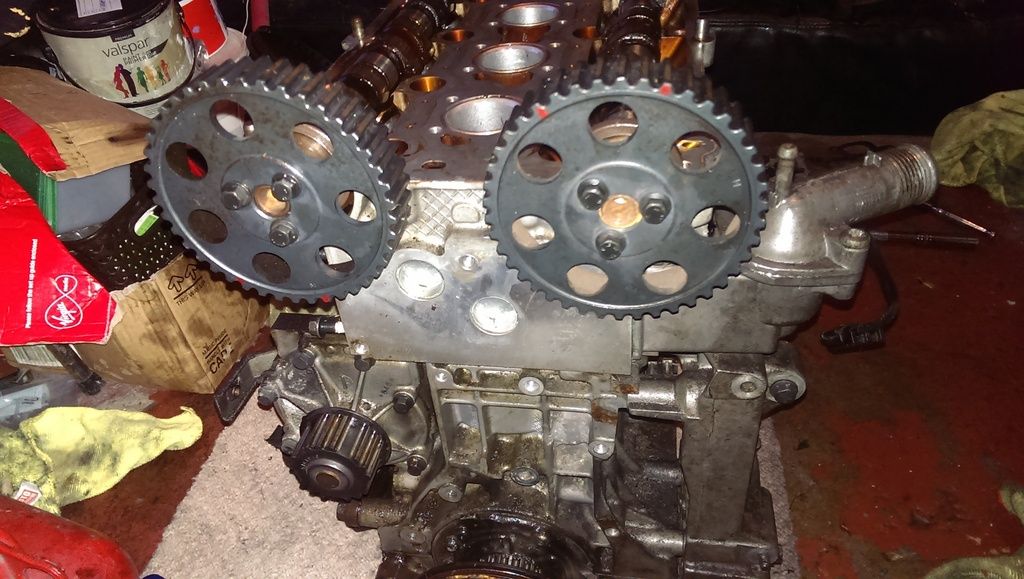

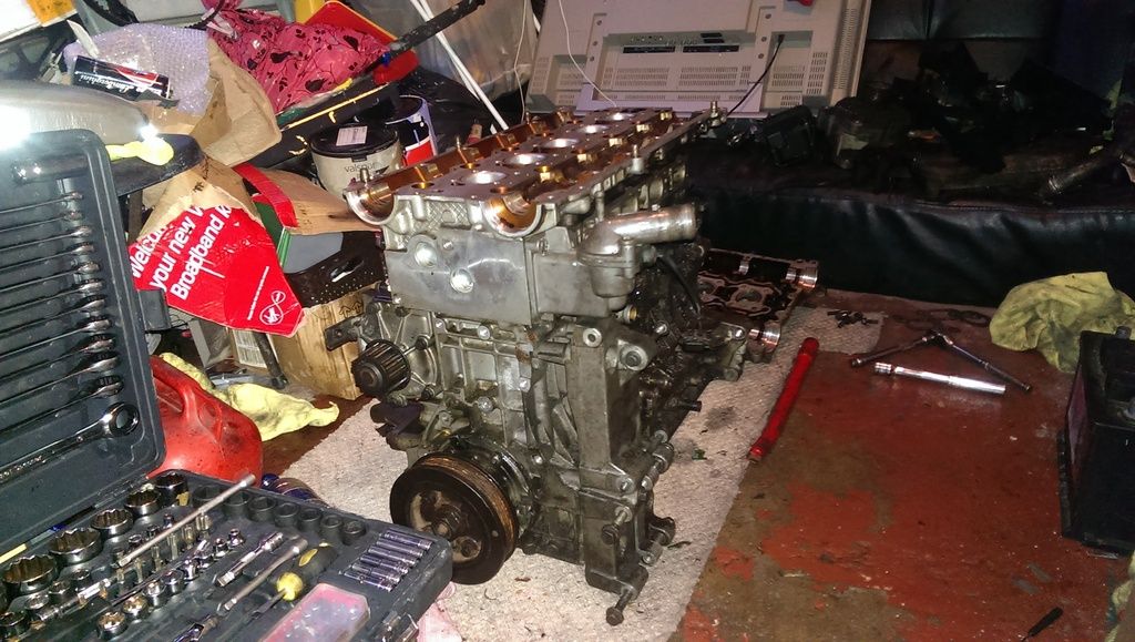

ATM trying to sort out engine, seals, bearing, etc

The rod bearings look pretty grim. How does the crankshaft look?

Agreeing with Lee on the rod bearings. Might as well mic up the crank journals for roundness while you're that far into it. If there's any scoring on the journals, you'll want to have it turned a few thousandths and install oversized bearing inserts.
Notice that the bearing inserts don't have a little rectangular dimple in one upper corner to set into a mating cutout in the rod casting. If you replace the inserts buy a decent quality of inserts that have that dimple, especially if you plan to juice up the power. That little dimple on each half shell will help to resist spinning a bearing at high rpm.

JimBee wrote:Agreeing with Lee on the rod bearings. Might as well mic up the crank journals for roundness while you're that far into it. If there's any scoring on the journals, you'll want to have it turned a few thousandths and install oversized bearing inserts.
Thanks lads, yes i already ordered bearing from volvopartsonline dot com. Will try my best.
