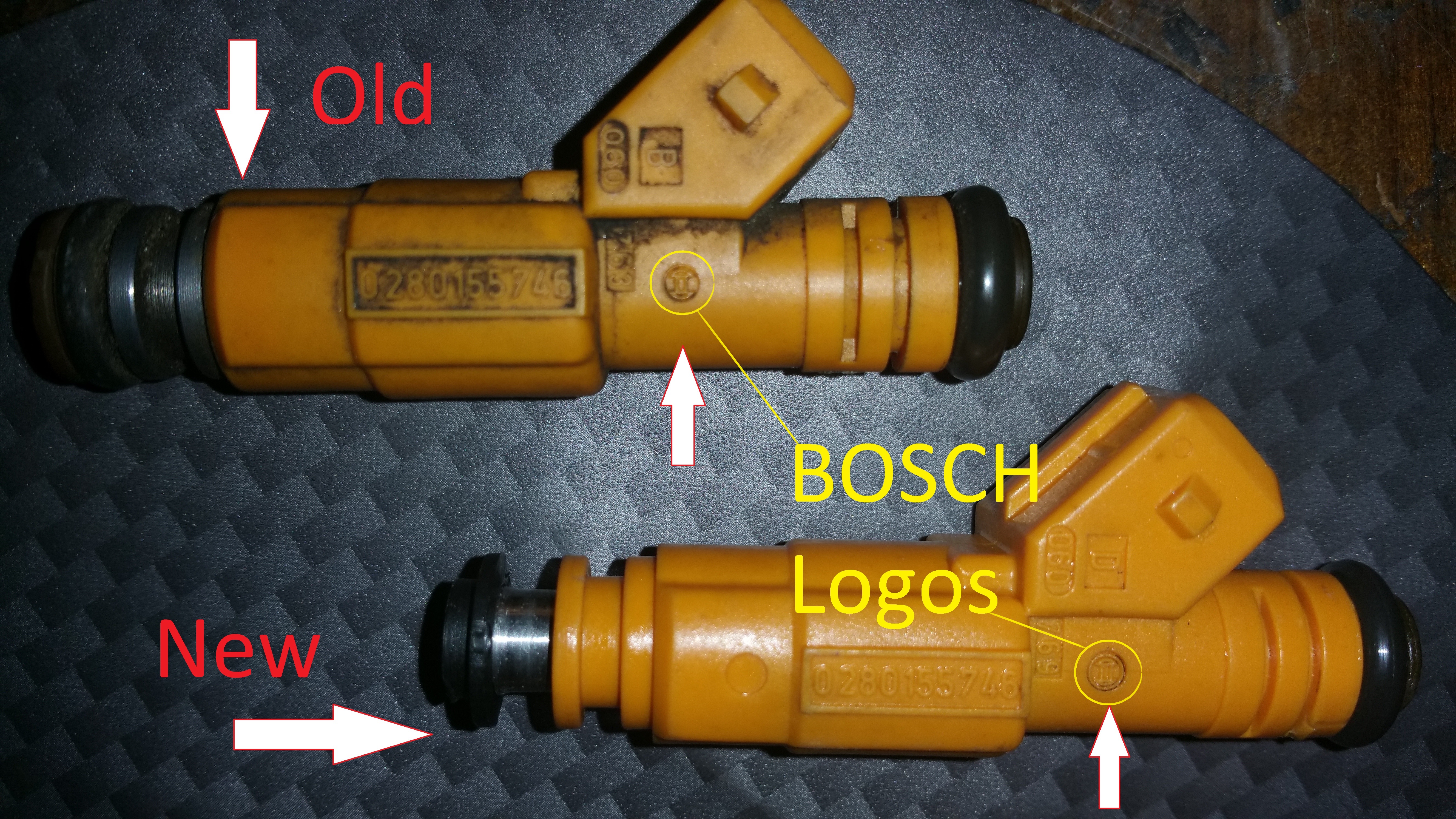

In my last post I said my old injectors didn't have BOSCH logo on them. In reality they did have BOSCH logo on them. I went online and found what an original BOSCH injector looks like and what to look for.
Found some great info on number of websites, but this one was the best https://www.injectorsonline.com.au/blog ... and-pumps/ They also have a lot of other related information on the matter. I also checked all the injectors that I bought and all of them had the logo as well. This actually gives me some hope that my new injectors will work and work better then my old ones. Now all that is left is to finally finish my fix. Thanks again for all the good info and advice.
Found some great info on number of websites, but this one was the best https://www.injectorsonline.com.au/blog ... and-pumps/ They also have a lot of other related information on the matter. I also checked all the injectors that I bought and all of them had the logo as well. This actually gives me some hope that my new injectors will work and work better then my old ones. Now all that is left is to finally finish my fix. Thanks again for all the good info and advice.Currently Driving
