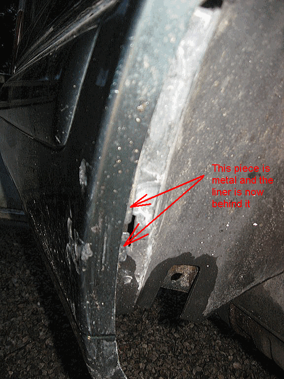

I finally resolved the mudflap mounting problem. It seems that the plastic rear fender liners of my car were incorrectly installed at the factory. This did not prevent them serving their purpose as liners but it prevented the mudflaps from going into their place.
The liners are secured in their place by two self tapping bolts. The edge of the each liner should be behind a steel piece at the lower part of the rear fender but in my car they were in front of it. With the bolts removed, the fender liner could be moved into its correct place, behind the steel piece. With the bolts then replaced, it was a quick and easy job to drill the holes for the two pop rivets and the bolt for mounting the rear mudflap in its place.
