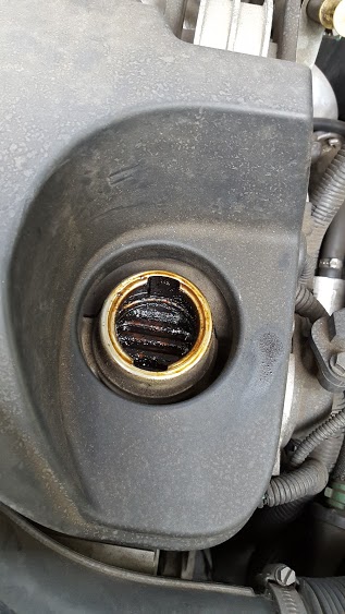

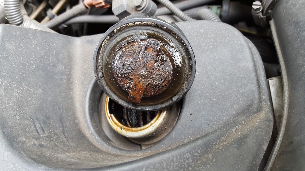

I took a look at a 2004 XC90 T6 this past week. It's got 125k miles and seems to drive pretty well. However, under the hood, I found some interesting things. It looks like the maintenance wasn't done regularly. Just wanted to get a pro's opinion on the topic.
1. power steering fluid low
2. coolant low
3. ATF fluid low
4. engine oil sludge and low oil (see pics). the dip stick also had dried (burned up) oil in the creases/folds of the dip stick.
5. brake maintenance light on
6. ABS light on
7. anti-skid warning on
-- I didn't bring my OBD scanner with me so didn't get a chance to read the codes. I'm assuming there's many more codes aside from what I'd get from the OBD.
With the sludge build up and warning lights, should I simply walk away from the vehicle? Poor maintenance probably = early vehicle failure? Thoughts would be great. Thanks
Help with decision to purchase XC90

Read this Xc90 t6 transmissions fail before buying a T6,

Are they giving this car for free? Personally I would pay not more than $800. This car sounds like one big mechanic special and a lot of free time.
Honestly, walk away.
Sorry.
Sorry.

Nope nope nope.

What are you looking for in this car? How mechanically savvy are you. How broke are you? How broke do you want to be?
If I only knew then what I know now. But...
Are there any maintenance records available? I got lucky, mine had a complete history of dealer and Indie maint until it was traded in.
The ticking time bomb is the transmission. mine died second day I had it, and the warranty company ( named after "the Mother Road") backed out.
That cost me $4k.
Anti-skid light, yaw sensor under the amp under the passenger seat, $500 for a new sensor. Xemodex can rebuild if rebuildable, dunno the cost. result, reduced function of safety systems, basic anti-skid still works, cancels out AWD. Car will run forever that way'
Coolant light, bad reservoir or radiator, common, not really expensive, but a PITA.
Sludge in the motor, can be fixed with seafoam, a couple oil changes, probably some seal reconditioner. Hot, humid weather, short trips, dino oil all lead to sludge.
I've been making lemonade for 3 years this month. This was how I found this website.
If the car can be bought cheap, realistically probably about $2k, and you can do and don't mind work yourself, you can get a safe tank to drive. But if you can find a 2.5t FWD or AWD you might be happier.
