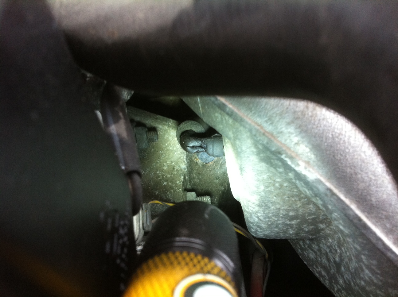

So the PCV Vacuum hose is definitely cracked and looks like it has been for a while. I figured fixing that will clear the P0172 making the car run rich and the oil under the valve cover.
Now I just need to find the coolant leak. Without putting the car on jack stands I took the splash guard off (there was probably a cup of coolant pooled in it) it looked to me like the coolant was sprayed all around behind the radiator. I didn't see any obvious leaks but I'm going to replace all the hoses after the weekend.
I planning to replace the PCV vacuum line, put in the new spark plugs try to start it up. Should I replace/check anything else beyond the hose? I figured I'd look for the coolant leak with the car running since it hasn't lost any while its been sitting.

Recently experienced the cold no-start issue myself. Except down here it's not NEAR as cold as where you are! The ECT was original (now about 17yrs old) and at ~ 50°F, the resistance was only around 550 ohms. Should have been around 3500 Ohms. New ECT fixed it.
I also discovered my T-stat gasket was split, so it was leaking coolant. Bottom of coolant tank had a split...thought it was coming from the lower hose. Fixed that. Still leaking on pass. side though. Removed timing cover and stuck an inspection mirror down there...looks like the bottom of the water pump gasket is leaking when hot. There is no coolant coming from the weep hole. I also have a leak from both upper & lower radiator hoses where they attach to the radiator. The hoses are original, so I'll replace both as well as all others.
Hope this gives you some ideas.
