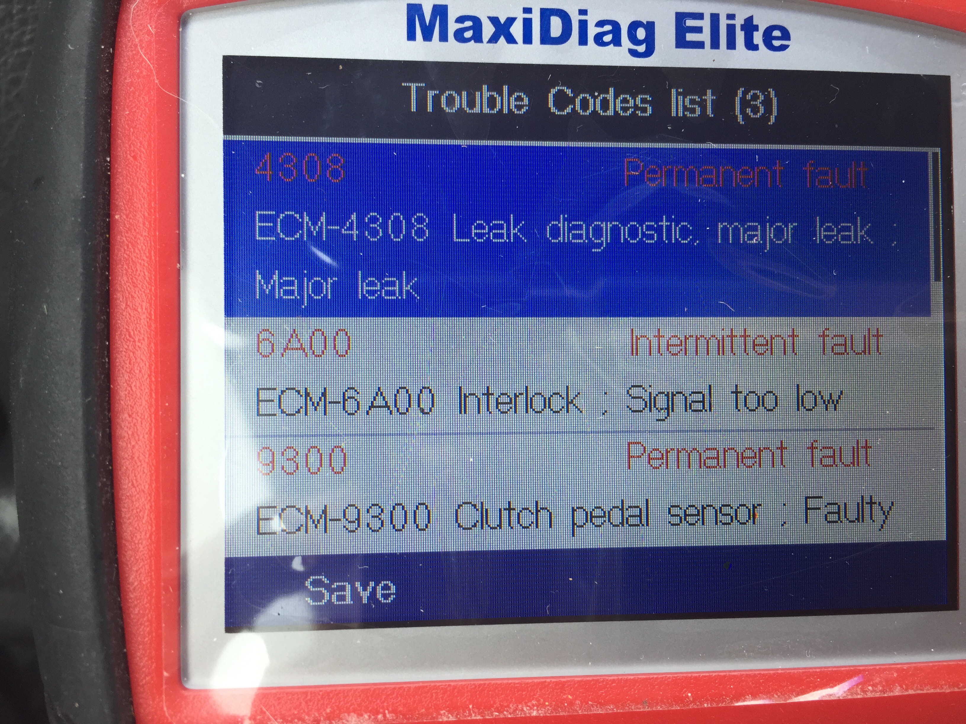

See up thread. Wiring fault in tailgate led to fuse fault on central locking system which inhibits starter on ME7 cars.

After repairing the hinge wiring, all well
Clutch seems to require longer stroke to actuate cranking, probably as result of my cleaning.
I'm calling this one totally on rear hatch wiring, by the way, I think the clutch switch was a red herring.
Hatch wiring short......popped number 6 fuse....inhibits central locking....inhibits starting on ME7.
The clutch switch inputs go into the ECU directly, so I can't troubleshoot that further without some serious schematics
