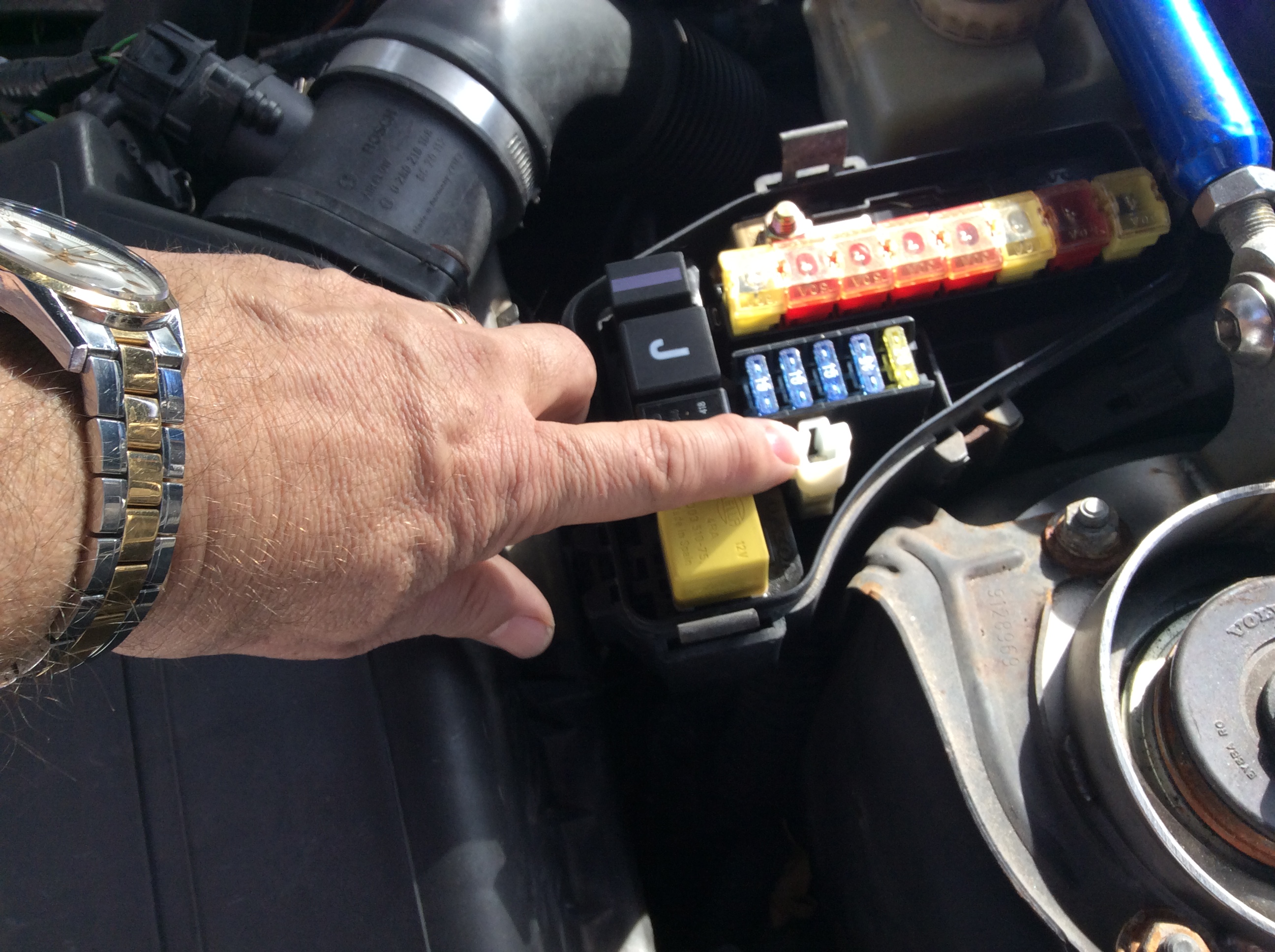

Checking fuses……

I did not notice this last night – Fuse 6, central locking is blown
Replacing it and powering up, fine
Either lock button on driver or passenger side immediately blows fuse.
Im guessing this is causing the no-crank but I thought immob inhibited spark only on ME7?? I will know shortly.

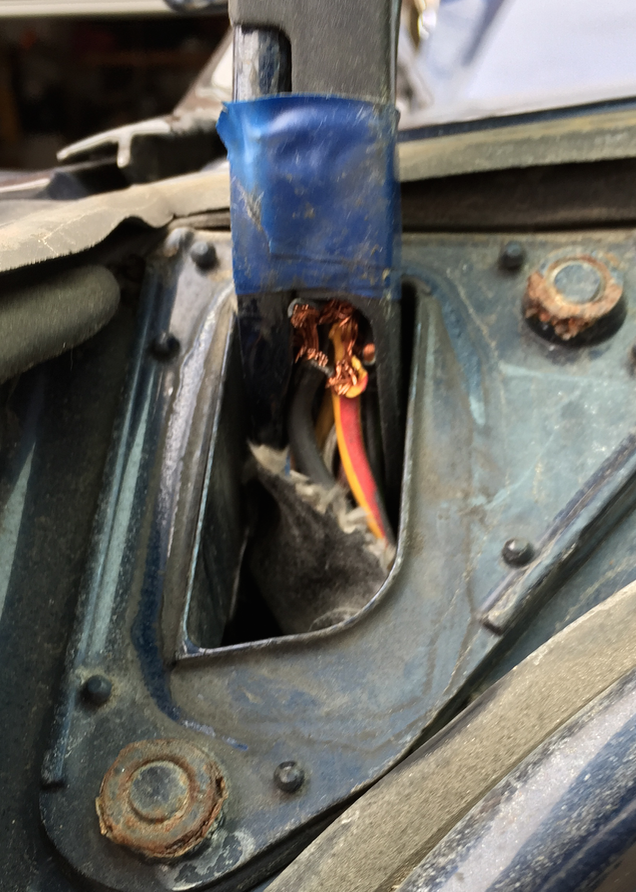

Cup of coffee. What have I been doing for past two days? Lots of tailgate work moving work stuff
Popped the tailgate, my old friend has returned….
and the verdict is:

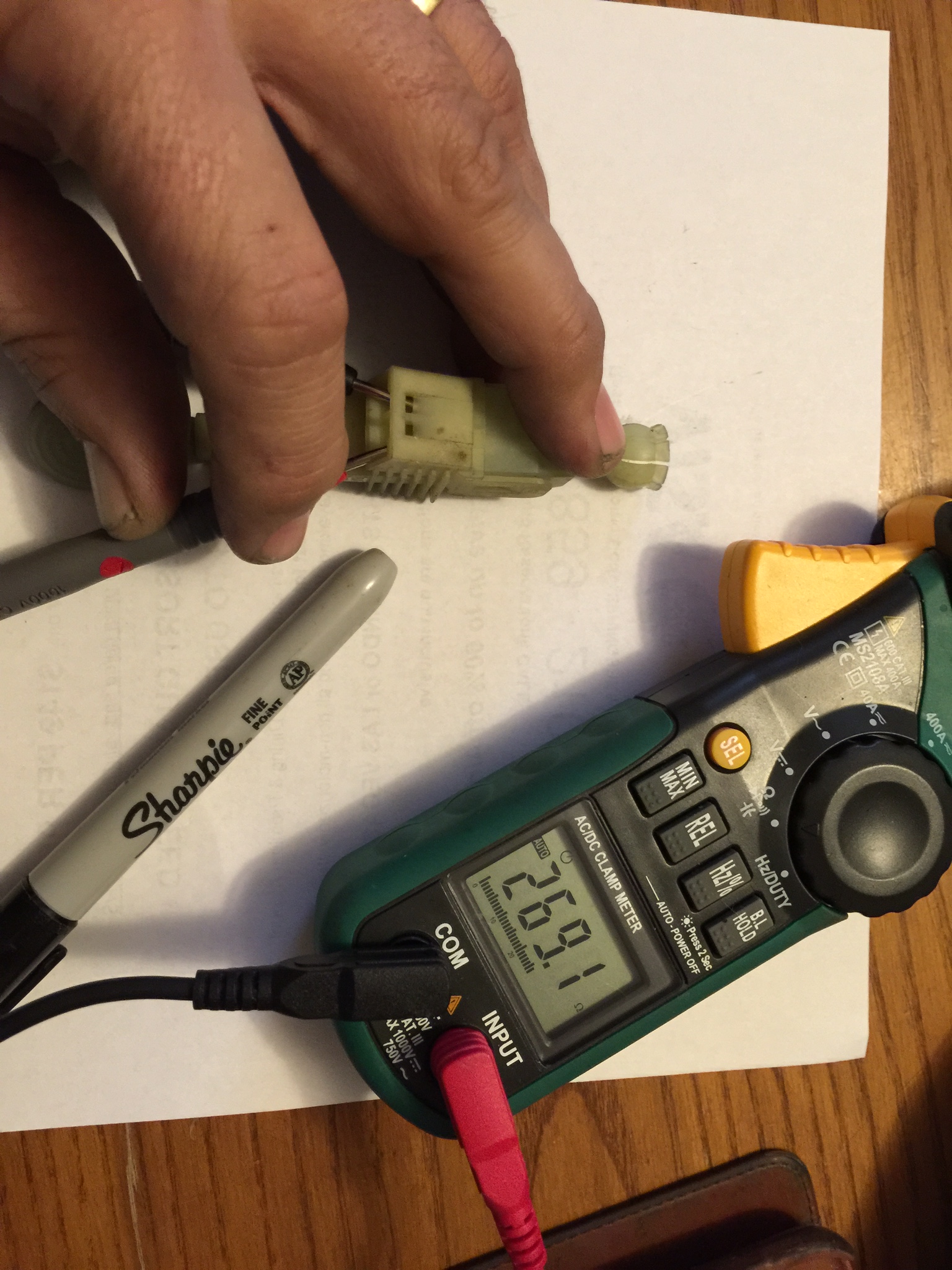

Cleaned clutch switch with some MAF cleaner, cleaned operating shaft with sand paper, dab of silicone spray.
Car cranks and starts with clutch fully down. Removing Fuse 6, central locking inhibits starter cranking – THATS GOOD TO KNOW!
I just have to fix the pillar wiring problem this weekend and Ill be good.Second half of the DENVER win should be a good time to schedule.
Its very possible the clutch switch was still functional and the FUSE 6 caused by pillar wiring fault was the whole issue.
VRD:1999 V70 T5 – Broken Hatch wires lead to no-crank condition, Manual trans
