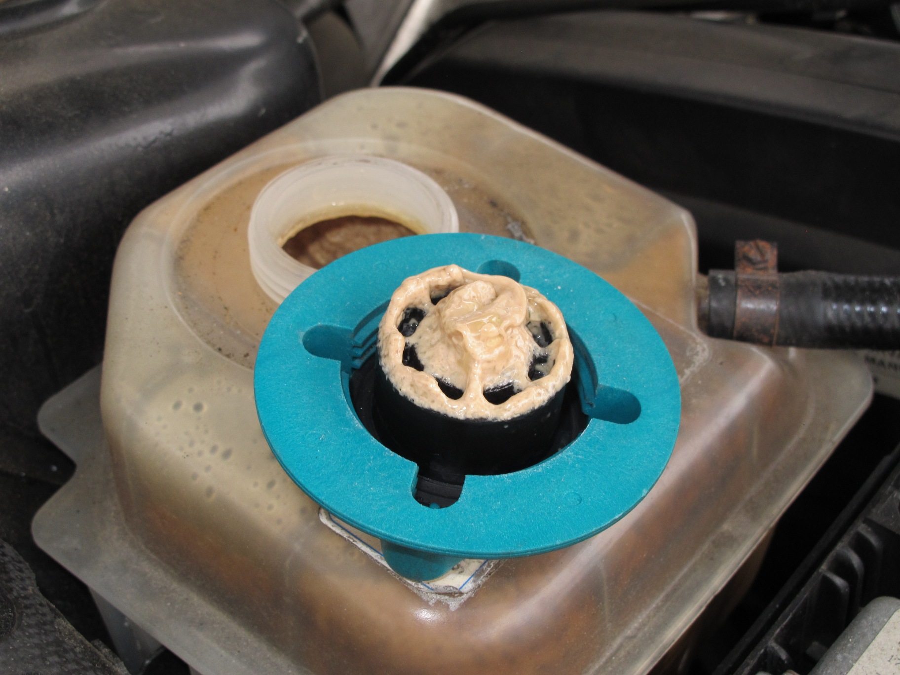

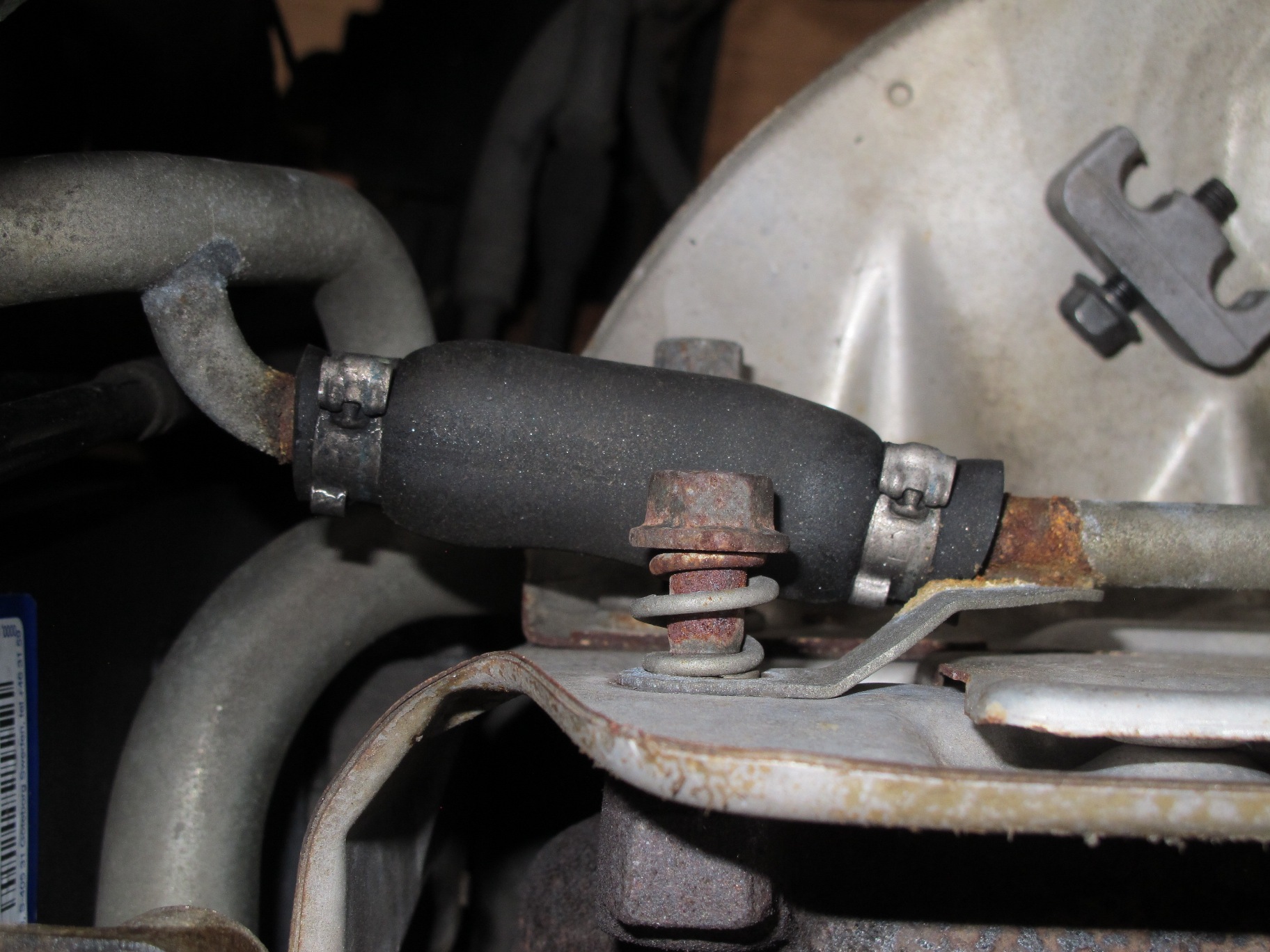

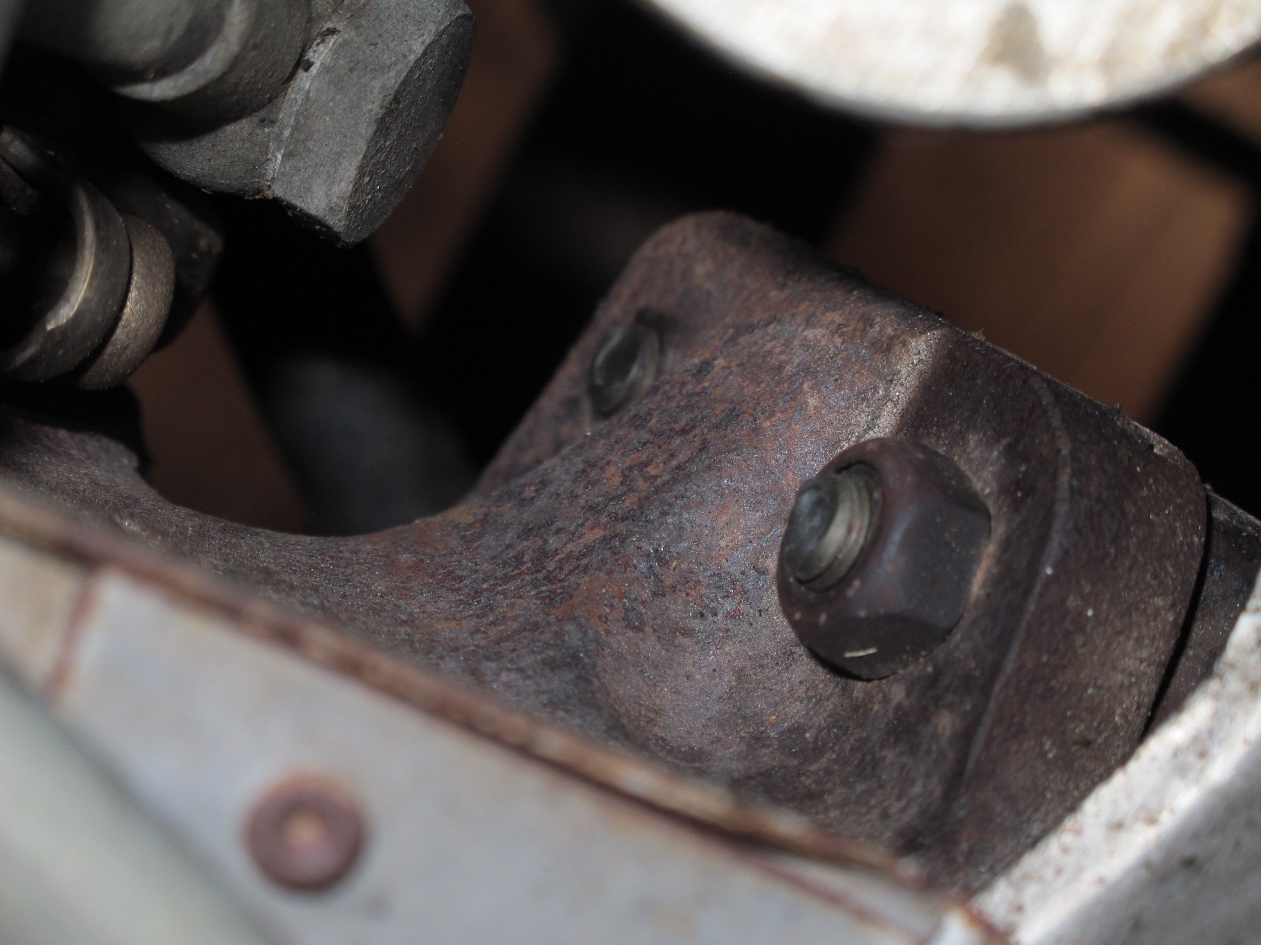

That's making me think I might just tempt it. Looking, I saw this that didn't quite look normal. This is looking down where I think the turbo attaches to the manifold. Looks like the lower stud is broken off?
Then looked at the coolant line on the other side and saw this. Looking like its about to blow.

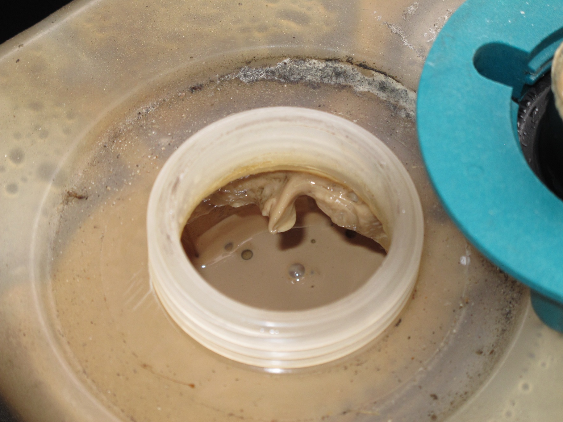

And finally, just as I figured I would inspect some other things in the vicinity, I found this !!
Now I'm not sure what to do.
The oil is clean so the oil is blowing into the cooling system somewhere. My first guess would be the head gasket but I'm not intimate with the cooling system on these things so someone else may be able to tell me different. Turbo possibly?
Maybe time to button it back up and sell though I am honest to a fault and would have to tell a potential buyer what I am aware of. Or I could start parting it out on eBay.

That appears to be a head gasket problem more than a turbo problem

It could also be a radiator problem. The oil coolers have been known to break and leak. Check both the engine oil cooler and the transmission cooler before you go yanking the head.
It is very difficult for the oil and coolant to mix in the turbo since they are actually distinct passages in the housing and there is no seal between them. For the oil and coolant to mix it would have to be due to a cracked housing which I think I have heard of happening once and I'm not so sure that the diagnosis was correct on that one. It is so rare for the turbo housing to crack that it approaches the "never happens" category.

Ugh. I think I would rather pull the head. So ran out and checked the transmission fluid and indeed, it is above the full mark and while not looking like a major coolant contamination, it is a bit cloudy. I had no tranny problems before all this (keeping in mind what started this was moisture in the distributor cap that ended up being a cam seal completely unseated) so big coincidence if I have lucked up (relatively speaking) and found this radiator issue before too much damage was done.
So based on the above video links (Thanks very much by the way, very informative) I am having engine oil intruding into the coolant system and perhaps coolant intruding into the transmission fluid (still inconclusive on that). Is it likely I have both starting to occur at the same time?
So I guess that means a new radiator as I'm sure there is no practical way to repair that kind of damage. And from the very little searching I have done so far, it seems best to go OEM on the radiator.

Figure I am also going to go ahead and pull the turbo as after I took the main heat shield off, it was like, "right there" and I already broke most of the exhaust nuts loose and there is at least one stud broken and maybe two so just thinking it would be prudent to fix all that whether I rebuild the turbo or not.

That could be just ATF fluid in your coolant making that milkshake, but since the fix for both is the same, new radiator, the beauty is you will cover both birds by burying the bushes in stone.
You do want the turbo bolted in well to the exhaust, so get those broken studs fixed. You don't need to rebuild the turbo unless you have obvious symptoms in the bearings or a cracked housing
