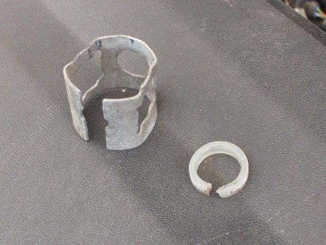

When I pulled the cooling lines from the radiator (engine oil and trans oil) there was a white spacer along with the o-ring on the pipe. At least one of the spacers cracked and I am having a real problem trying to verify which part number this is vs the o-ring. So far I have [Volvo] p/n 6842414 for the white spacer seal and either 6842413 or 968757 for the actual o-ring. Pic of the spacer below with the line clamp beside it for context. Can anyone confirm this?

See my recent posts on oil cooler line replacement as I had mine pop off and all pertinent info regarding C clamp, seals should be in there. FCP website or IPD lists these O rings as well. There is lots of info in the database about these parts. The broken O ring in your pic is the inner one that sits on the oil cooler line, radiator side and the PN is correct. Be sure the C clamp is installed correctly, as it was when removed, and secure with hose clamp as was outlined in my recent post. This link is helpful, but doesn't answer your direct question regarding PN's. http://www.vpcuk.org/forums/showthread. ... oler-lines

When I pulled the cooling lines from the radiator (engine oil and trans oil) there was a white spacer along with the o-ring on the pipe. At least one of the spacers cracked and I am having a real problem trying to verify which part number this is vs the o-ring. So far I have [Volvo] p/n 6842414 for the white spacer seal and either 6842413 or 968757 for the actual o-ring. Pic of the spacer below with the line clamp beside it for context. Can anyone confirm this? ... .

6842413 and 968757 are the same thing, the o-ring.
6842414 is the seal, goes against the rad.
