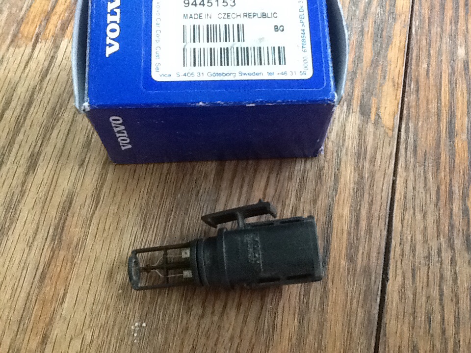

The IAT sensor is on the intake tube leading to the throttle body. It should be part number 9445153. Here is a picture of the IAT. Only use MAF cleaner on your MAF.

Thanks, kahl, for the reply. I have looked up and down the intake tube from throttle body to air cleaner and find nothing. Is the part you show for non-turbo as well as turbo models?

Hi kahl, that part number does not come up on my Vida for non-turbo cars. In fact I am having difficulty find an IAT for a non-turbo. Only sensors I can see are part #9470007 for a pressure sensor which is positioned just to the left of the throttle body. There is another pressure sensor shown, but no location is shown. Part # 6842539.
Sorry, not familuare on non-turbo s/v70's.
