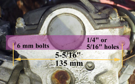

The round rear camshaft seal on my 1992 240 is missing! Any suggestions as to what may have happened to it? Causes? Can I install a new seal without removing the valve cover?

Volvo 240 How to replace rear camshaft seal
Also, one can slip a piece of metal over rear of seal, and bolt down.
