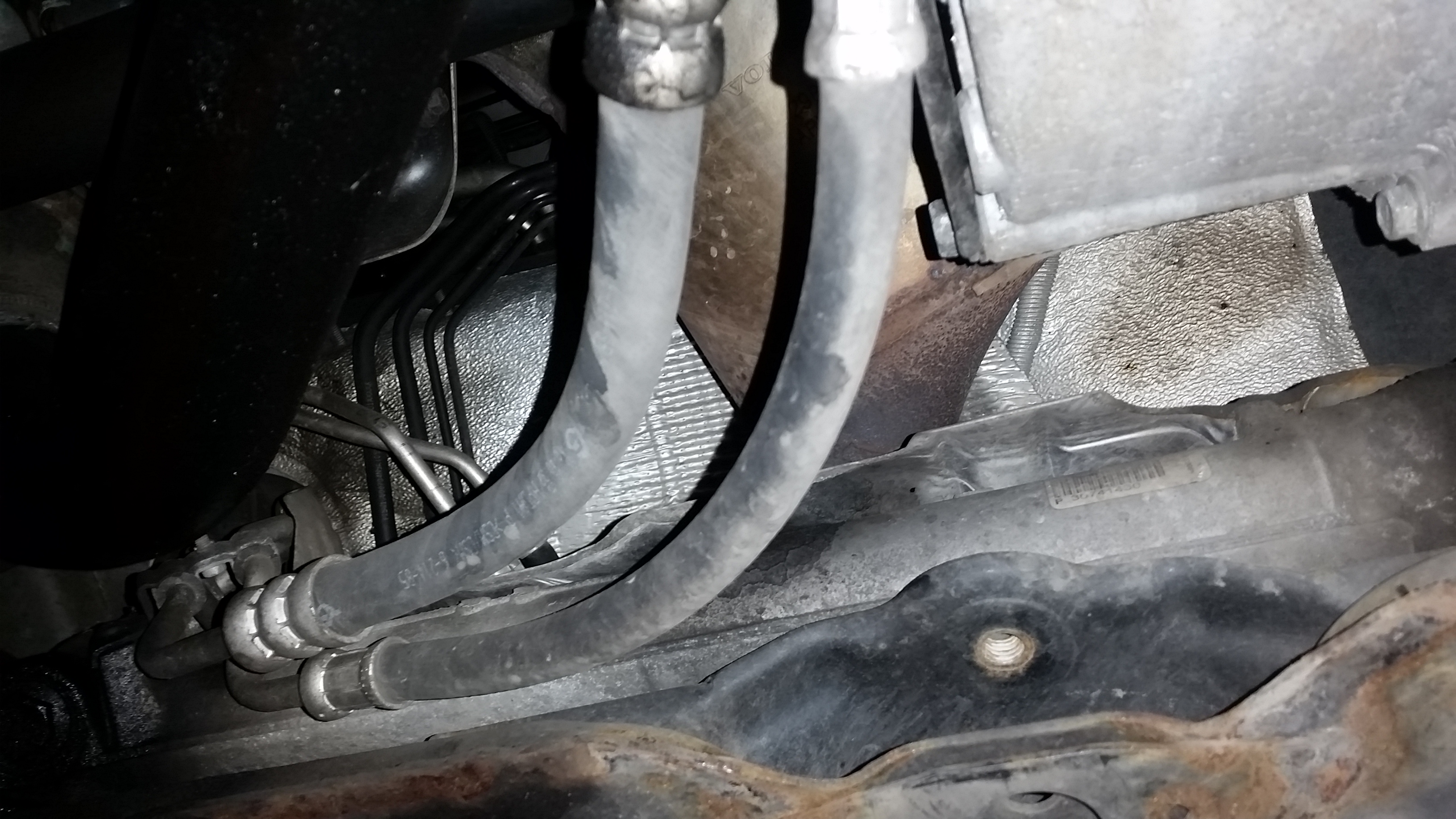

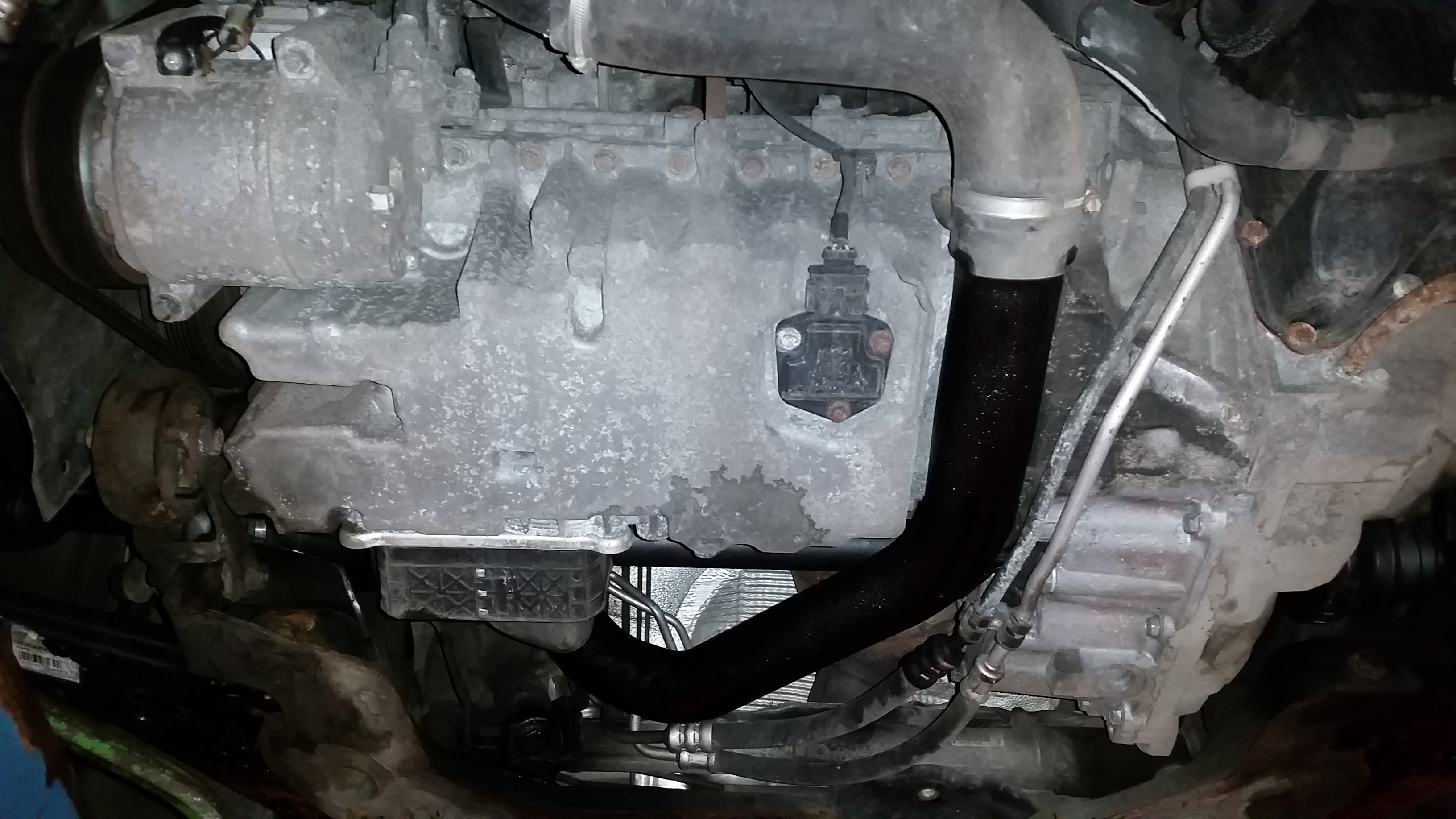

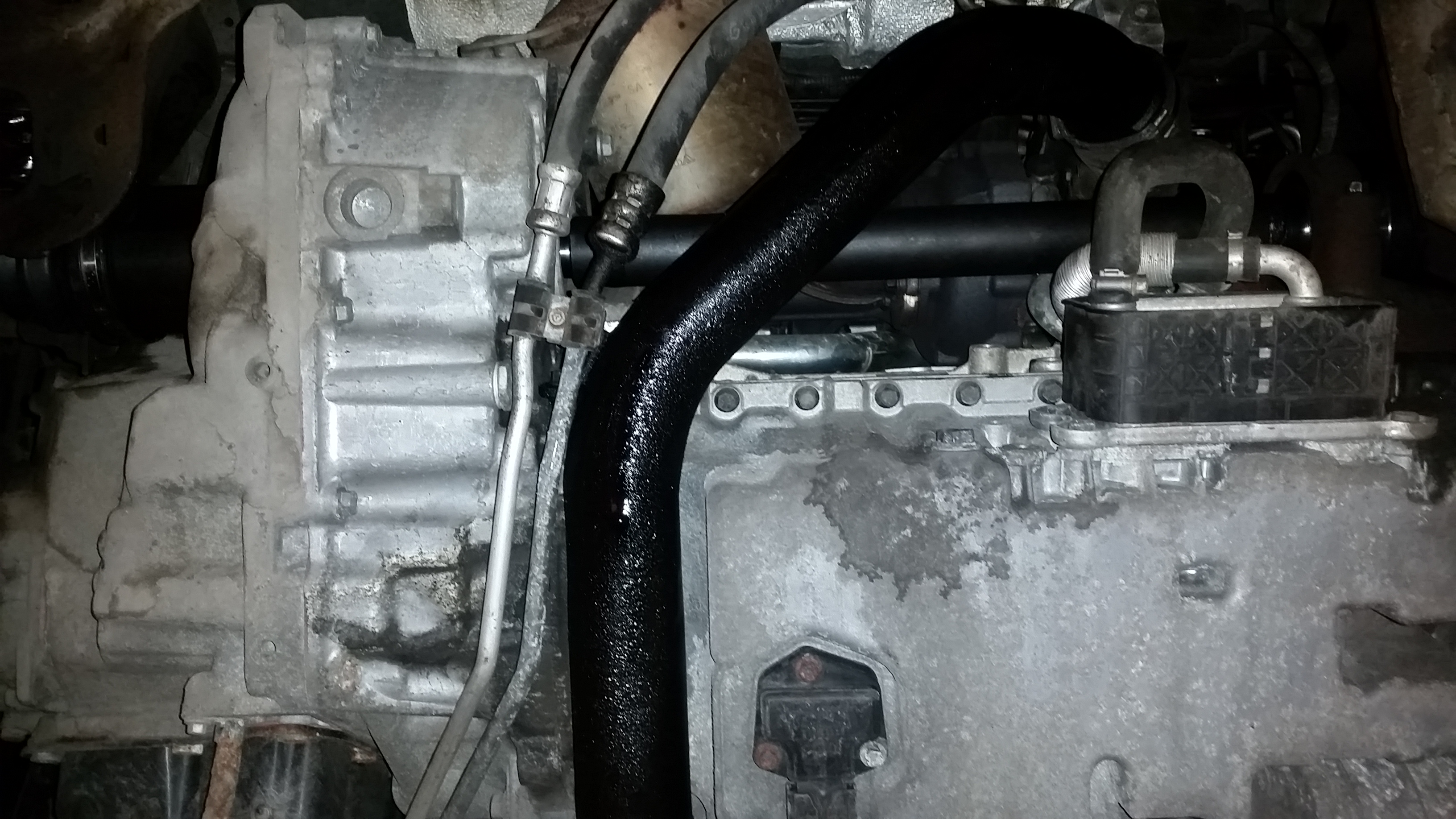

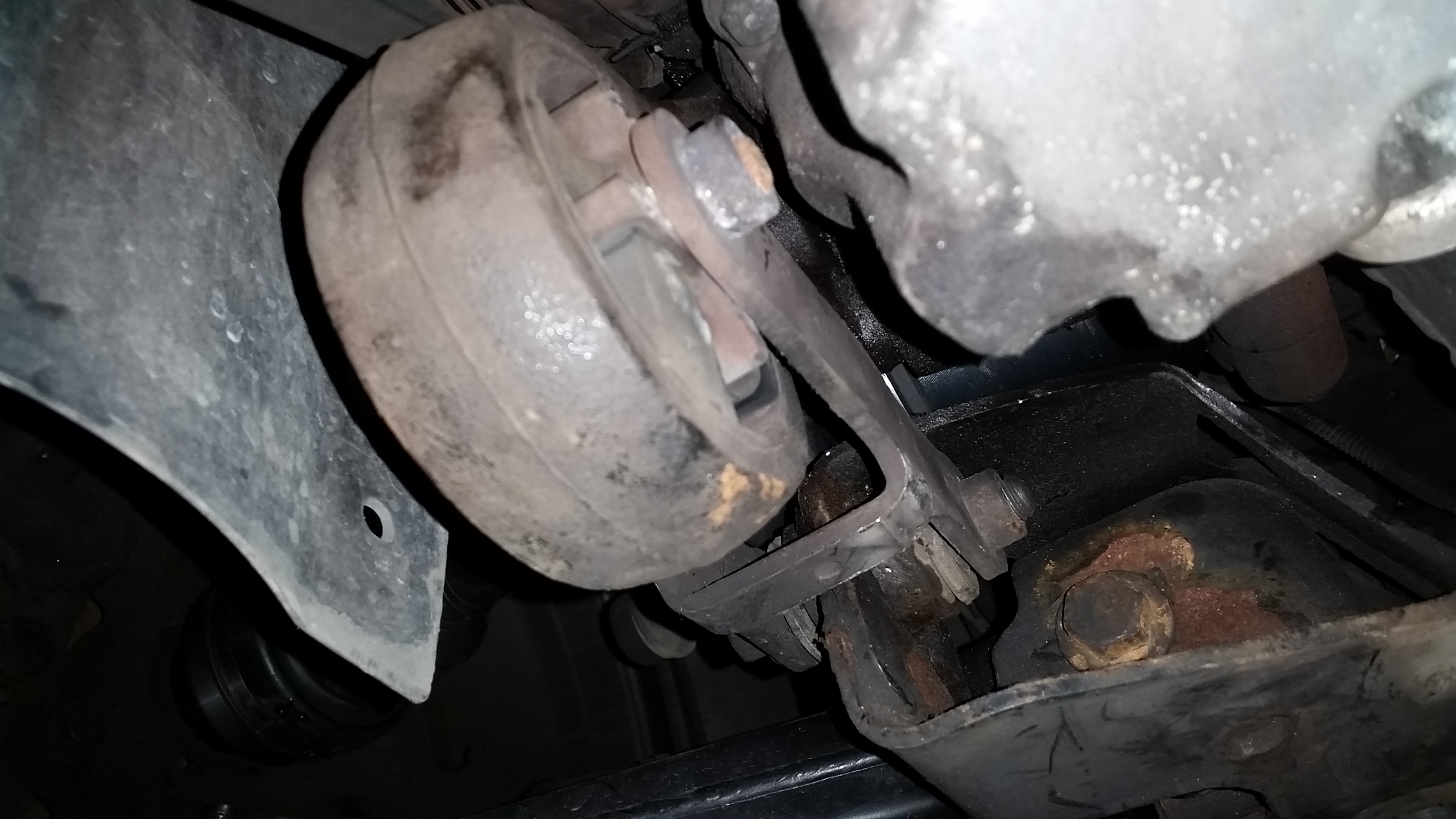

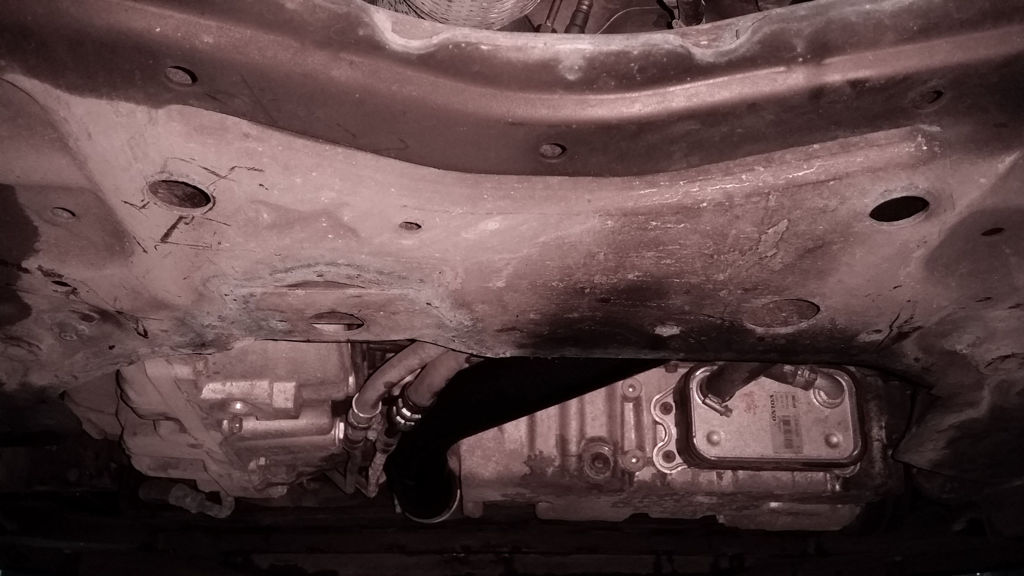

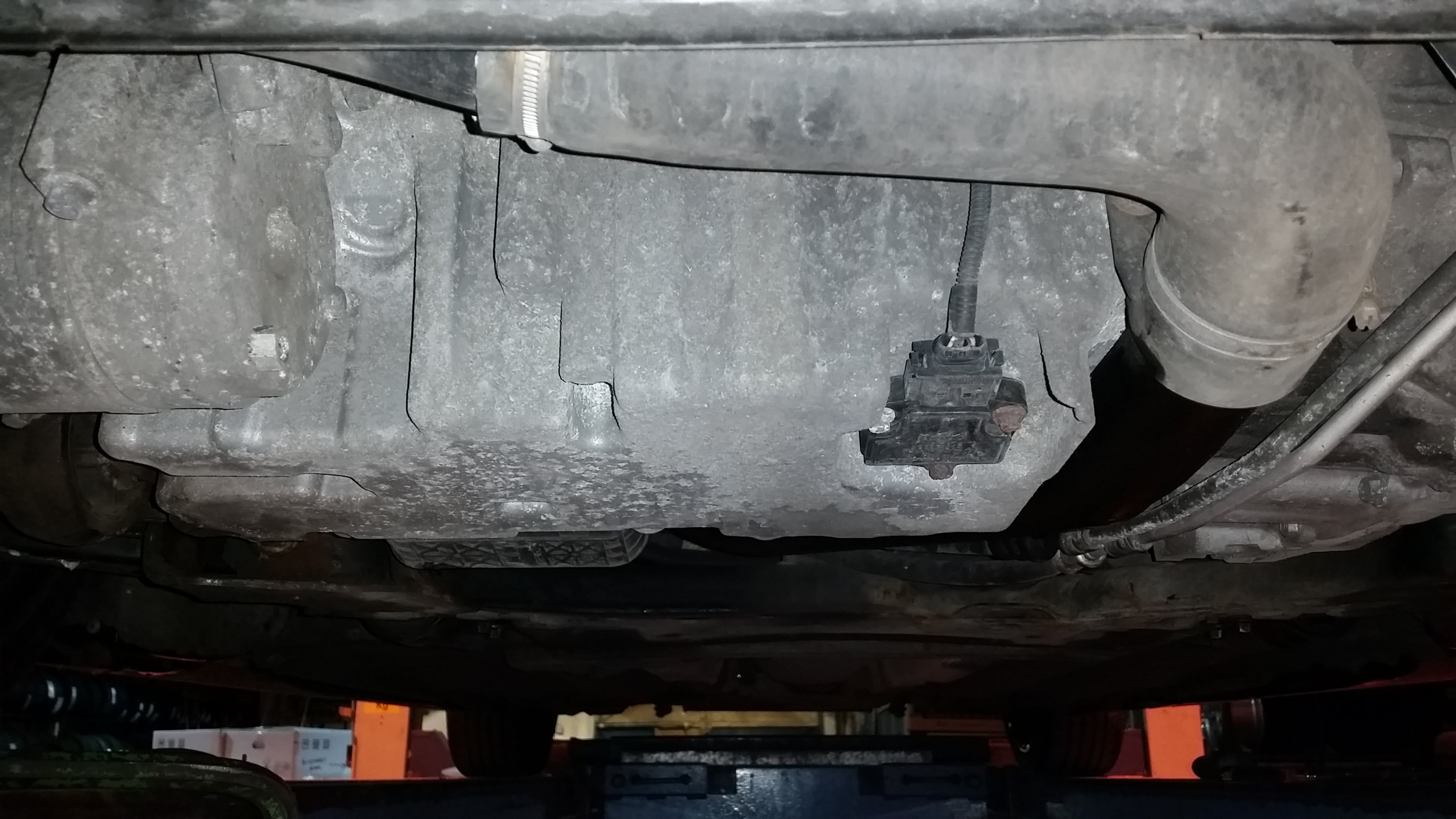

Just a follow up
I've had the car on a ramp and I can't see the large lower torque mount many of you are upgrading.
My car is a D5 Auto and the only lower mount I see is on the left hand side looking at the car from the front?
Is this right? Seems like a small mount for such a big engine.
I've also noticed the wobble is there right up to 40mph and gets faster with speed but less intense.
I've added a few photos under the car in case anyone can shed some more light on it as to where I should be looking.
Thanks very much

Post by MadeInJapan »
Very odd- it's as if I can almost see the place for that lower mount to go but it's not there...is the hole on the left (last picture) appear to bolt up to more than that piece- like a subframe above it? If so, maybe someone took that mount off and didn't replace it? Now, that beefy mount you have under the car- I've never seen anything like it but then again, yours is a D5- something we don't see here in the U.S., I don't believe.
