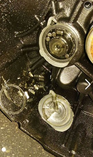

I post it here for future readers. So finding the gearbox was a nightmere, but i managed to do it. Here is picture of a old gearbox. :D
430 000km and was counting... :(

So i managed to find the right gearbox and send it to the shop.
Gearbox 100EUR
Transportation 100EUR
Replacement 400EUR
But now its like a new car :)
Problem was bearings, they just flew away, i got lucky that i didnt damadged enythin else :)
